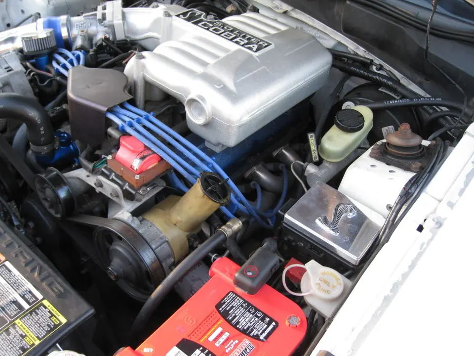

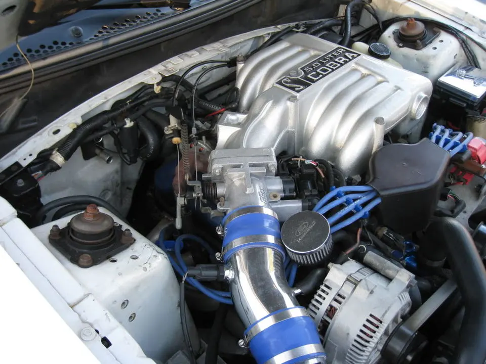

Well after years of wanting to this, I finally got around to taking the AC out. I've had the compressor bypassed for about 2 years, but I just needed to have the AC discharged. So, I did the smog stuff awhile ago, followed by the oil cooler, and now the AC. So much cleaner now!! What do ya think??

Looks good man. That was one of the first things I did to my car. Haven't even really missed it. There was about a month in the summer where I wouldn't have minded having it, but it was nothing unbearable. Now get rid of that nasty looking EGR.

It wasn't too bad, the ac lines are the easiest, make sure you have the spring coupling tools. The compressor takes some time since there wasn't much room to remove the 2 top bolts, of course it could of been a little quicker if I took the battery tray out. Condensor took about 20 min, you have to remove the fan + shroud, unbolt the radiator and move it a little forward to get it outta there. Finally, I can see my fluidyne from the front of the car, it looks good!!
