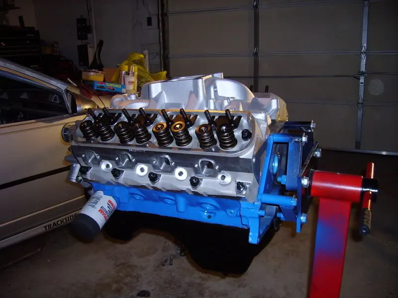

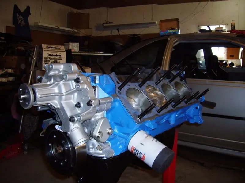

thread sealer! this is what we used on this motor that we built.
no leaks so far.
