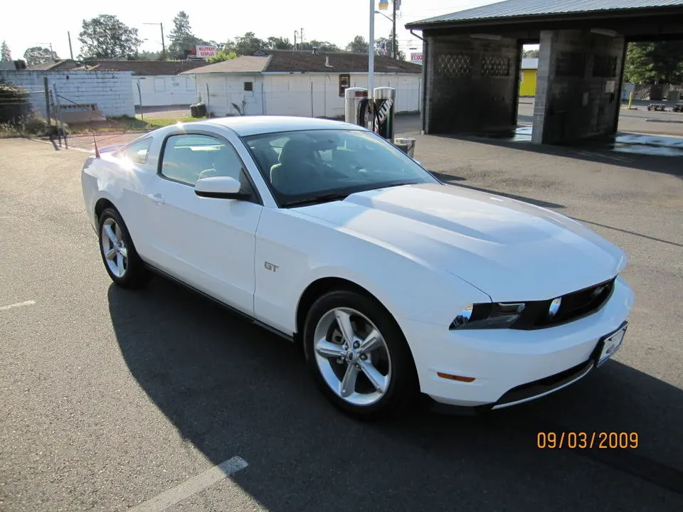

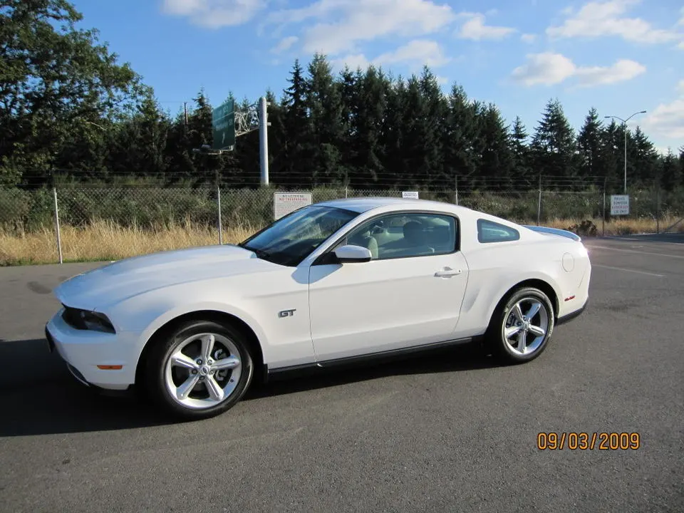

Ok so here are the pics, hopefully this works!

Nice looking Stang! LOVE those new body styles!

These cars do have that ungainly, up-on-tiptoes look.
