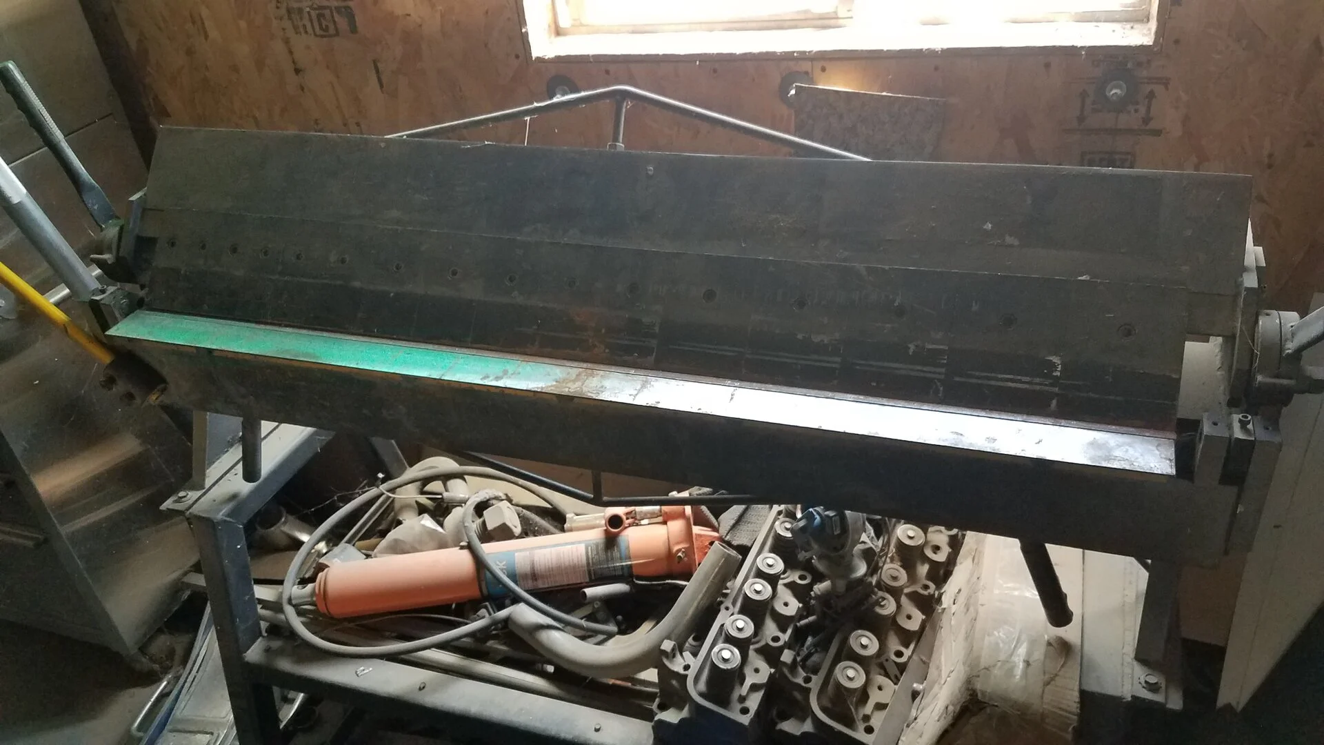

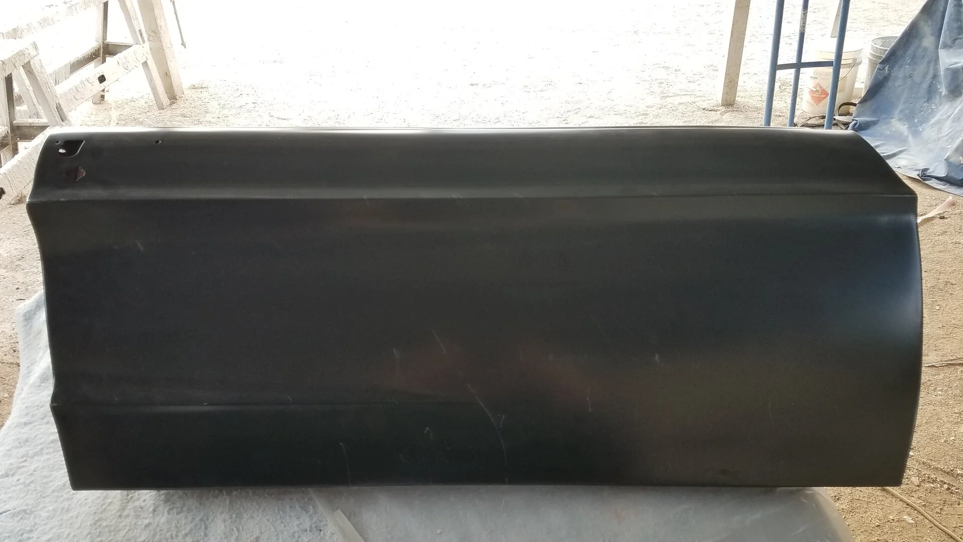

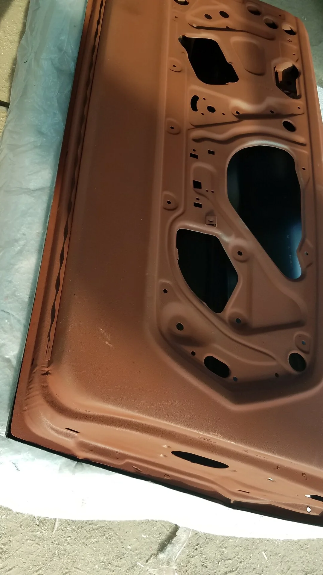

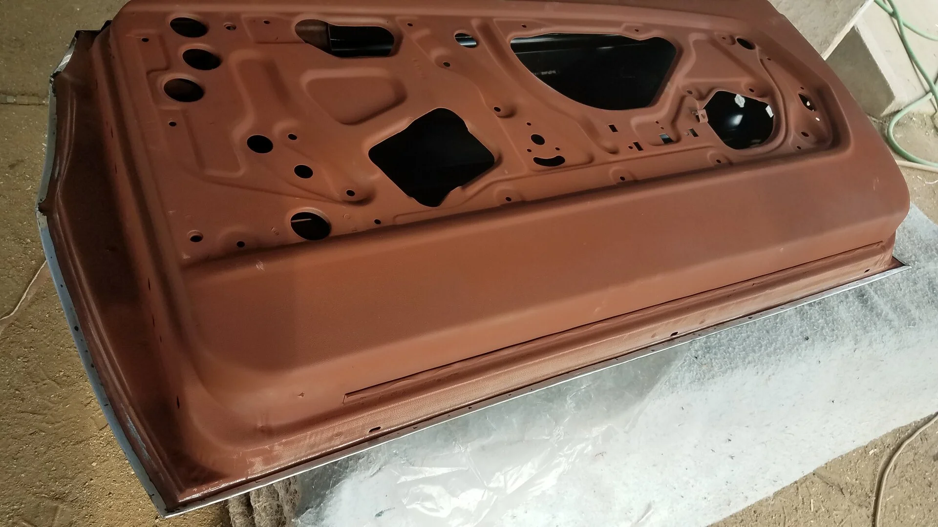

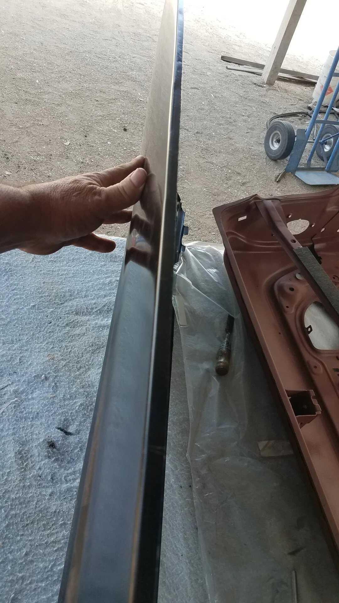

The fold over lip at the bottom of the door skin only had a slight starter bend to it so i put it in my sheet metal break and bent it a bit more ,that also straightened the bottom of the skin that was kind of up and down .

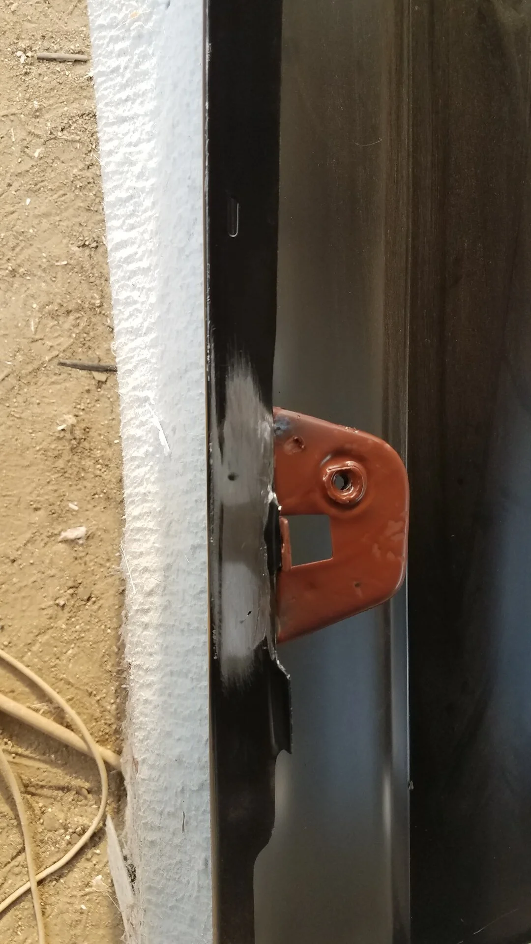

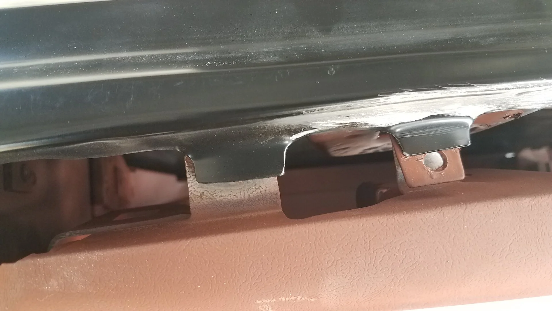

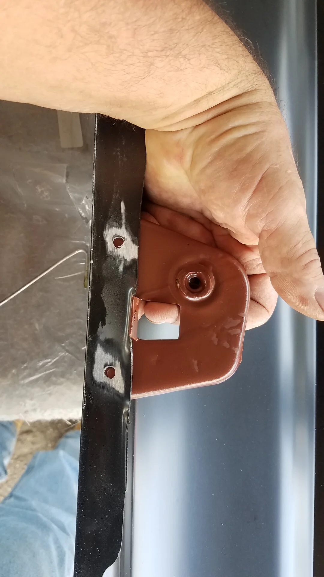

There is one more bracket i need from the old skin ,it is the bracket for wind wing that i will weld in before the skin is in place ,dont forget that bracket !

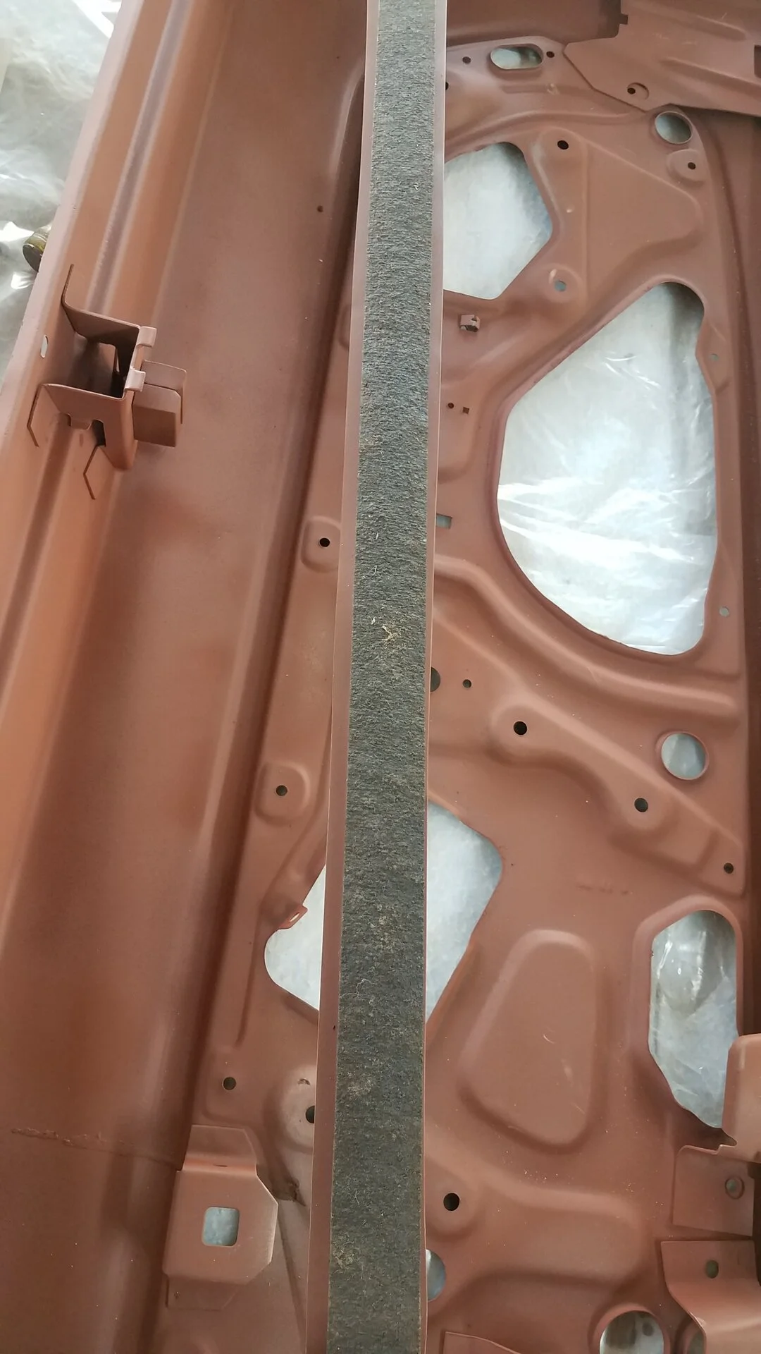

there os a strip of tar paper on the inner bar of the door shell ,it keeps the outer skin stiff and keeps vibration out ,i replaced that .
i should be skinning it in the morning

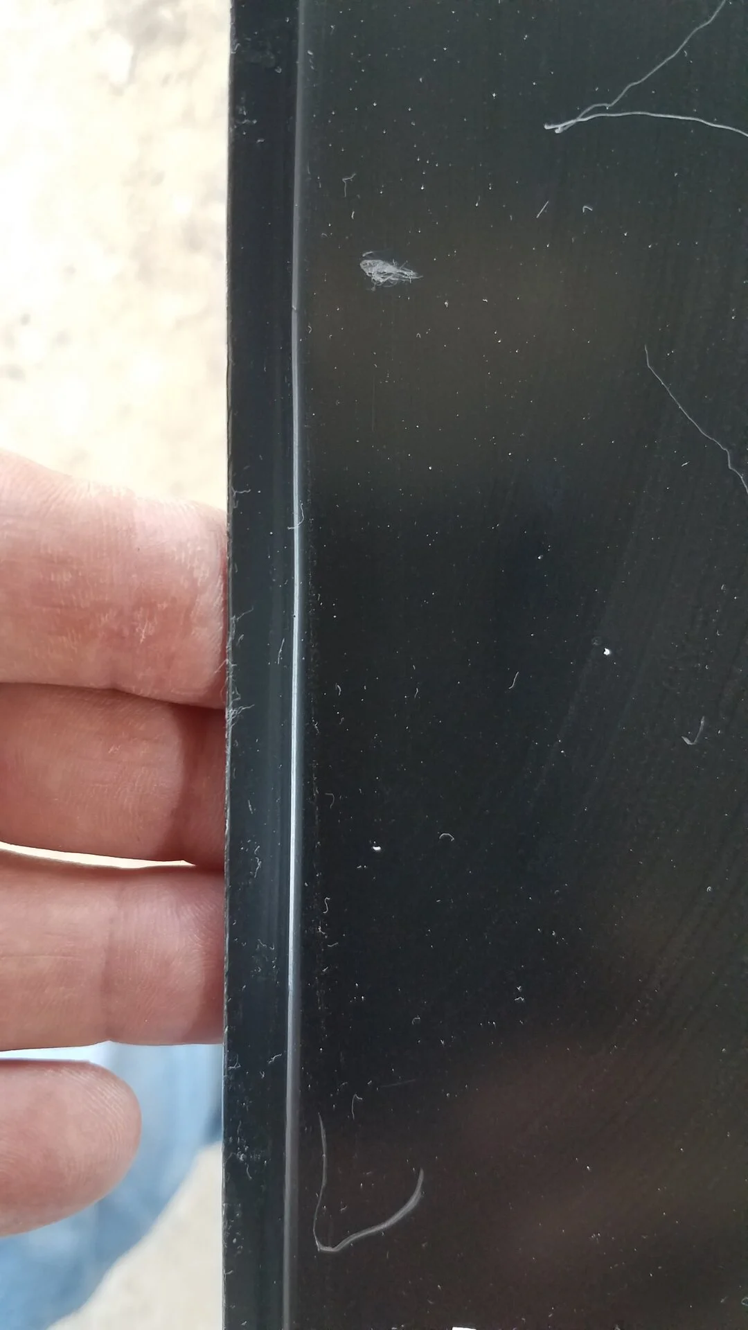

Other than a very lite ding from shipping ,no dents no dings no errors . I still have to tack weld and weld the tabs where the wind wing goes and this door will be finished .
I do not drill my plug weld holes until after the lip is folded over ,the holes first allow the metal to distort the metal along the door skin edge

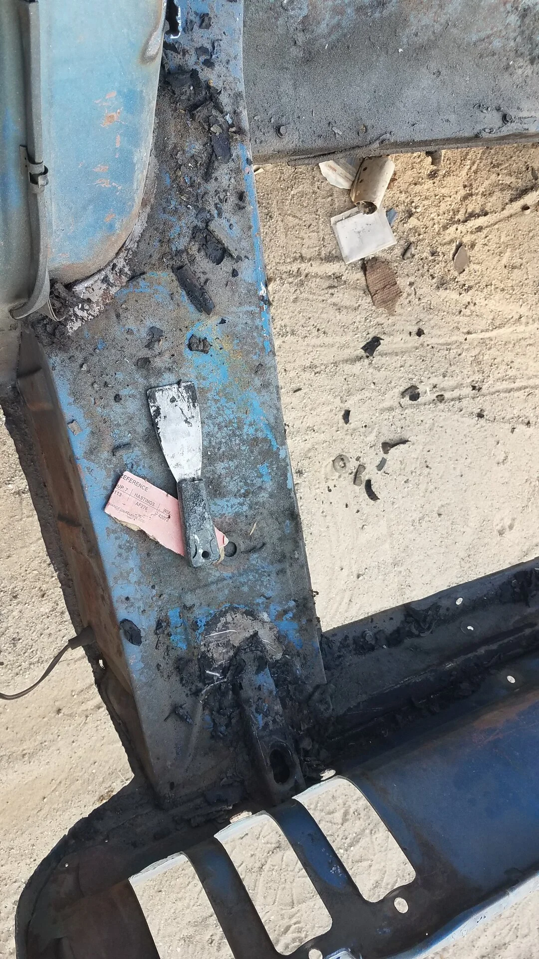

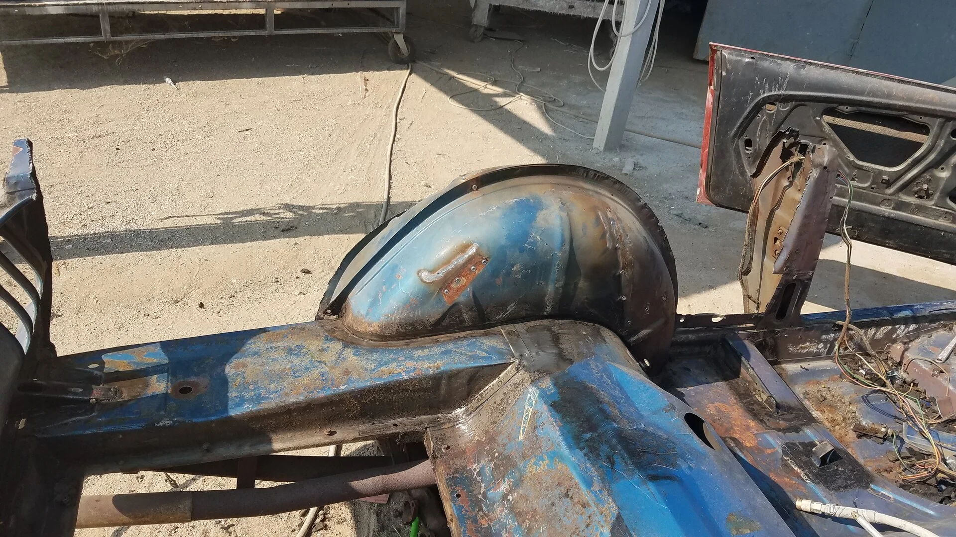

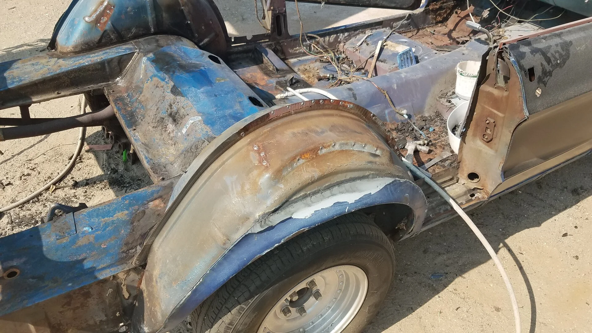

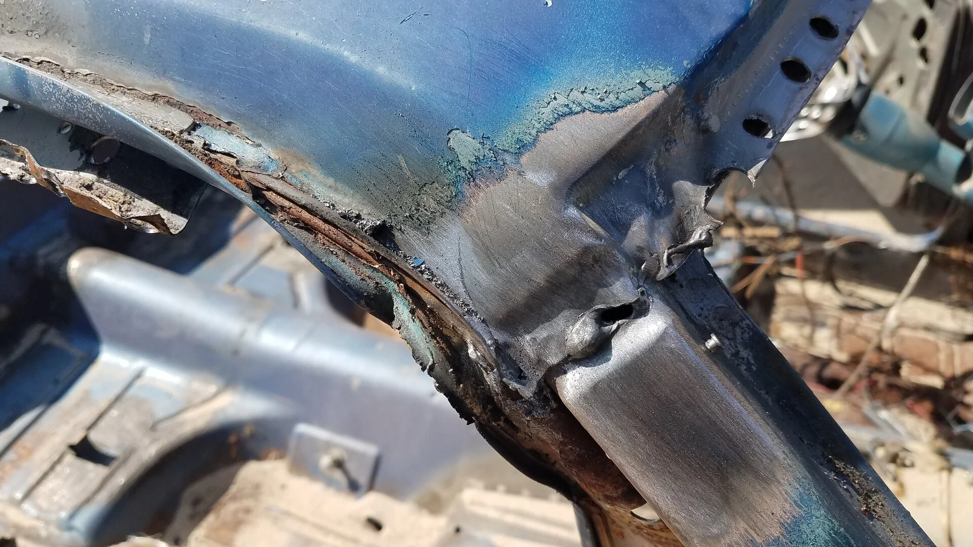

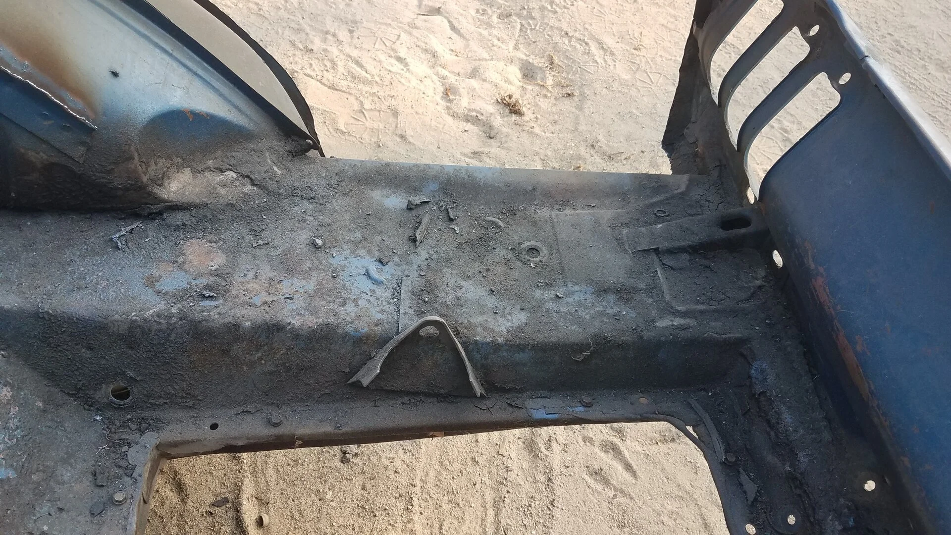

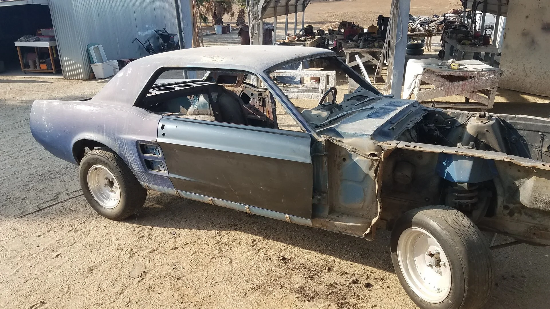

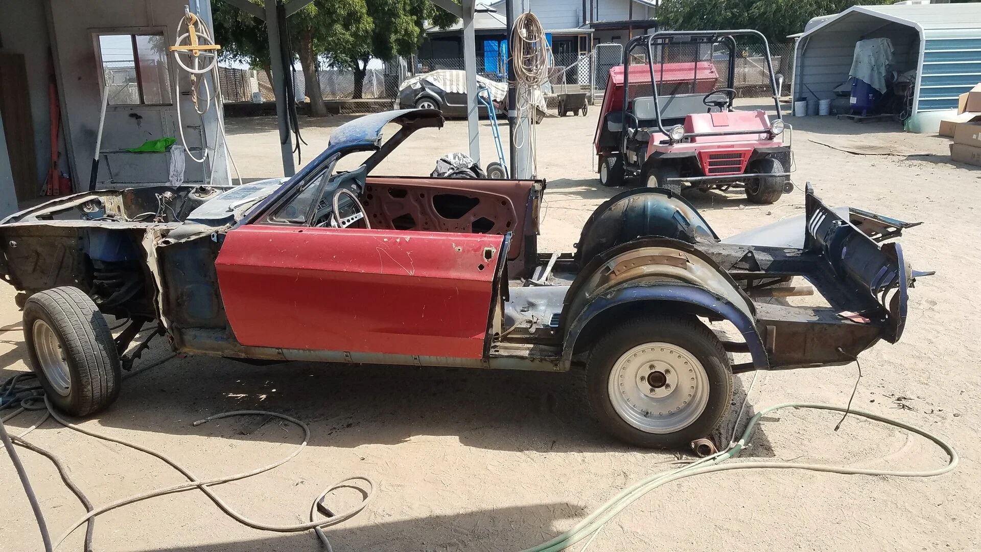

The roof and quarters are off ,the plasma cutter was quieter but the saws all is quicker and cleaner . Need to finnish trim then sand blast the back end and we are ready to level it up
Melting things to cut might keep the neighbors happier, but did touching it up with a grinder take a lot more time? (It’s not as clean as a light saber.) And was the noise from that about as bad as the saw?
What kind & brand of blades were you happiest with using in the reciprocal saw?
I use the Milwaukee blades for cutting metal ,one blade can do a couple of cars but beat the crap out of you .
Plasma cutter worked great but its a lot slower getting through all the layers

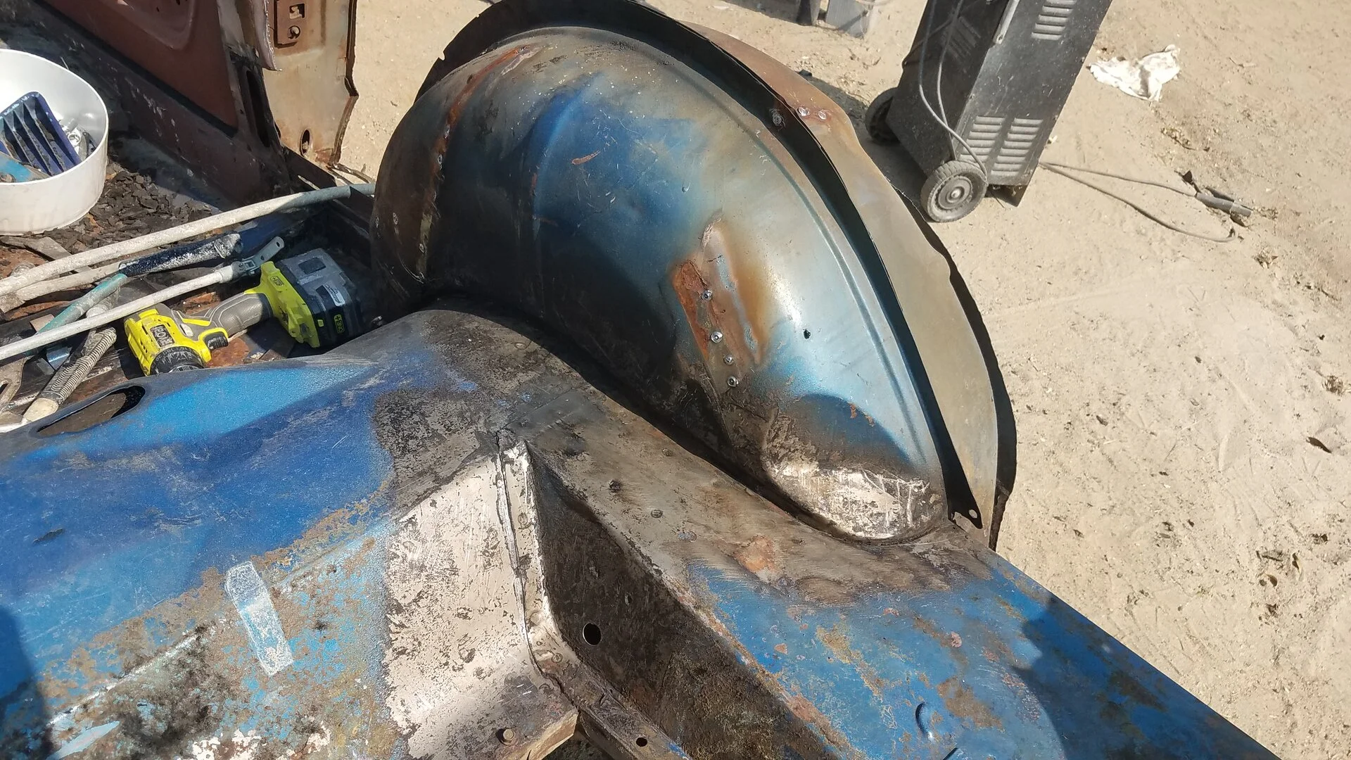

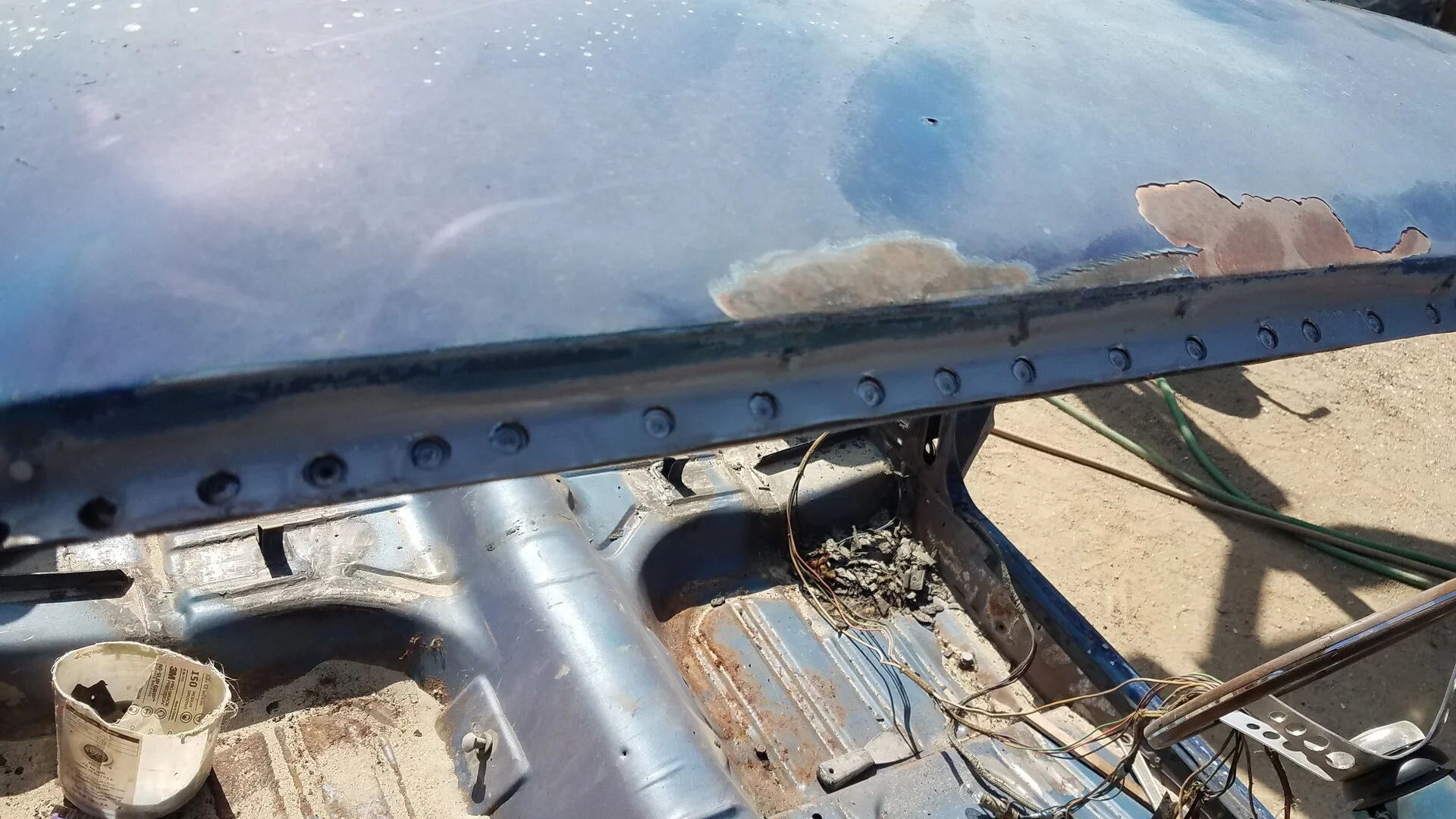

The front of the roof is drilled and broke loose ,i melted out the led and once i cut a couple of welds it will be removed . I should have it mostly trimmed today and the door frames built ...if no one takes out any more of my fencing !
