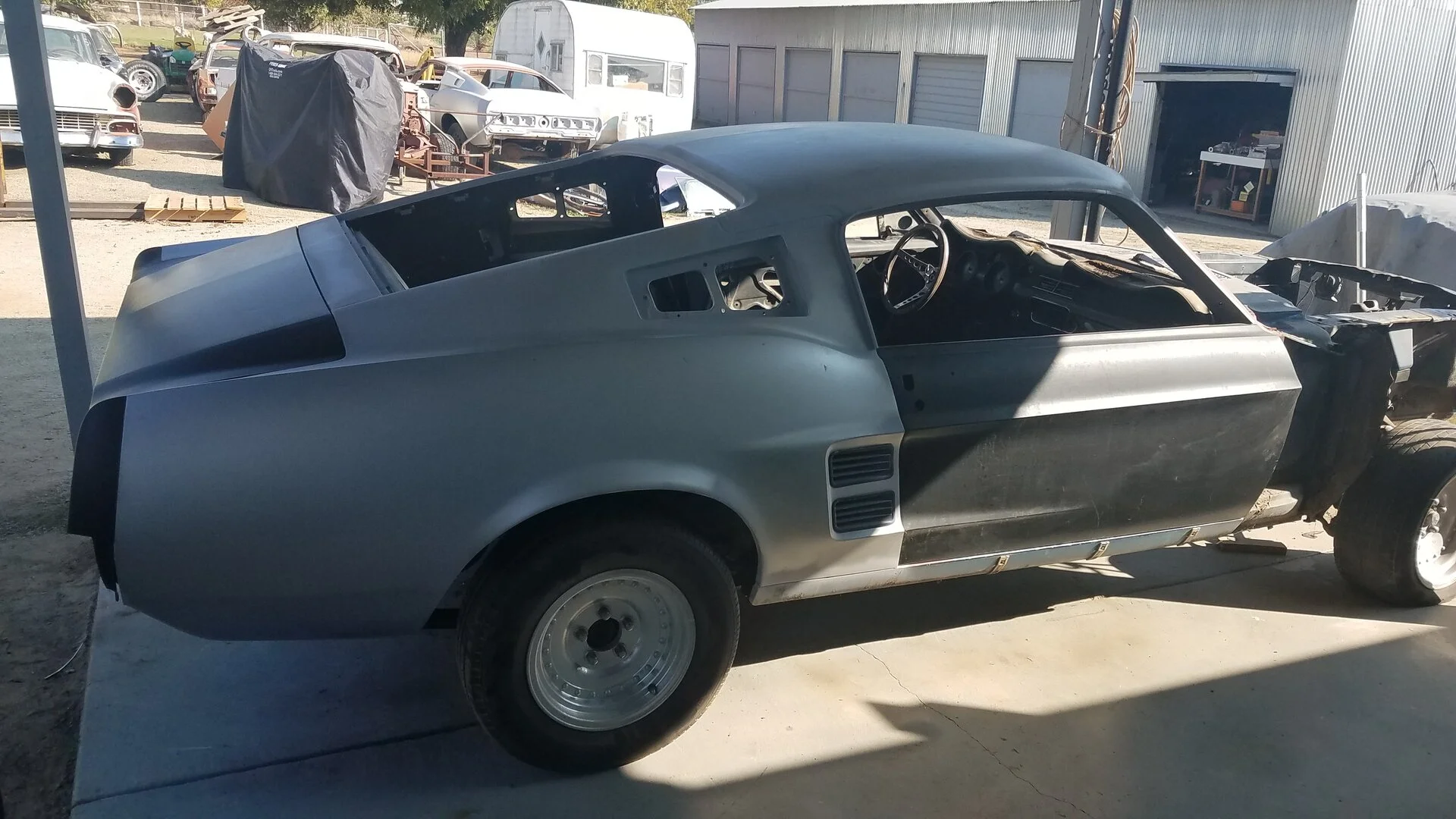

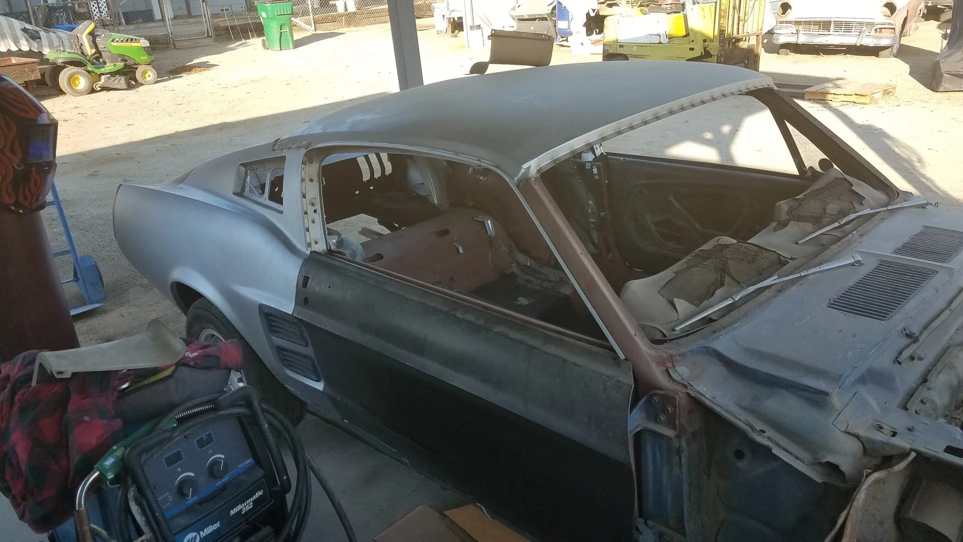

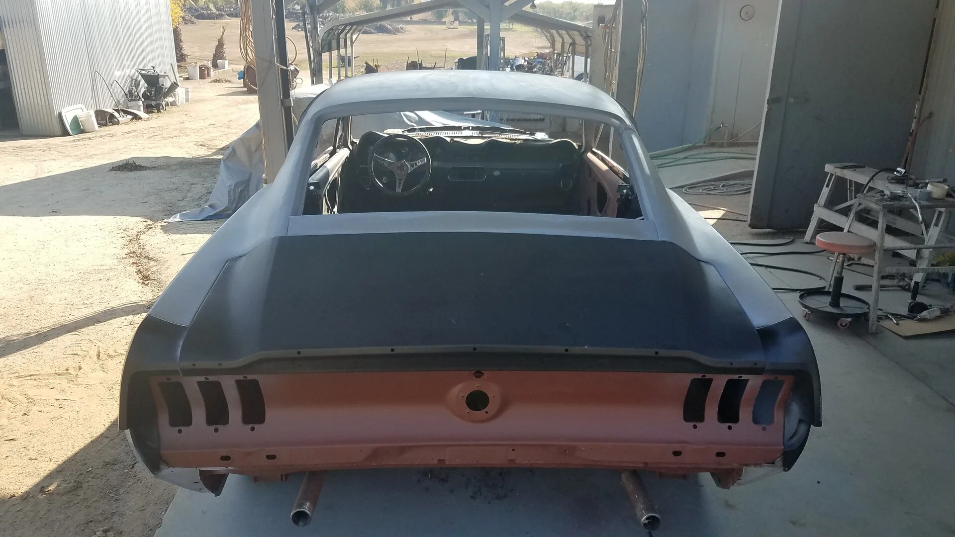

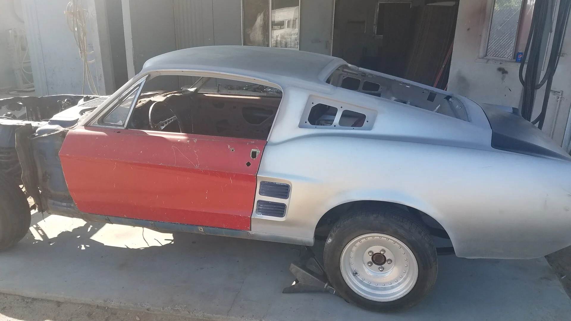

A fast back conversion for randym67

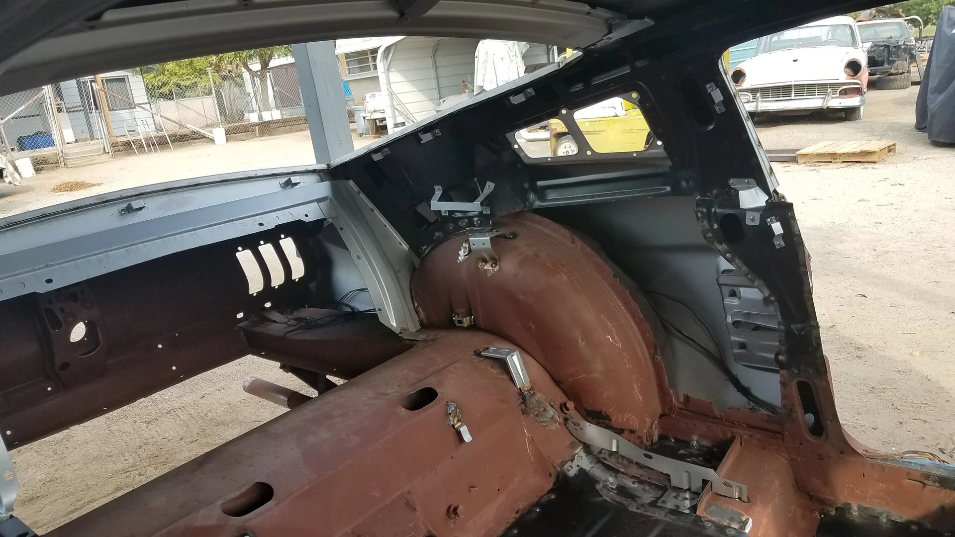

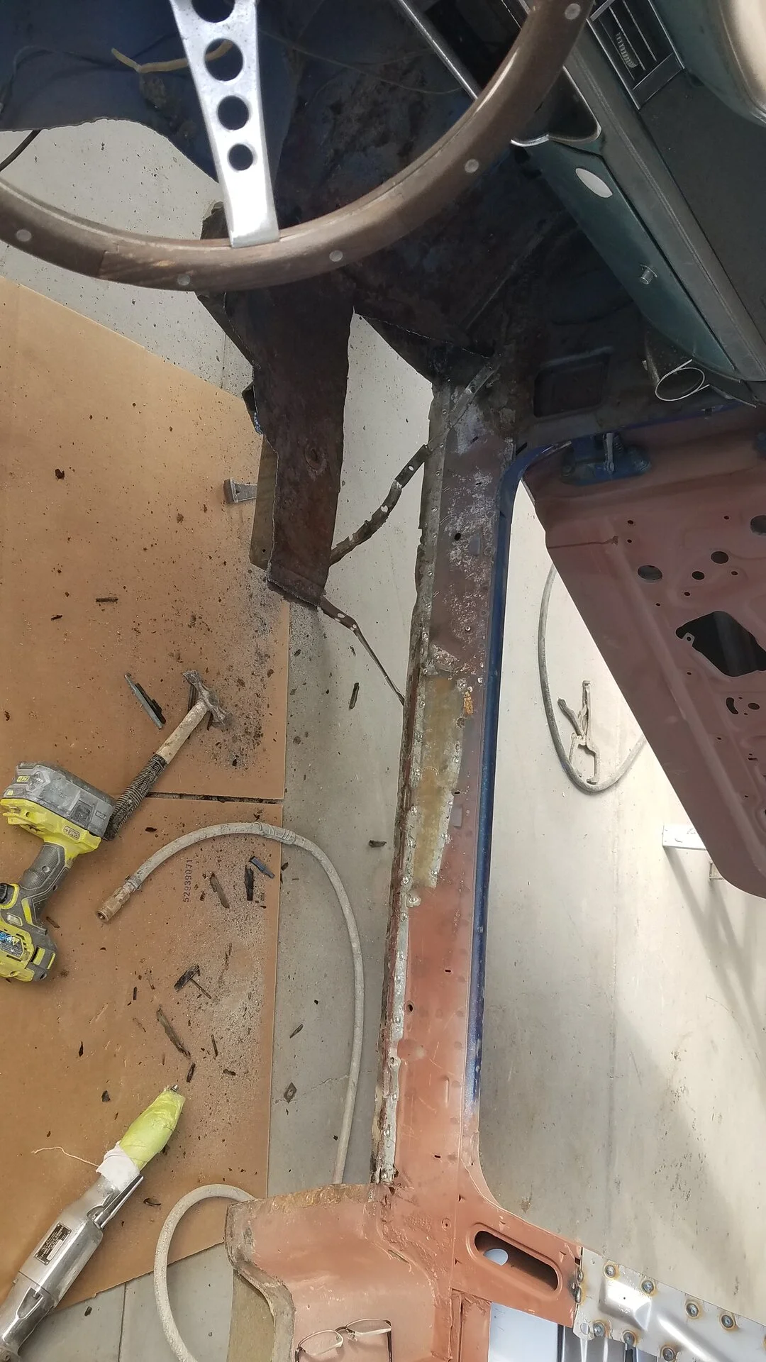

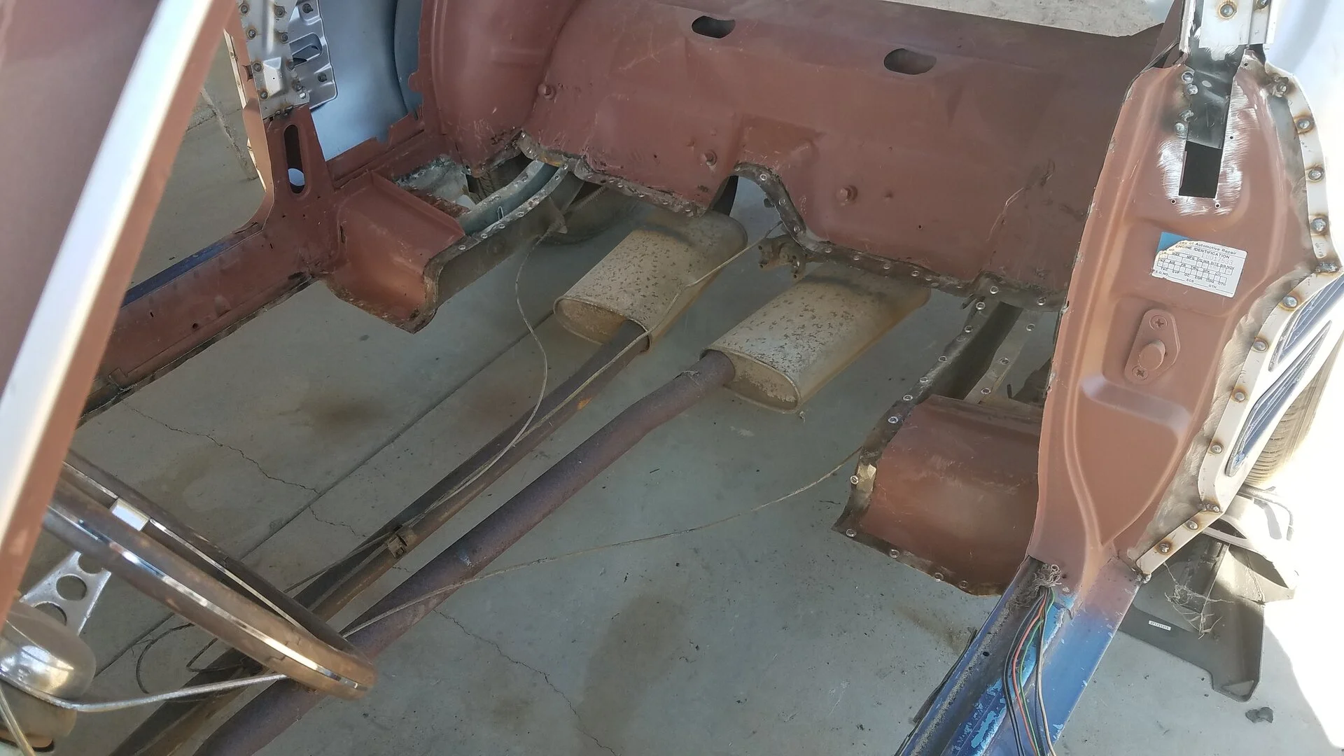

Got the back end of the floor out ,still need to trim the front and just the flange off the rockers . I will sand blast the lip and toe boards and primer before the new floor goes in

I checked on sheet metal availability and they had almost everything for my 65 fast back ,except for a upper and lower cowl and the radiator support and front cross brace ,if any one has one they want to part with message me

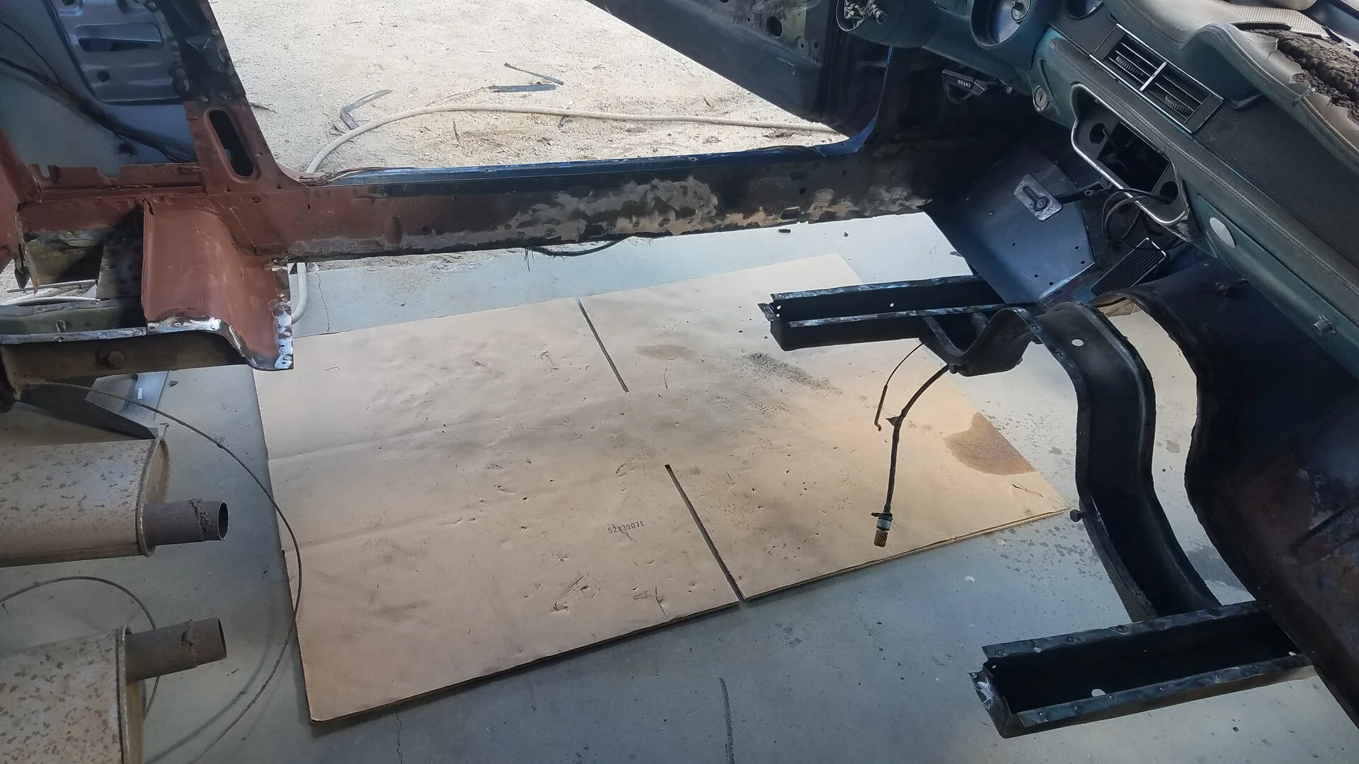

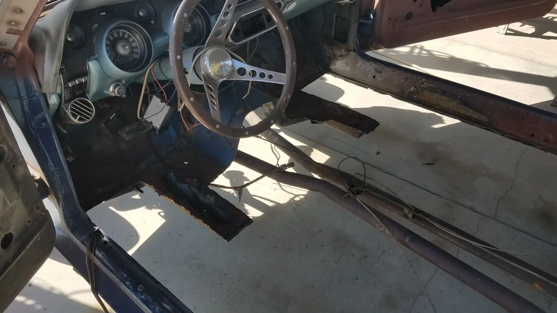

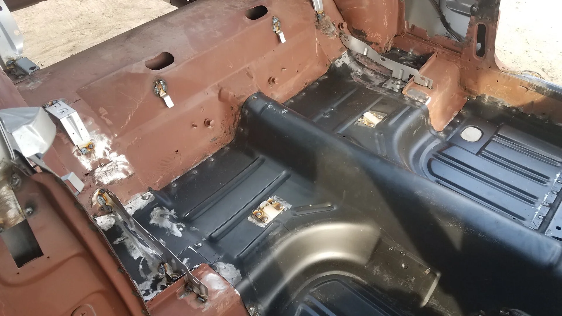

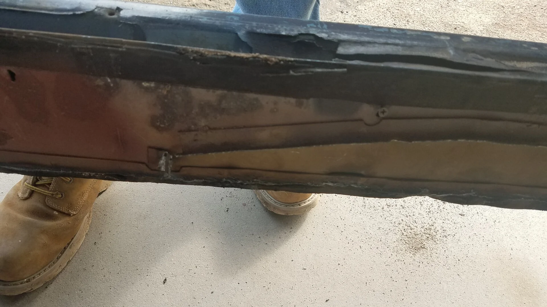

That was a hard trimming ! Its hard to find a spot weld under rust so i wound up cutting it in pieces to get the last of the old floor out ,everything else is solid except for a small patch for driver side toe board.
I will set the floor in tomorrow ,but sense i dont have any help i get to set it by my self . It will get all the flanges marked for plug welds then come back out for drilling ,then i get to set it back in again and weld it up.
Reactions: 2Blue2

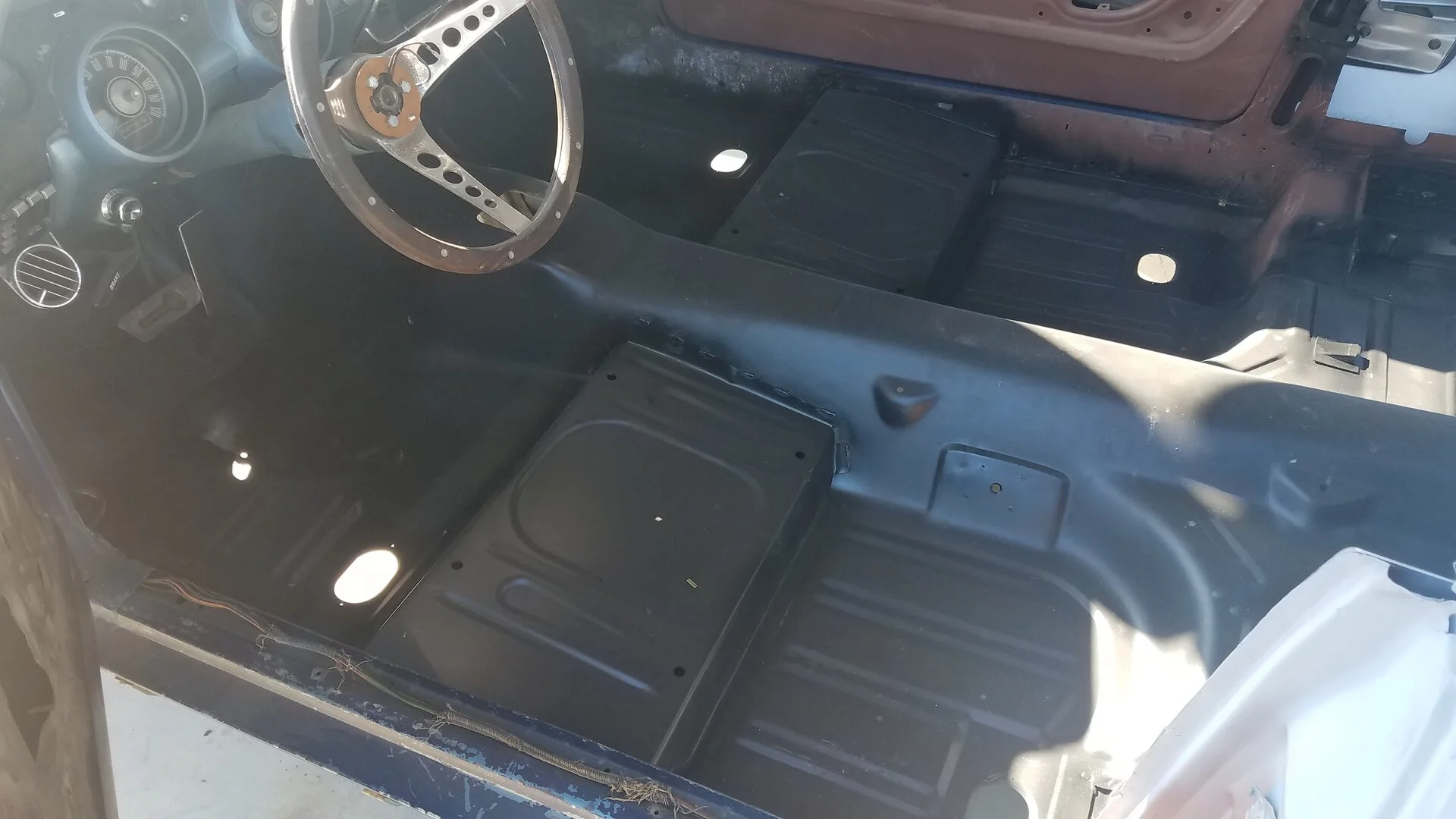

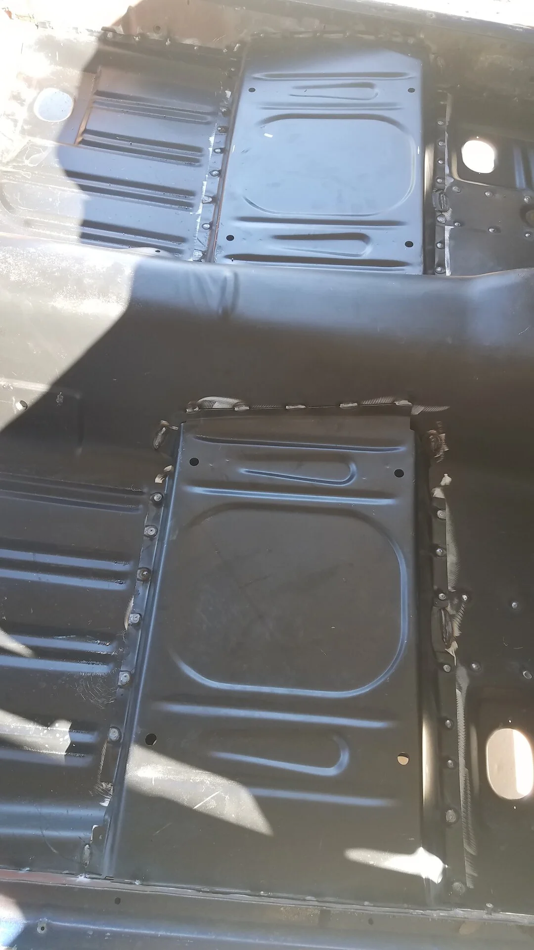

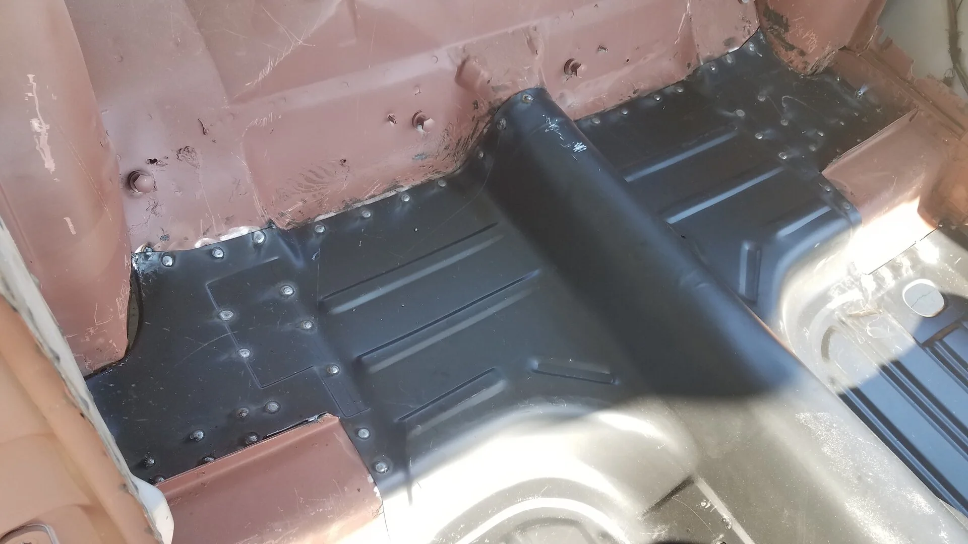

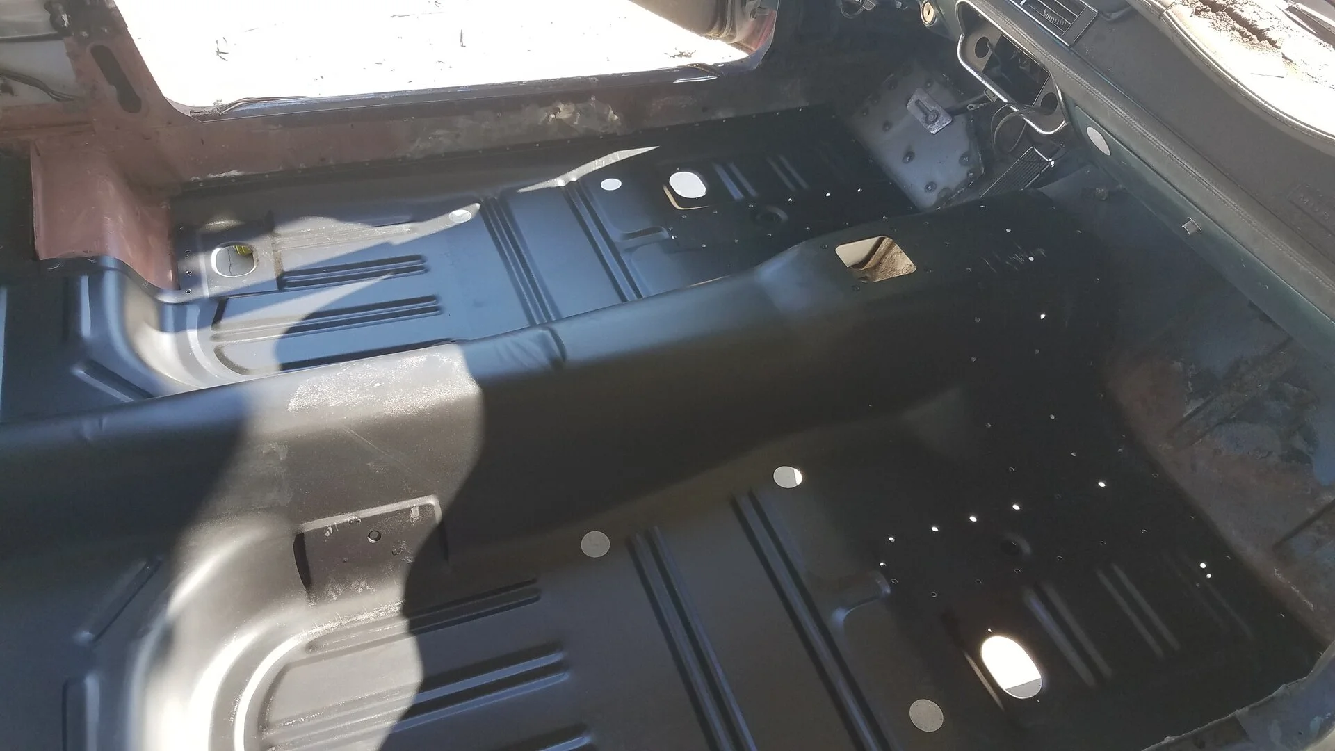

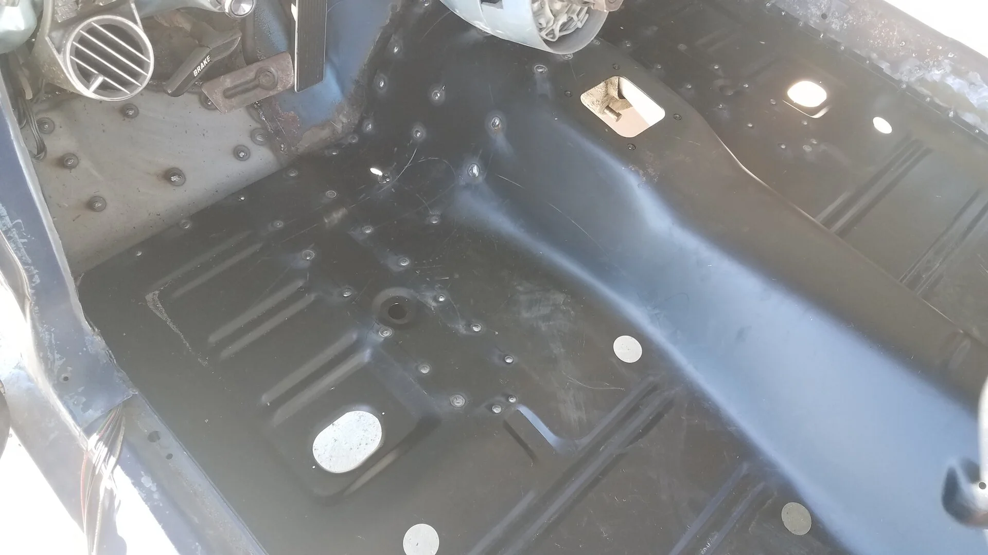

The new floor is setting in place ,i measured and marked the plug holes ,there was no way i was going to put it in then take it out to drill then put it back ,it was all i could do buy my self just placing it one time .
The toe board i patched first ,still needs the welds ground down but welded in nicely .

I should have this all finished late tomorrow ,just a couple of welds and lots of grinding .
