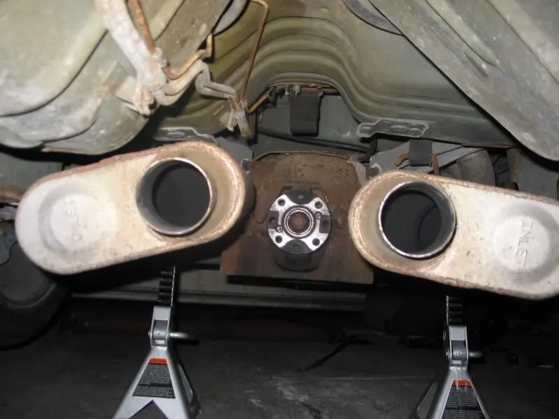

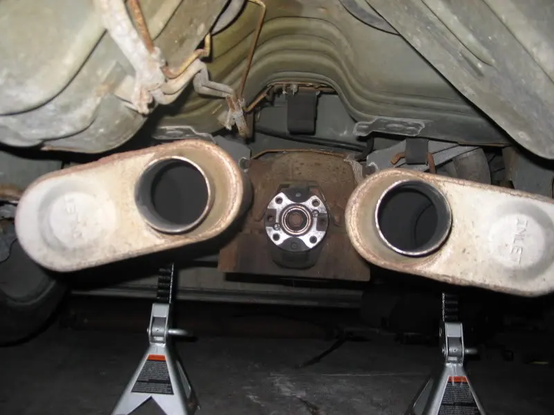

By the way, it only took me 5 minutes to undo the nuts on my exhaust pieces, but it took dang near an hour to get the pipe out! I've never seen a pipe wedged so tightly into muffler. I had my feet pushing on the mufflers and my hands pulling on the - part of the H, and doing every other thing. Jeesh, pictures to come once things start looking pretty. Thanks guys.

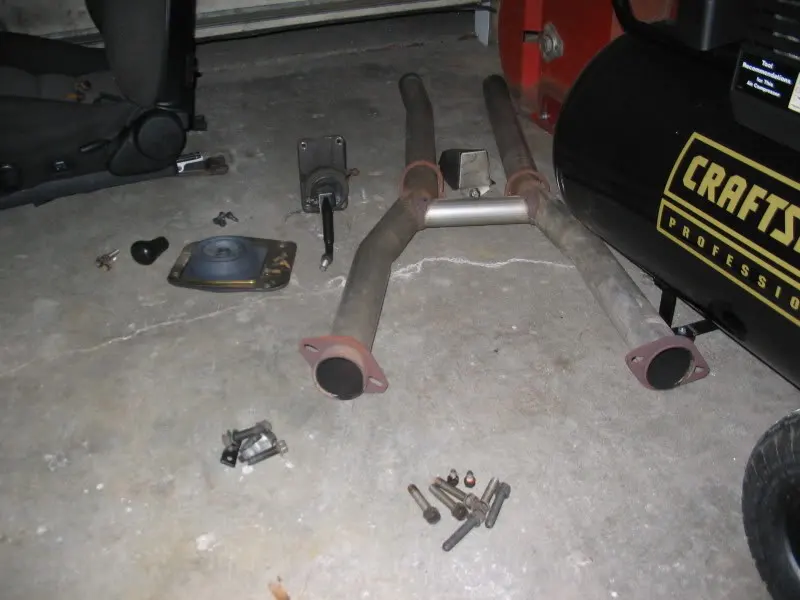

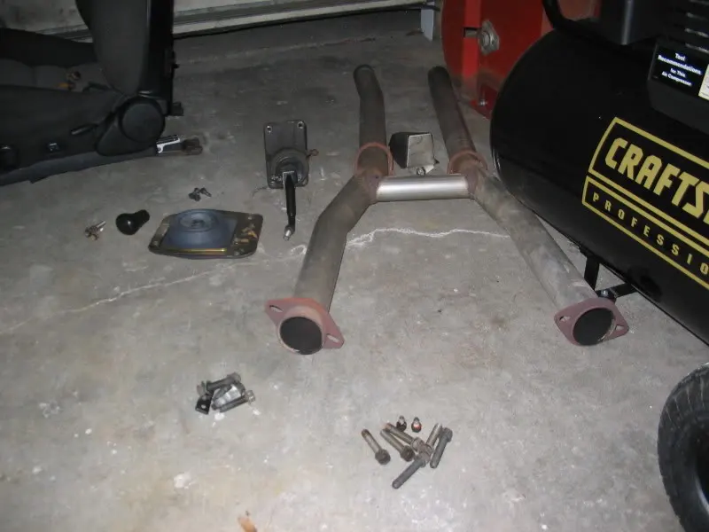

Made some more progress tonight, but the T5 isn't out yet. I was able to get the driveshaft out without a single issue once I realized I could fit an extension I have up to my 2 foot breaker and it all went well. I drained the T5, pulled the stock shifter off, and spent well over an hour getting the starter off.
The bottom bolt was cake, the top bolt made me wish I was throwing my head through the garage door. Is there any way with long tubes to not need to use a decent length extension and go up and over the starter from the bottom? I was removing that bolt 1 click at a time. Other than that I should be pulling the transmission tomorrow. I have a Pilot Bearing puller, some grease, and hopefully every other thing I need to make this right. Well, I need washers for the top bolts, but that's no sweat.

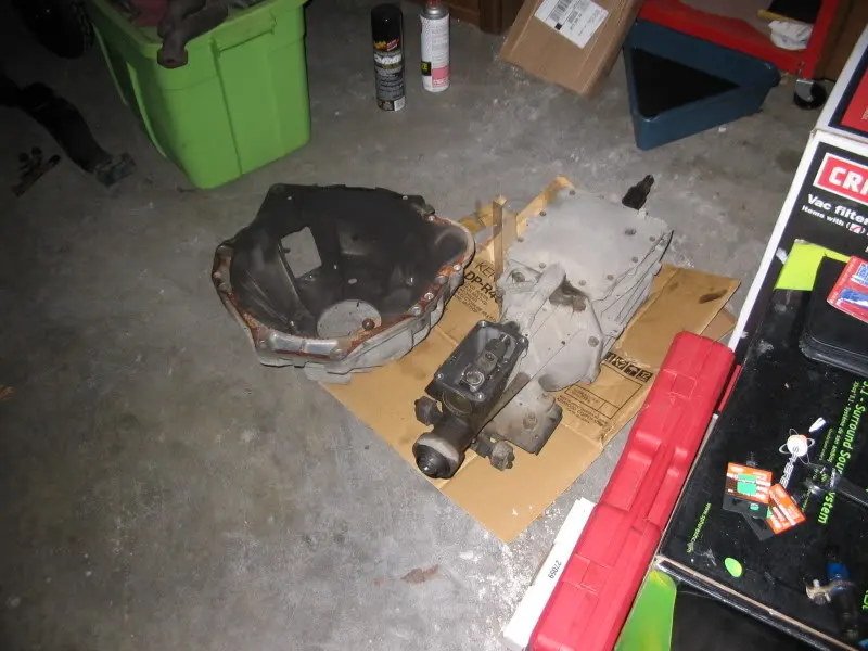

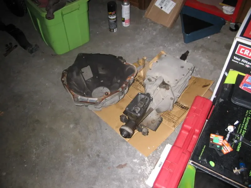

Nope, I opted for just the Tremec Aluminum one. I know Paul (KillerCanary) had tons of problems with his transmission swap after not indexing the bell, but from what I've read about people who got the Tremec bellhousing they didn't have much of a problem. If I get a vibration my first thing to do will be to get a driveshaft spacer. I got my stuff from www.bieberfever.com (and they did a great job of hooking me up, Mike, Tom, and Aaron helped me a lot) and they said that the slip yoke has plenty of spline contact area and you don't need one. I think they said that the 96+ FR driveshafts have a longer slip yoke than ours stock, and I will prove/disprove that when I measure them tomorrow. Other than that, I got some pics.

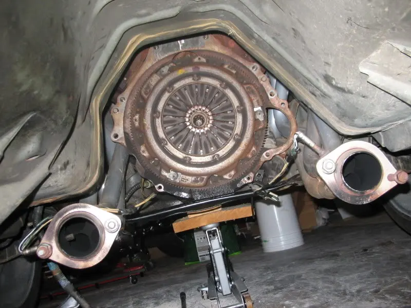

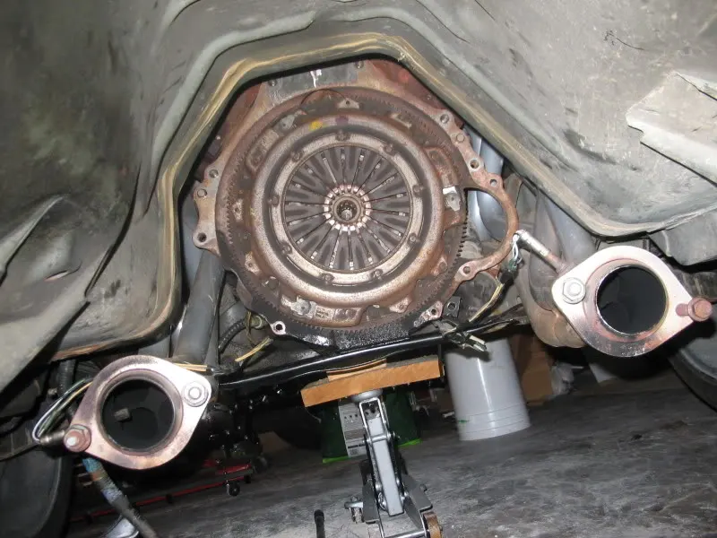

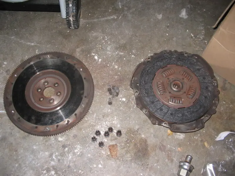

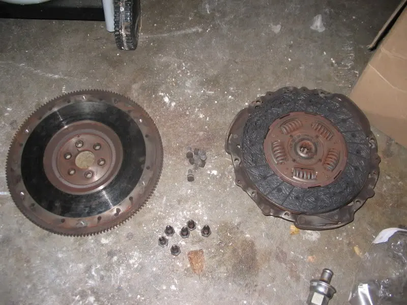

I was looking at the clutch disc and was thinking that it looked in really good shape considering the car has 56k on the clock, so I wonder if this is a relatively new clutch? I had a little trouble with the passenger side transmission crossmember bolt as the head appeared to be stripping, but I luckily hammered a socket onto it and got it out. I used the pilot bearing puller and slide hammer from Autozone and I got it out in less than 5 seconds, I seriously recommend it to anyone over trying to displace it out with grease. The trickflow thermactor plugs ended up being a waste of money, I couldn't get them in and I didn't want to screw around so I just cut off part of the thermactor tube and turned it around like I've heard of many other people doing. Other than that, I hope to have things up and running tomorrow night, but we'll see what trouble I can get into tomorrow.
