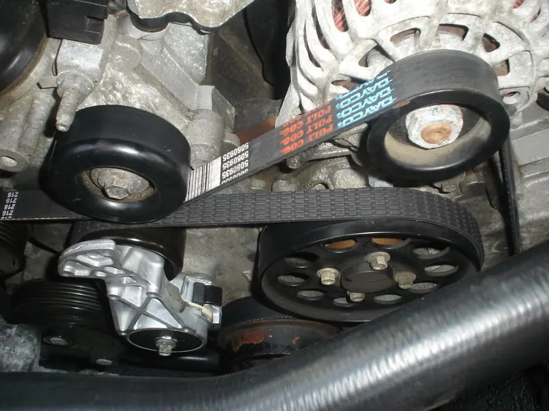

I don't know if anyone can see enough in this picture to know if the pulleys are stock because i bought this car with them on it and someone told me I had some under drives and some stock. If so how much boost loss will I see?

As for the UD pullies you would almost have to pul them and measure them or look for a brand stamped on them. If some are UD pullies it wil hurt you quite a bit, do to them pretty much killing your boost.

BigDave: those are steeda UDP's - for sure the water pump and crank pulleys are, most likely so is the alt pulley (it comes in the set) but some people don't put them on so it might not be (again it PROBABLY IS a UDP). You'll lose 1-2lbs of boost, or maybe a bit more. You can buy a stock crank pulley for cheap if you can find one on some forums or ebay or something, otherwise expect to pay quite a bit from Ford.
