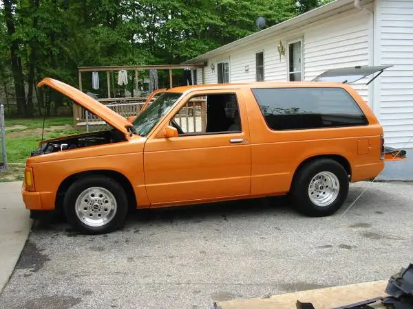

Got a 900 HP street legal GMC S-15 Blazer for a race car.
