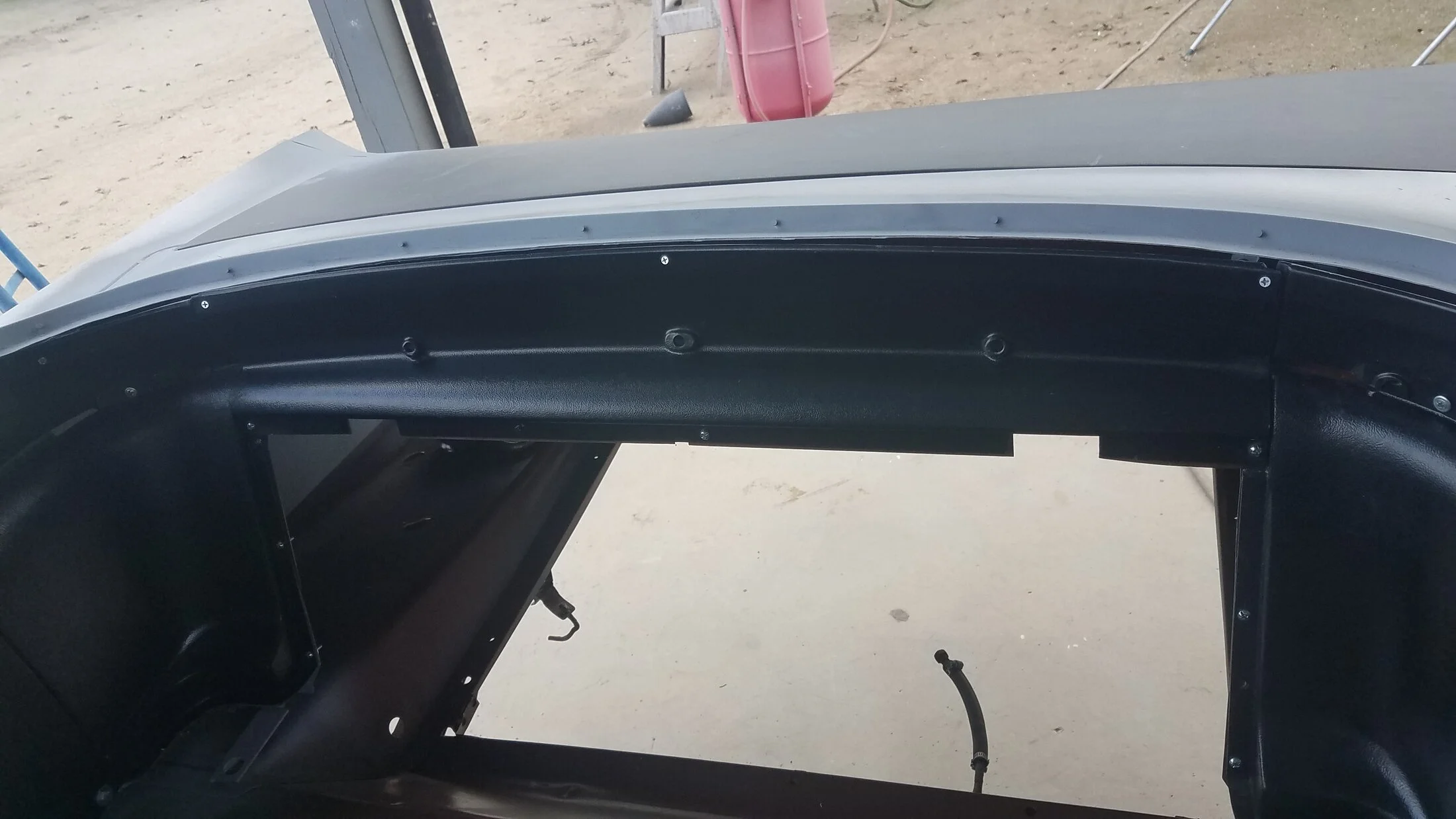

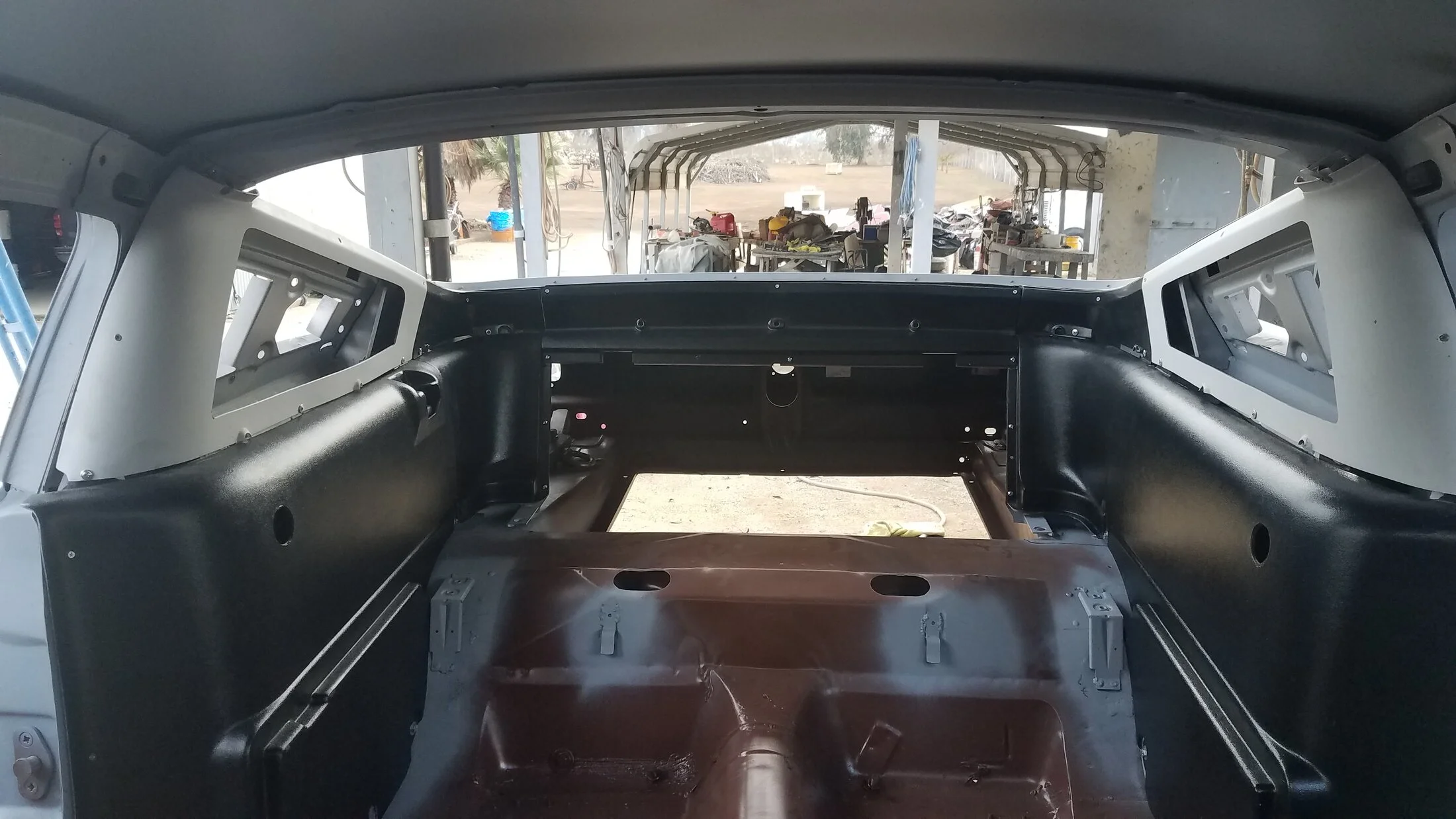

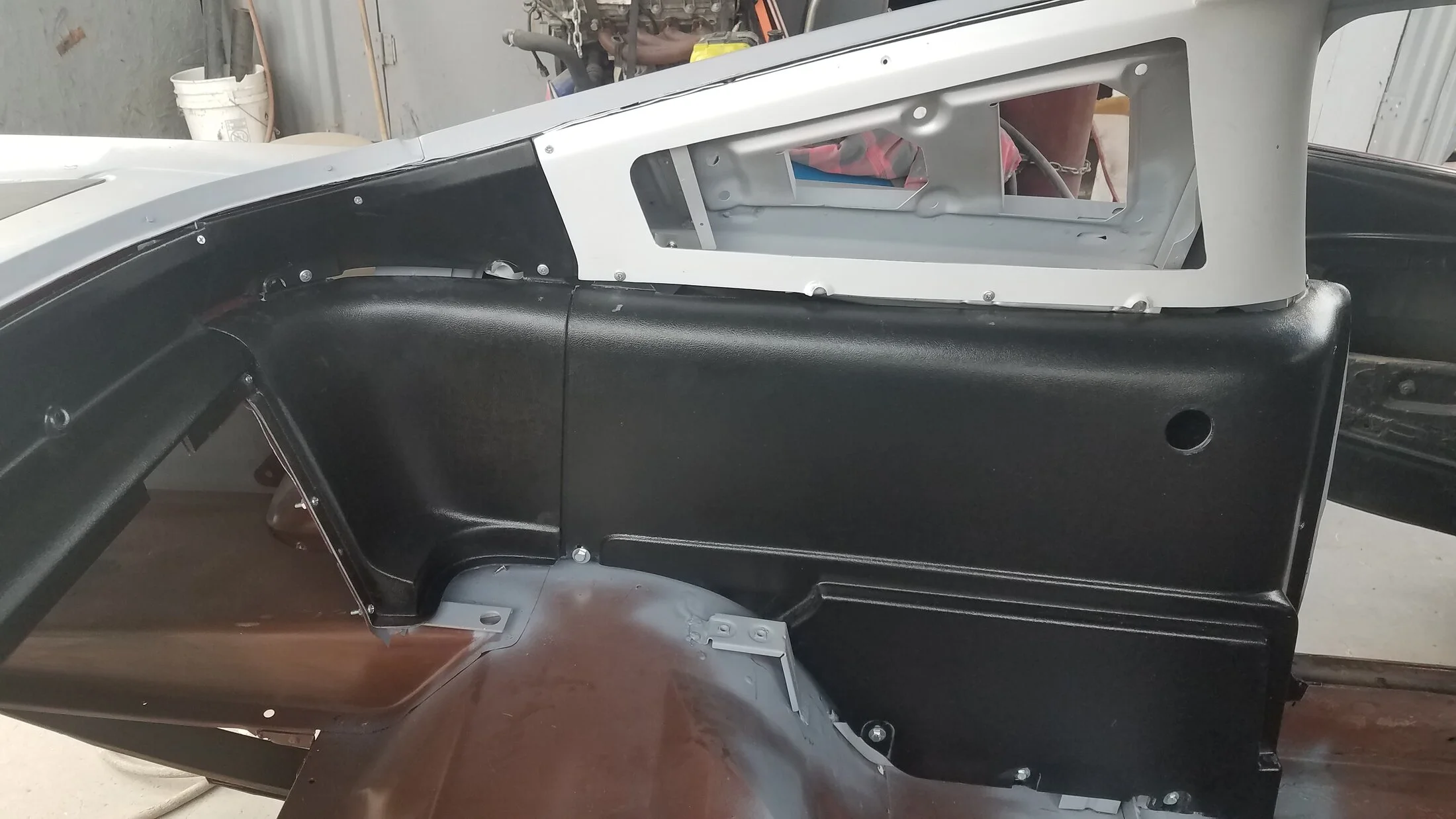

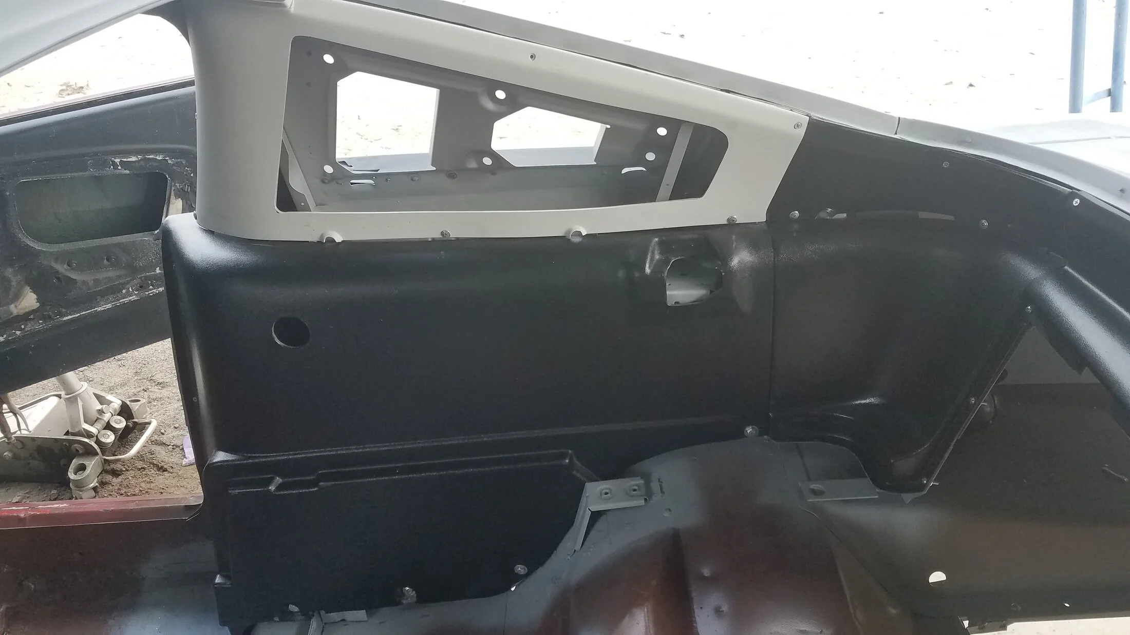

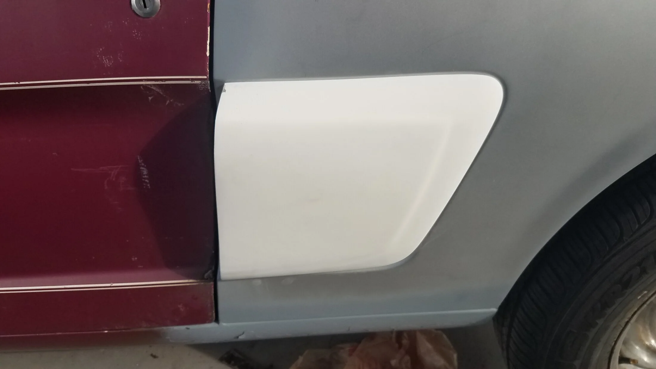

Bolted and screwed down all the interior fiberglass,used my Nephews quarter vent trim to drill the rest of the mounting holes. Really nice gapes between panels . Wrong screws of course because my paint supplier didnt have the correct bubble head screws but i need all the mounting holes drilled . I even learned a few things about aligning the panels .

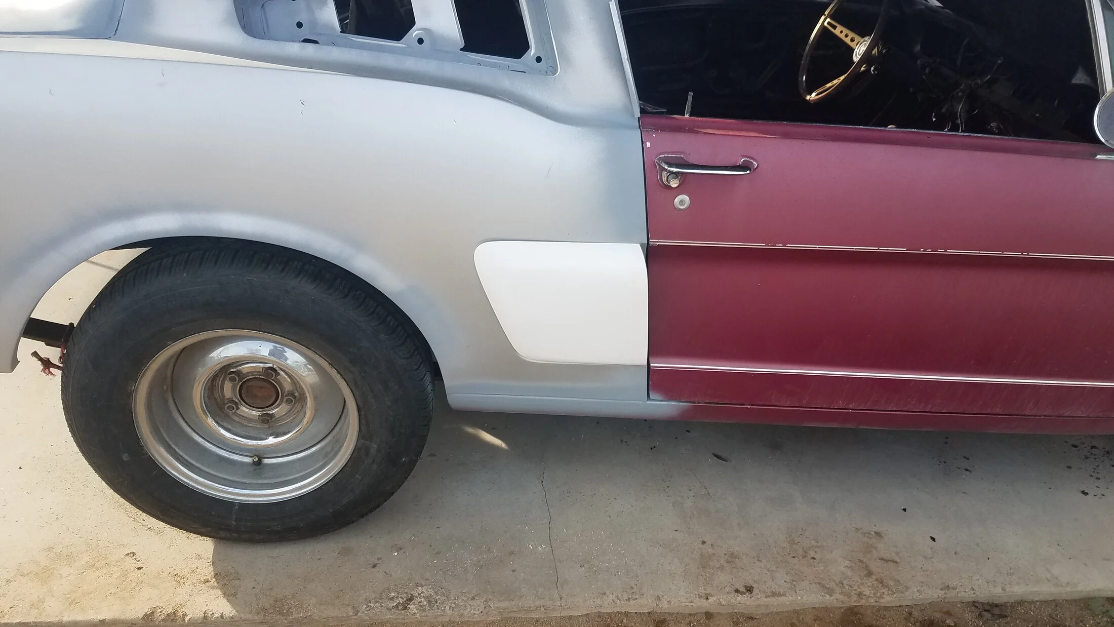

The two side scoops are on ,they are only held on with sheet metal screws so they can be removed for painting ,they will need to be pop riveted after paint .
The floor patches are cut and ready ,i just have to trim out the rotted parts of the floor and weld in the patches and it is finished!

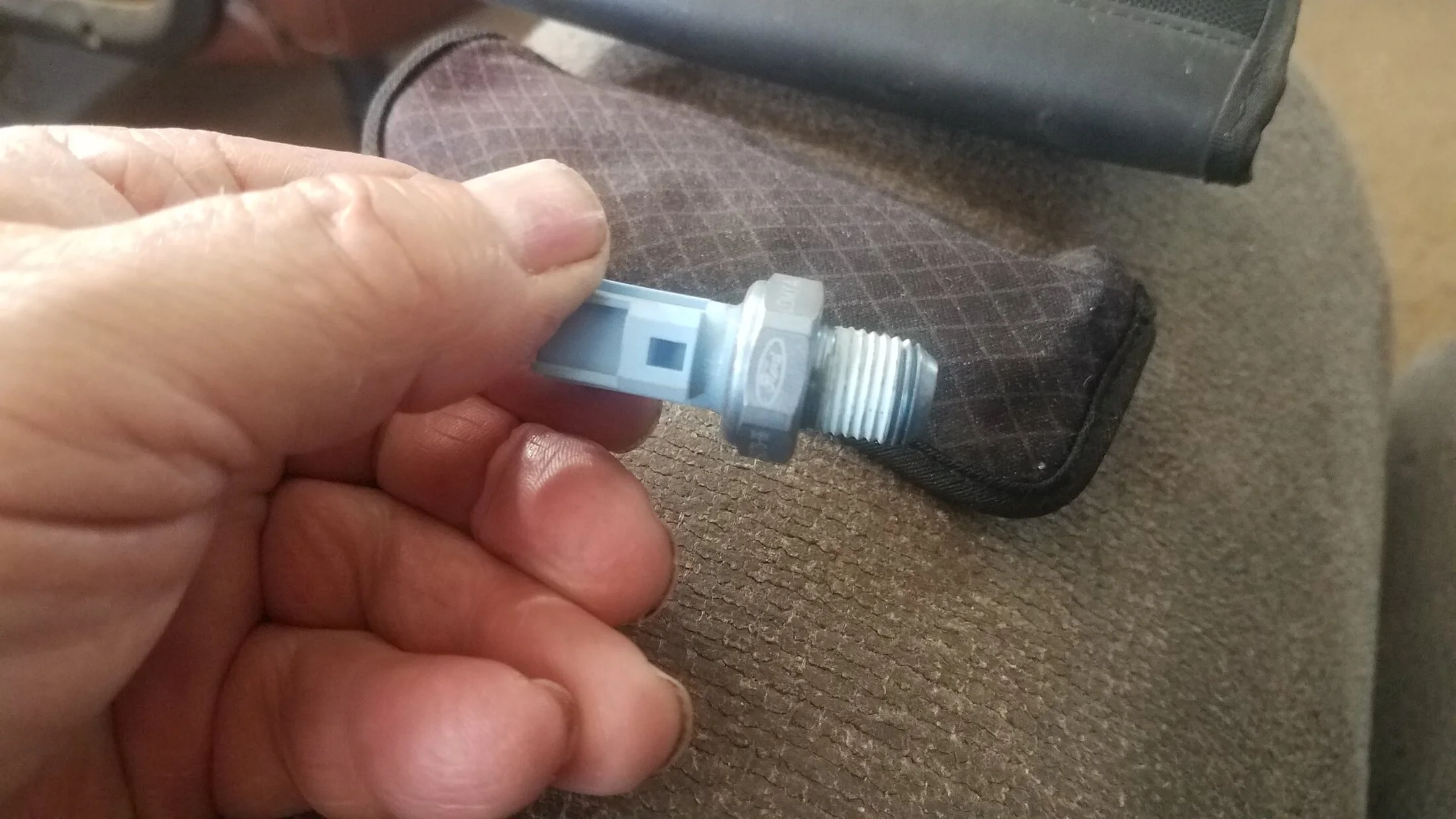

Oh 2023 ,nothing like giving me one last ,last minute kick in the butt ! My sister got T boned in her Expedition and totaled it ,she has been using my truck ,i need my truck so i went out and bought her a 2011 Ford edge ,damn thing quit on her today so i had to drop everything to go pick it up . I think it is the oil pressure sensor ,i read they have problems . It comes up and says low oil pressure and kills the motor . Let it set a minute hit the key and it starts and runs fine ,cant any thing go easily for a change ?
Had to pull off again to get this thing running so it looks like this week end is shot!

$55 dollars for that little bitty sensor ,Ford must really be proud of that sucker!

It's not even the sensor. It's just the CONNECTOR that belongs to Ford and that they're super proud of.
The pigtail to match is probably $30; More by now.

Got it changed ,what a SOB! It is in plain sight but i couldnt get my big arm in there ,after plenty of cussing i managed to remove it ,replacing it was even harder ,the connector just fell on ! Runs like a champ and no more light !

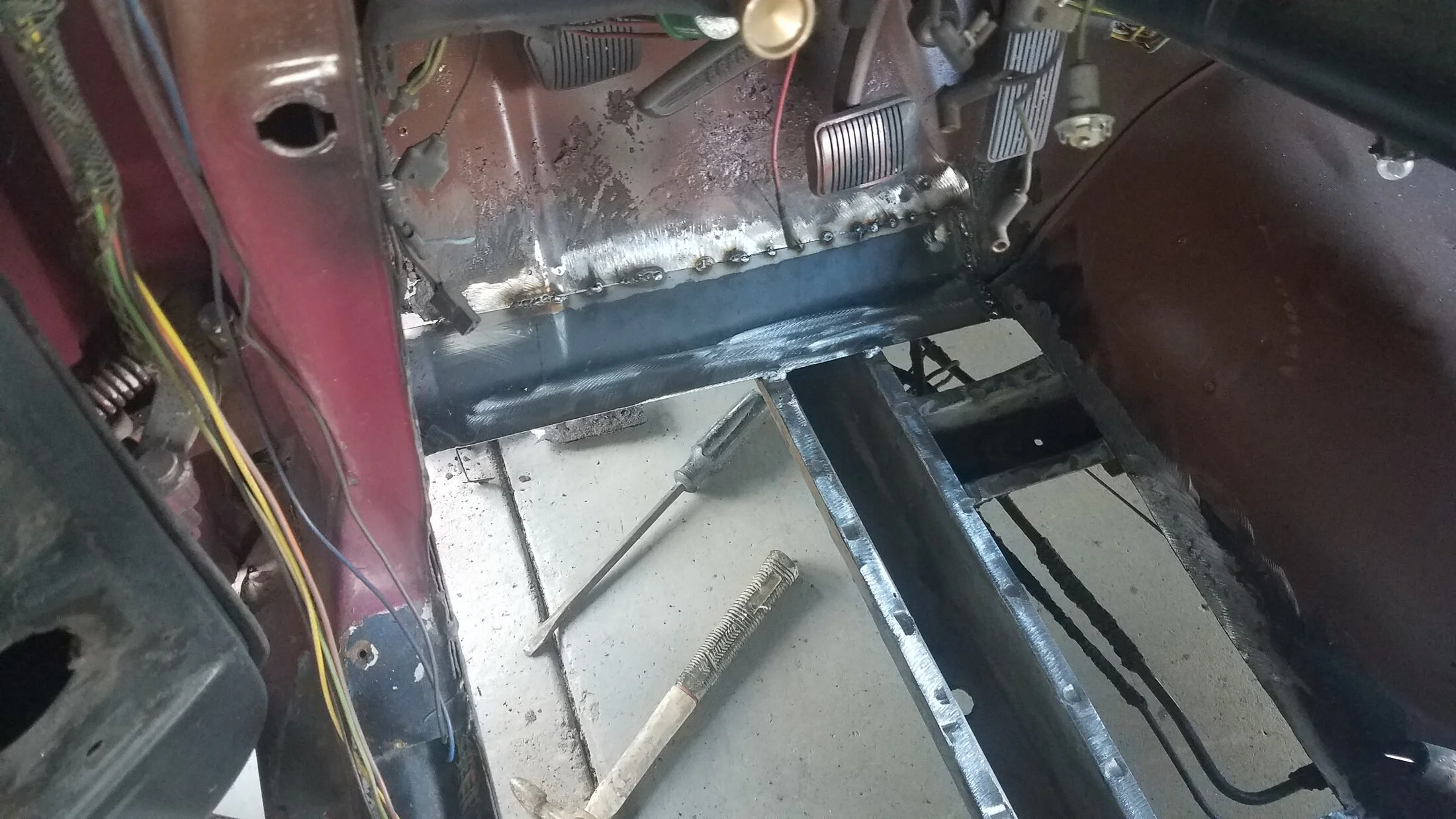

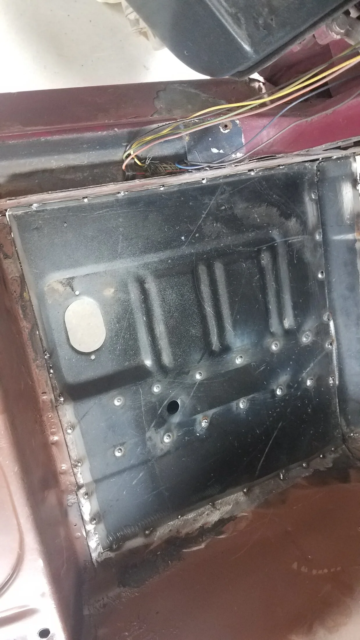

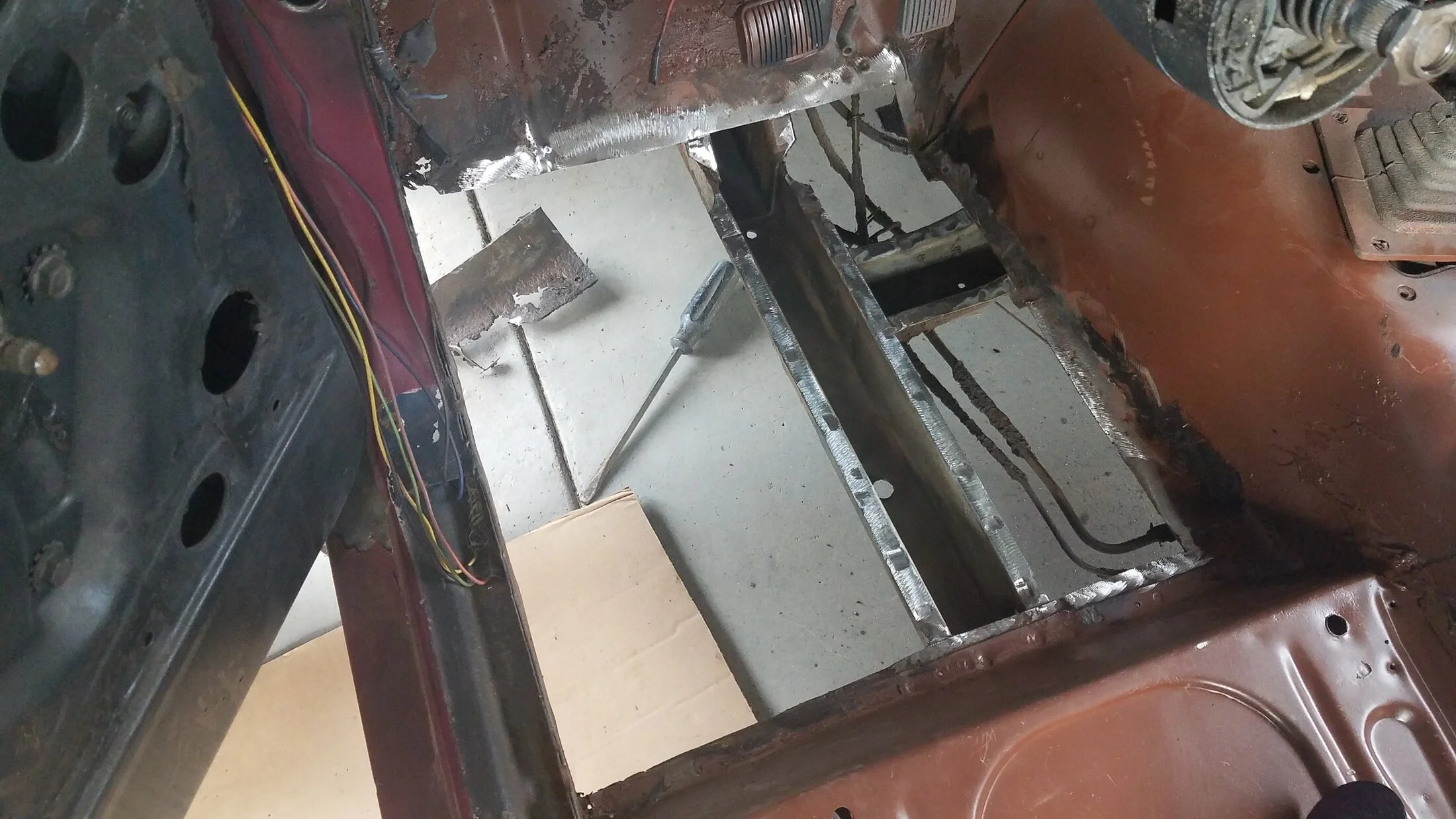

I finally got the driver side front floor cut out ,if i had known it was going to be this hard i would have gone with a full floor . It is undercoated under the floor and it flakes in places but not in others . I had a hard time cleaning the tar off where it will be welded ,i hope i got it good enough to weld

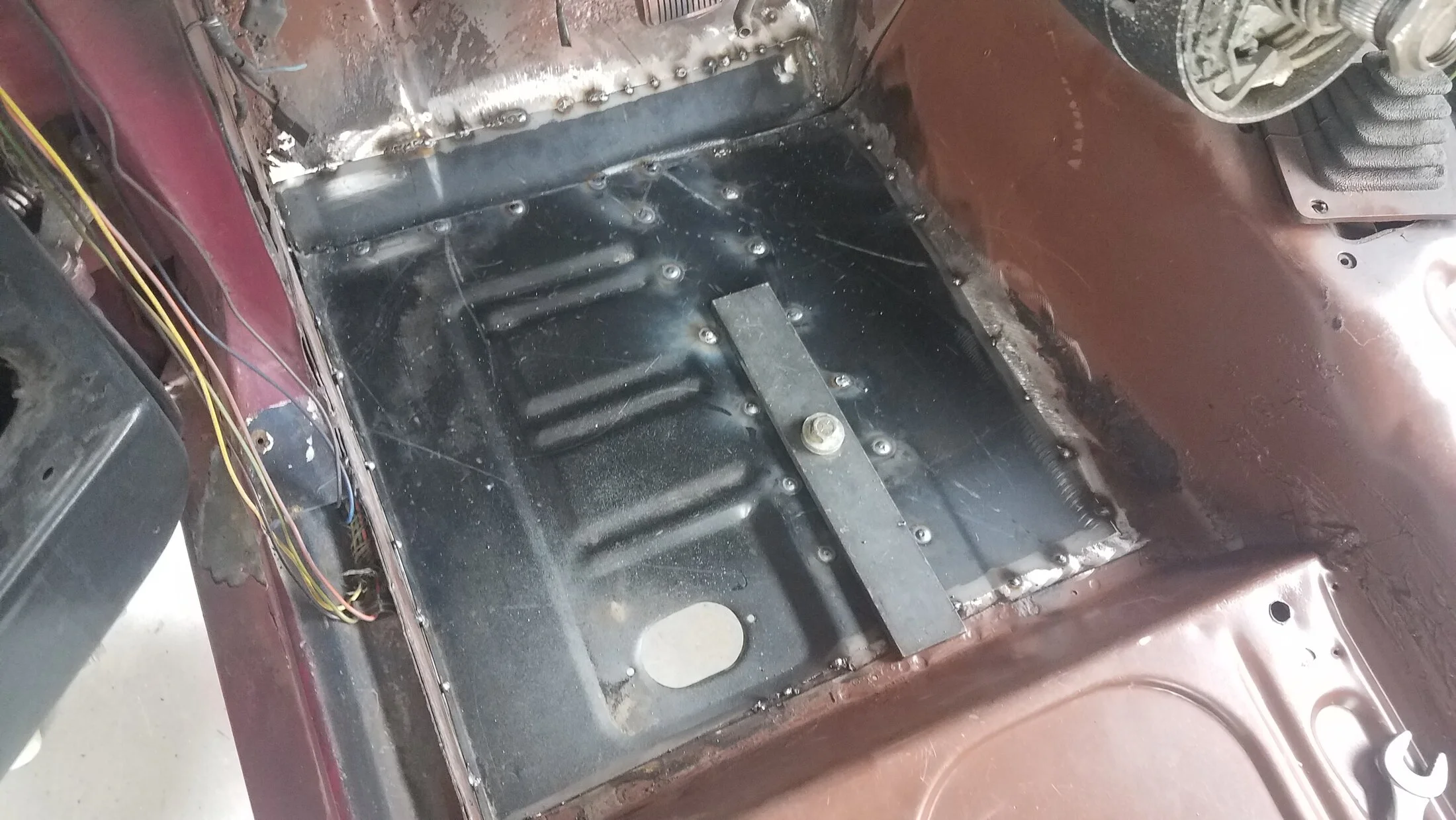

The toe board patch is tacked in place ,i am going to lay the floor in and tack it also so i dont keep falling in

My handy dandy floor clamp holds the floor tight to the floor supports nice! Finish welding and grind the welds and it is almost done ,there is still a small rotten spot a bit higher in the fire wall
