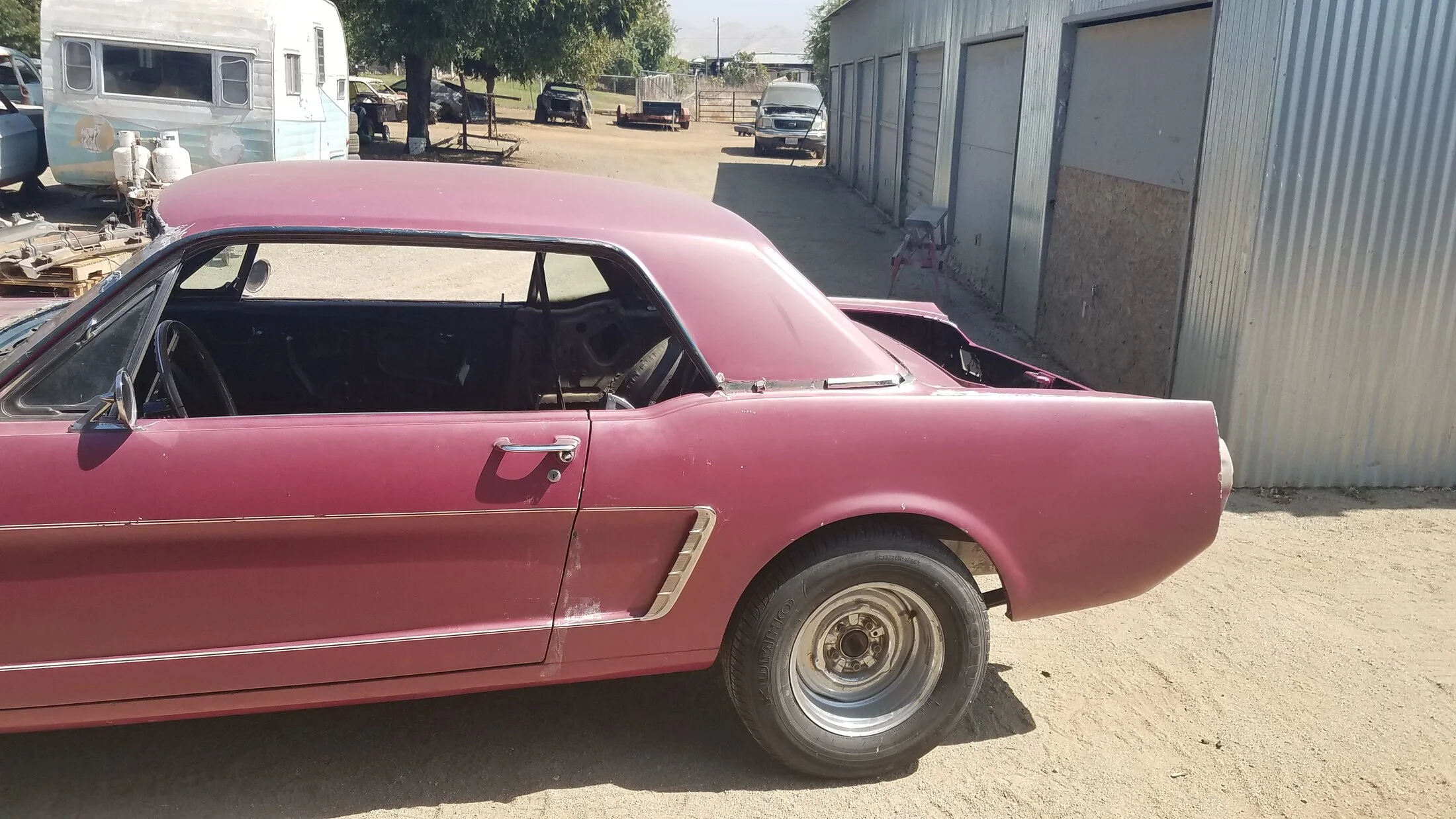

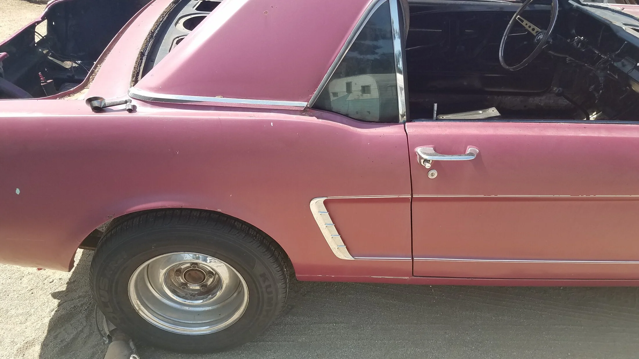

A pretty decent 65 coupe to be
converted to a fast back ,Jorge drove all the way from Colorado ,that had to be one long drive !

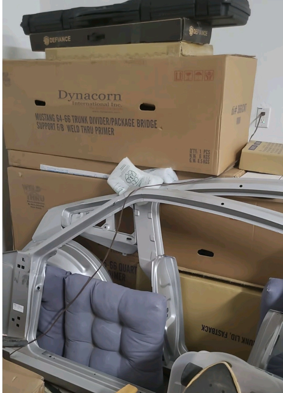

He brought all the parts for the conversion . I should be starting tuesday .

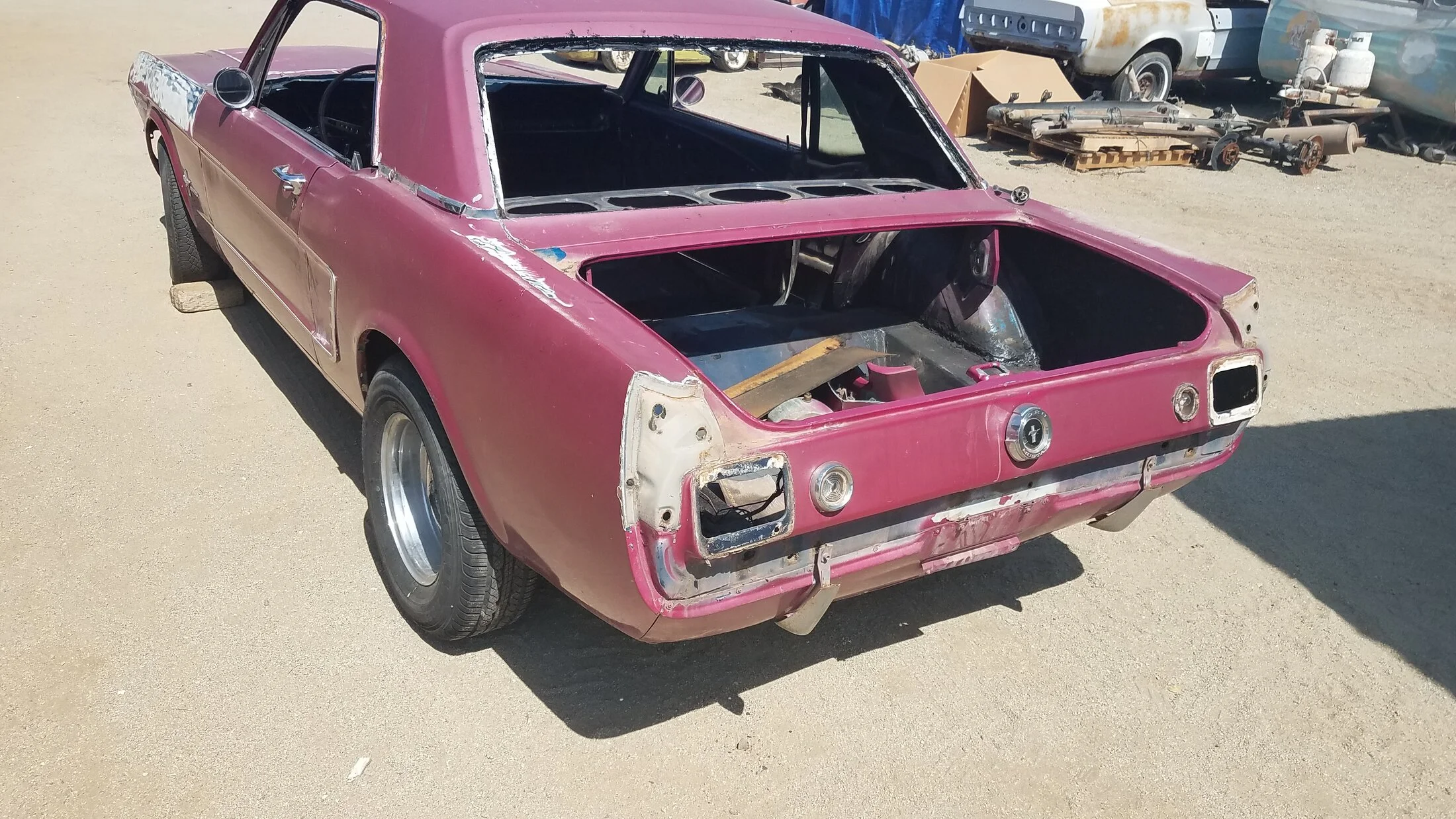

Its a pretty solid and straight car ,the doors fit great so quarter alignment will not be a problem .

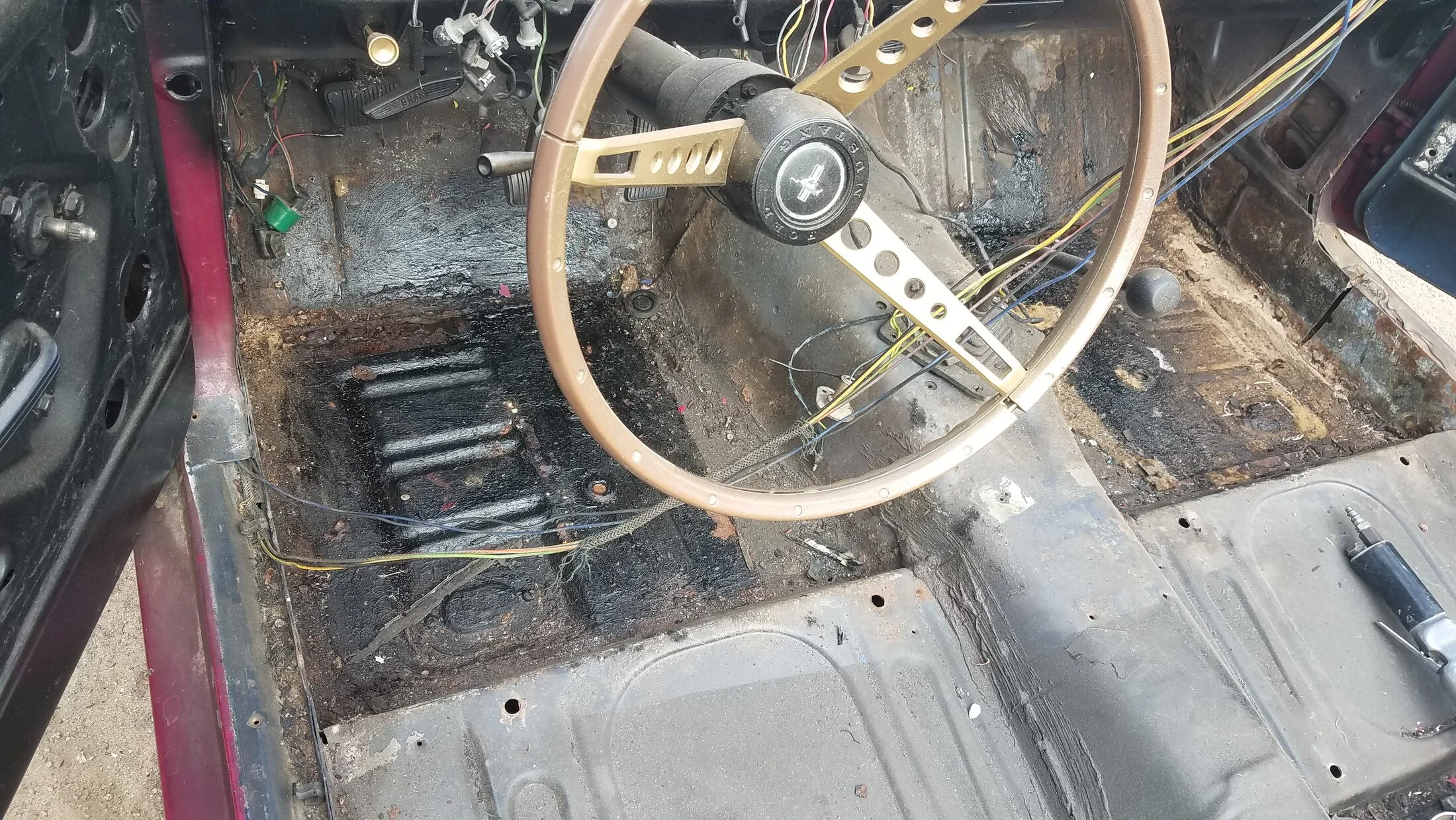

The only thing i see is the floors and some of the trunk has been coated with tar ,a bit of scrapping and hit it with the big blaster and it should be clean as new .

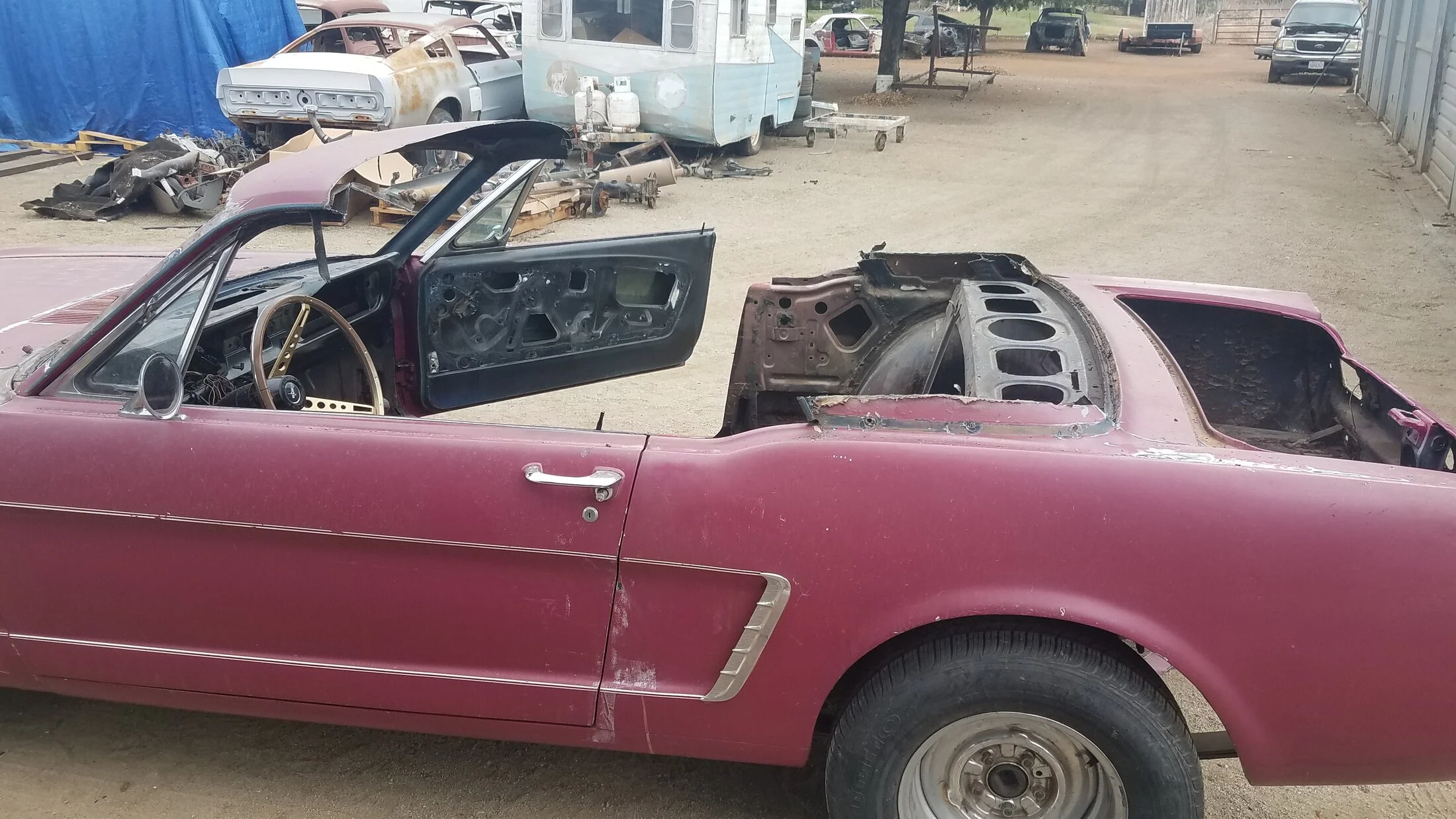

Got a bit side tracked today but i did get the trunk lid ,rear bumper and quarter extensions off .
, gas tank has to come out because BOOM ! and we dont want that !

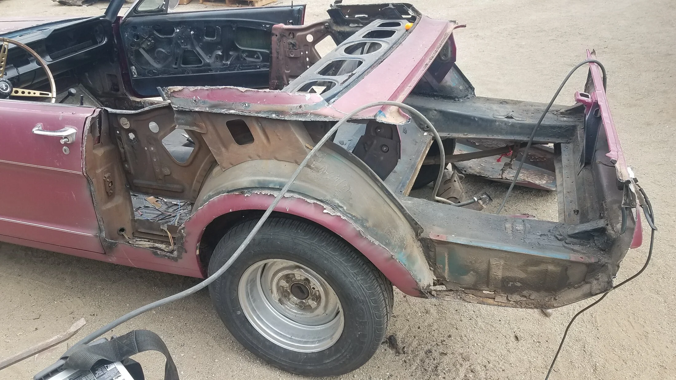

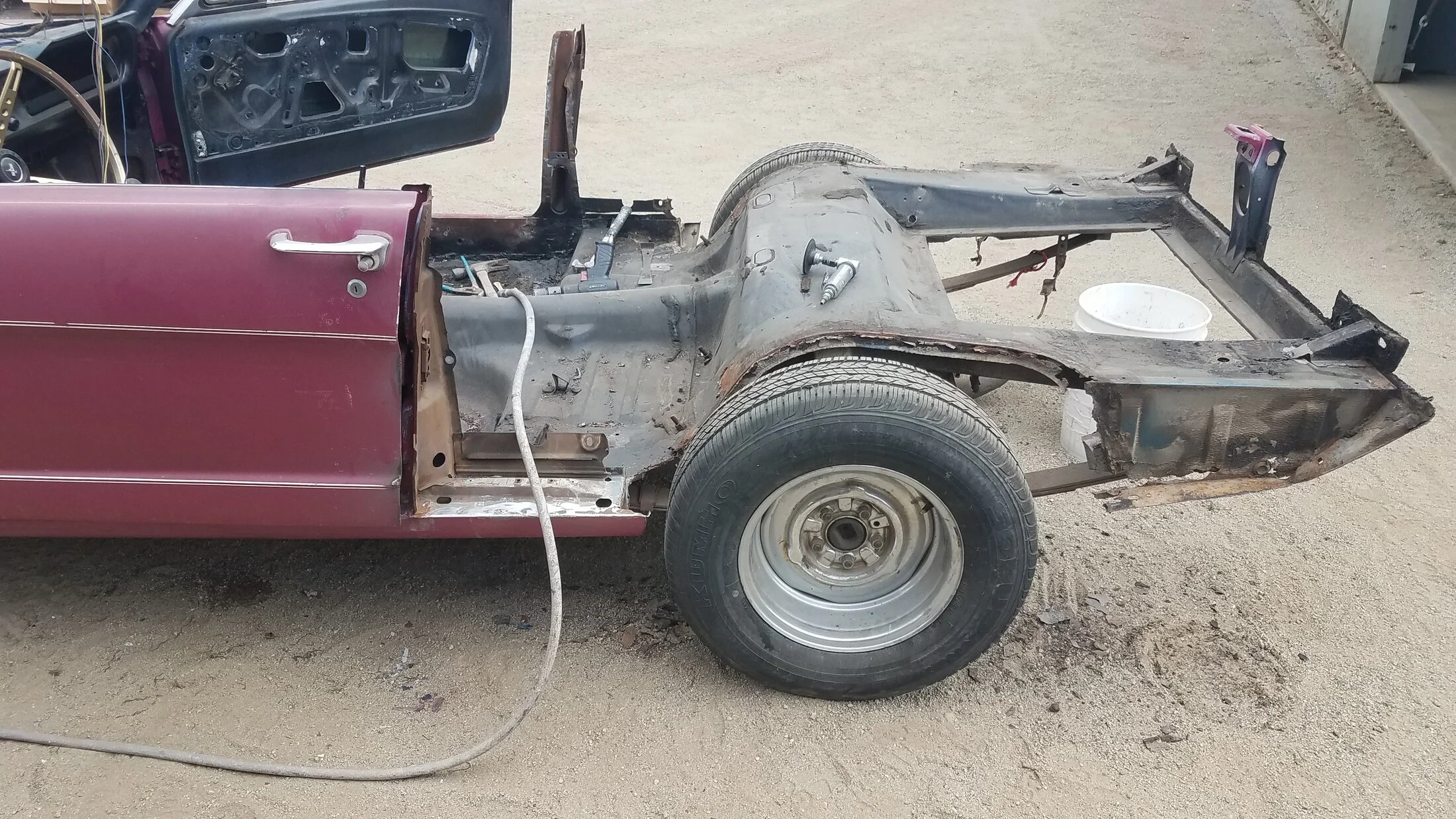

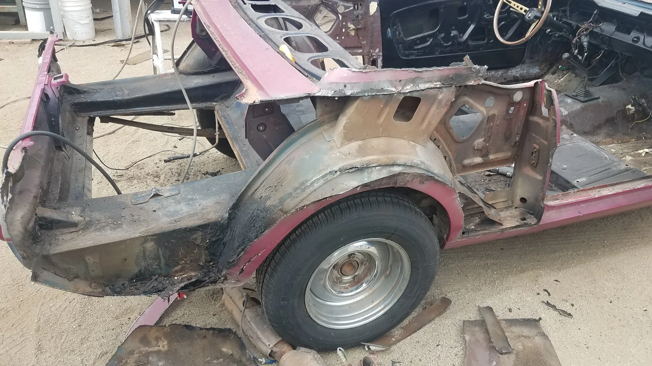

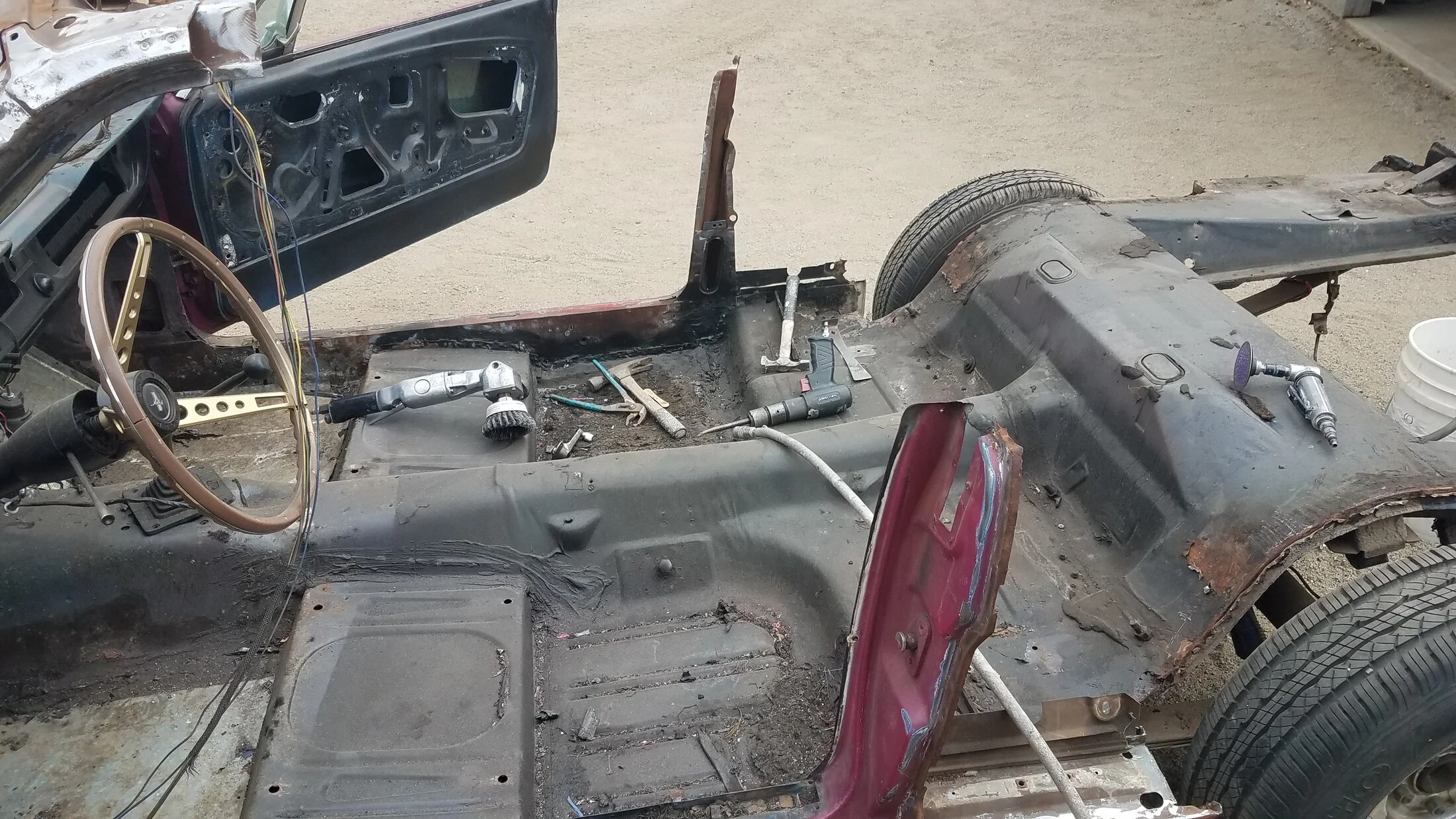

Got it cut apart today . A good couple of days to trim it out .

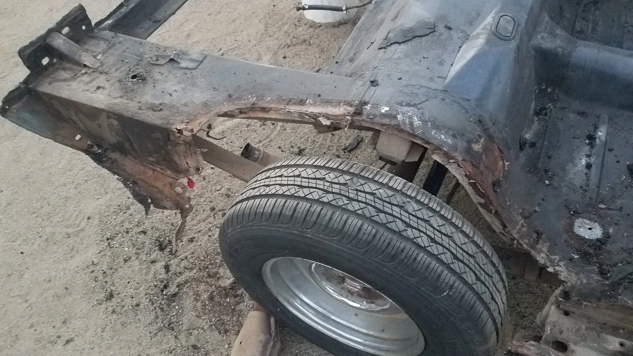

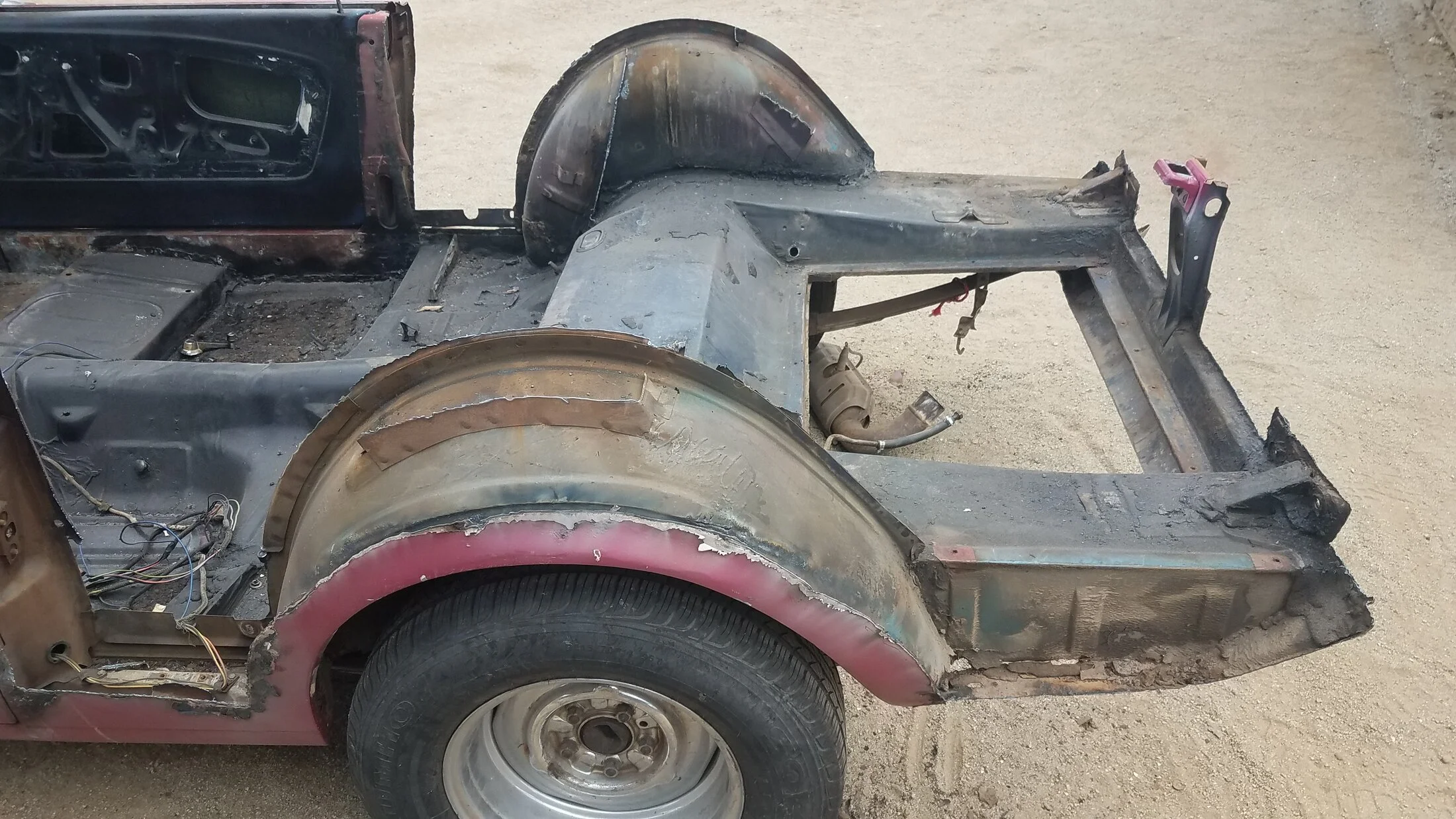

Both wheel tubs have to be replaced and both trunk drop offs also .

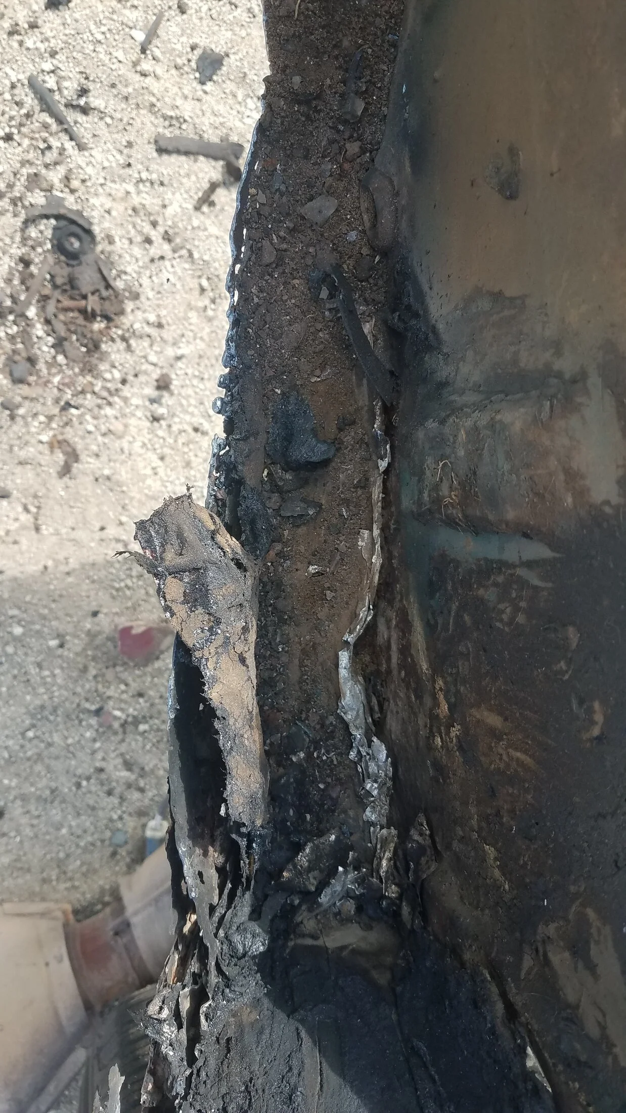

Passenger quarter had a surprise ,it was stuffed with aluminum foil and siliconed in place and bondod from the out side . The patch panels made it in yesterday but the tail panel didnt . I have one that is for one of my cars so i may use it instead of waiting for the new one .

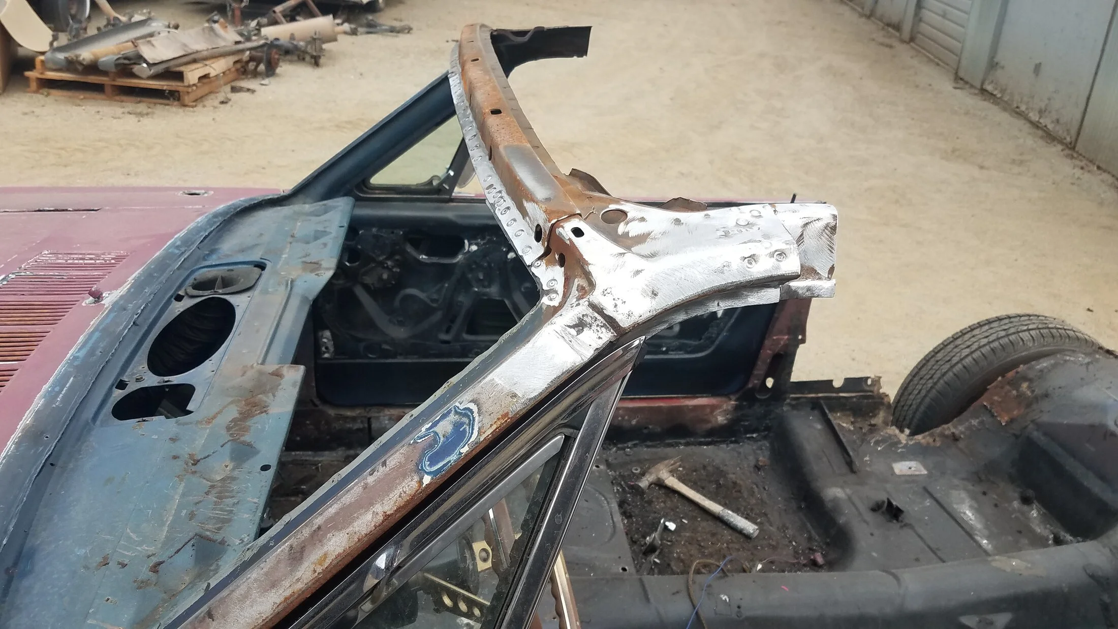

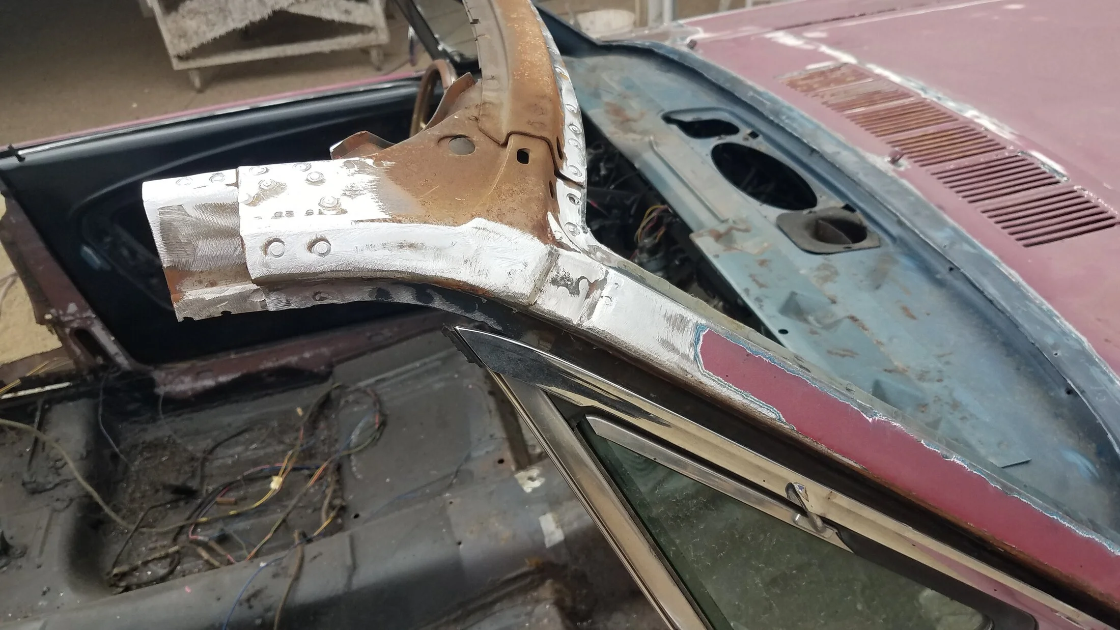

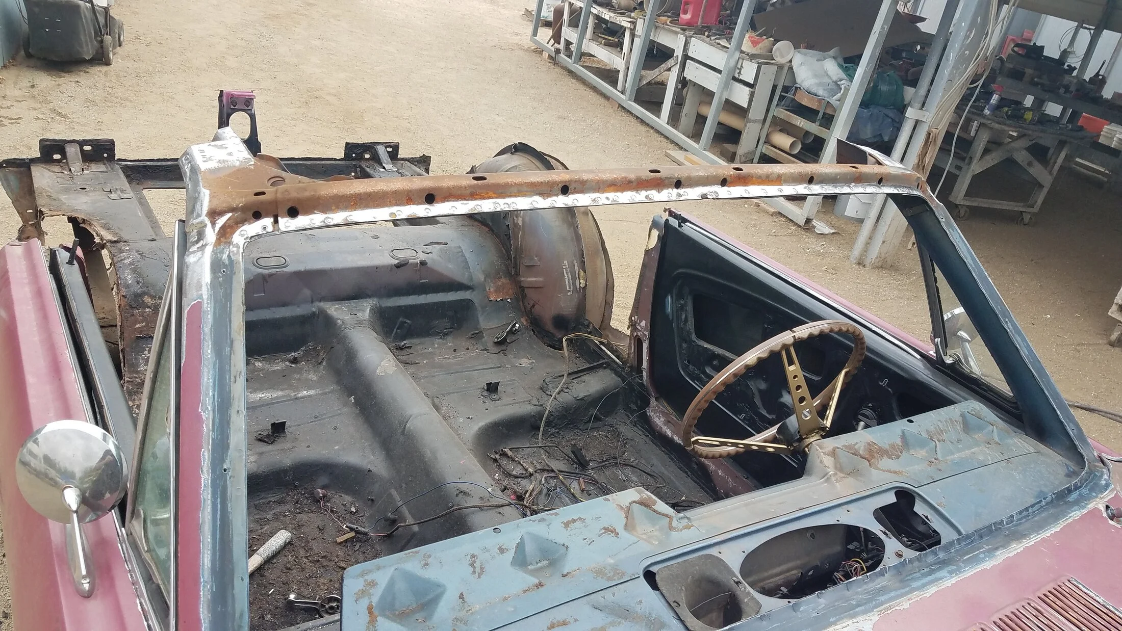

It looks like we are going to have to replace both trunk floors ,just to much rust to try to patch .
I got the rear door posts trimmed ,going to pick up some sand a blast the areas and primer before any new metal goes on . I still have to finnish trimming the rest of the tail panel but i will have that done today

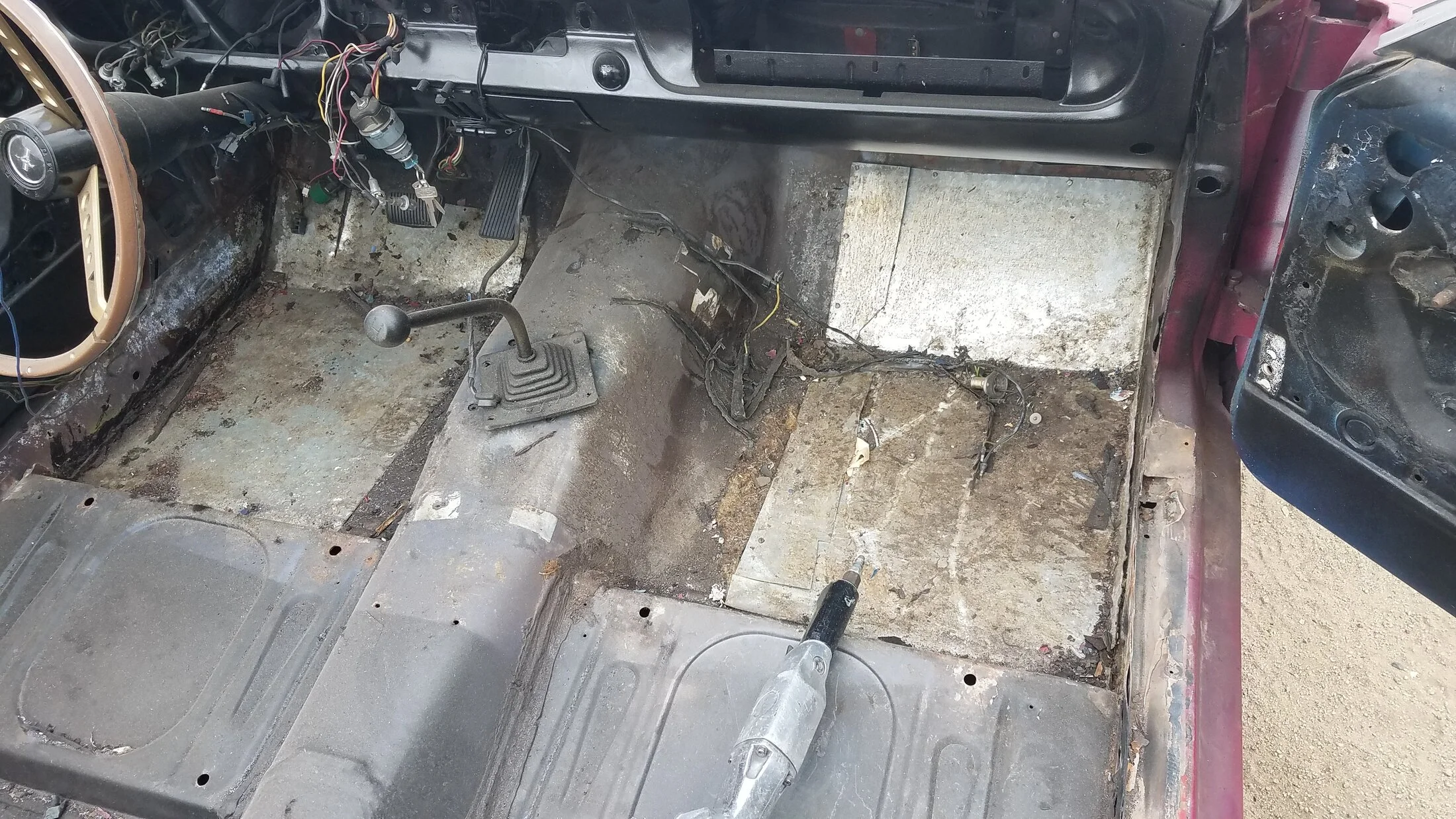

That was fun ! 18 gage sheet metal held in with flat blade screws ,the screws heads broke off and the sheet metal was glued in with tar ,going to be fun removing the tar but other than a few rust holes in the original floor pans it shouldnt be to much trouble .now i need to pick up some sand and blast a few areas and prime them
