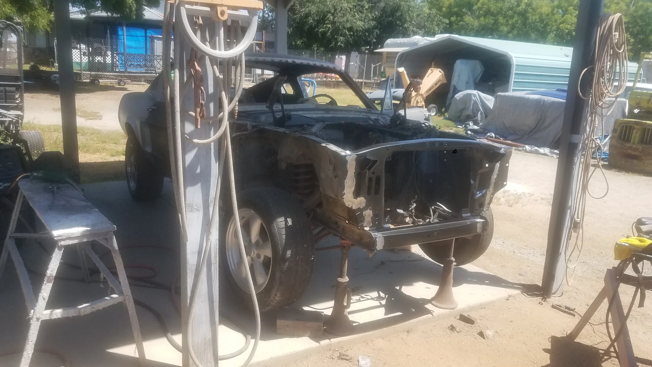

The radiator support is in ,took all morning because someone at some time did a bunch of welding and i had to cut it all loose . I will probably do the little patches above the spring towers on the inner aprons next ,then on to the floor patches .

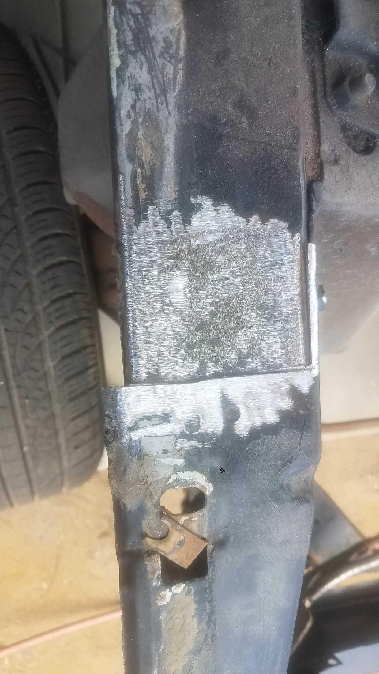

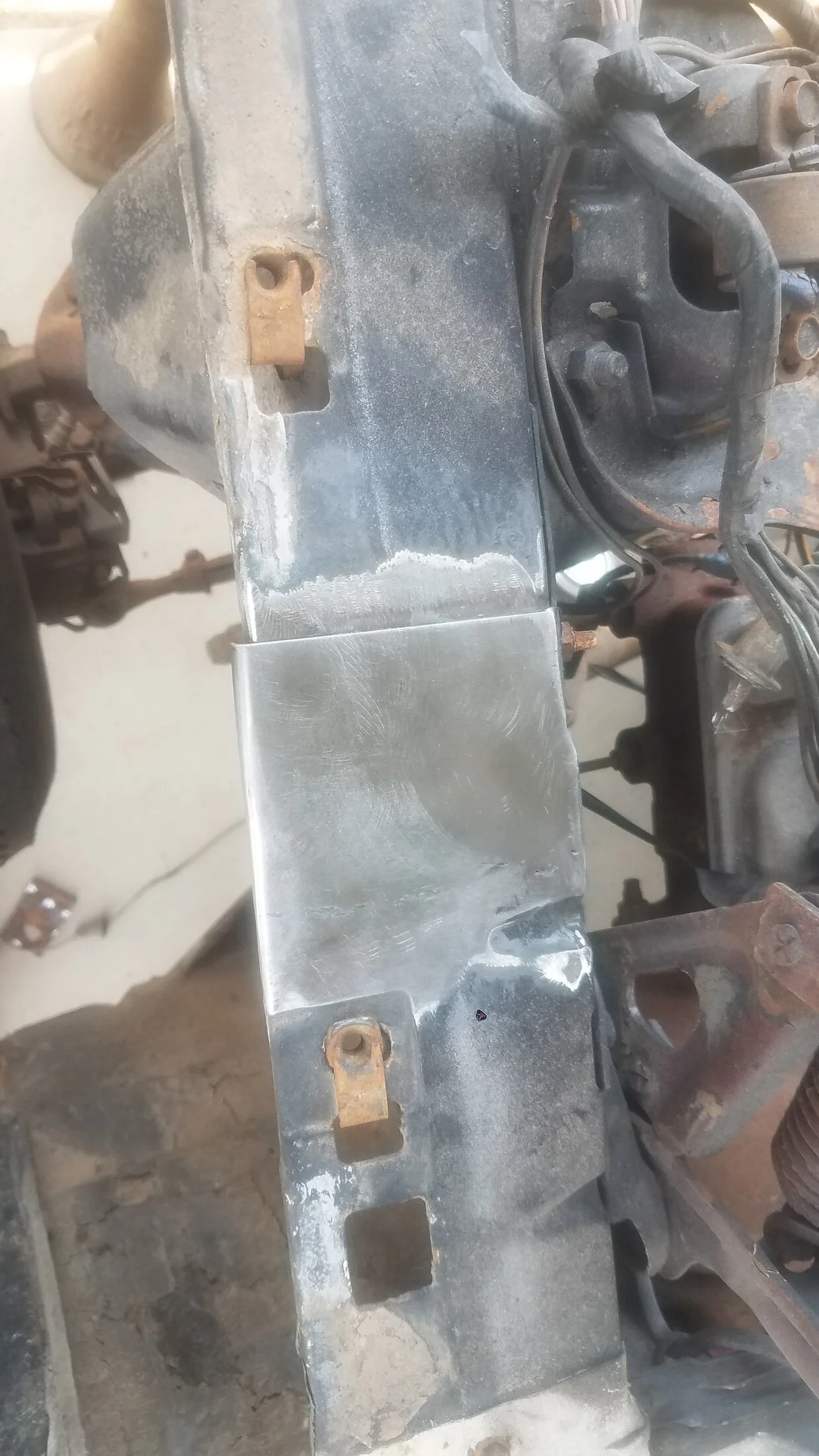

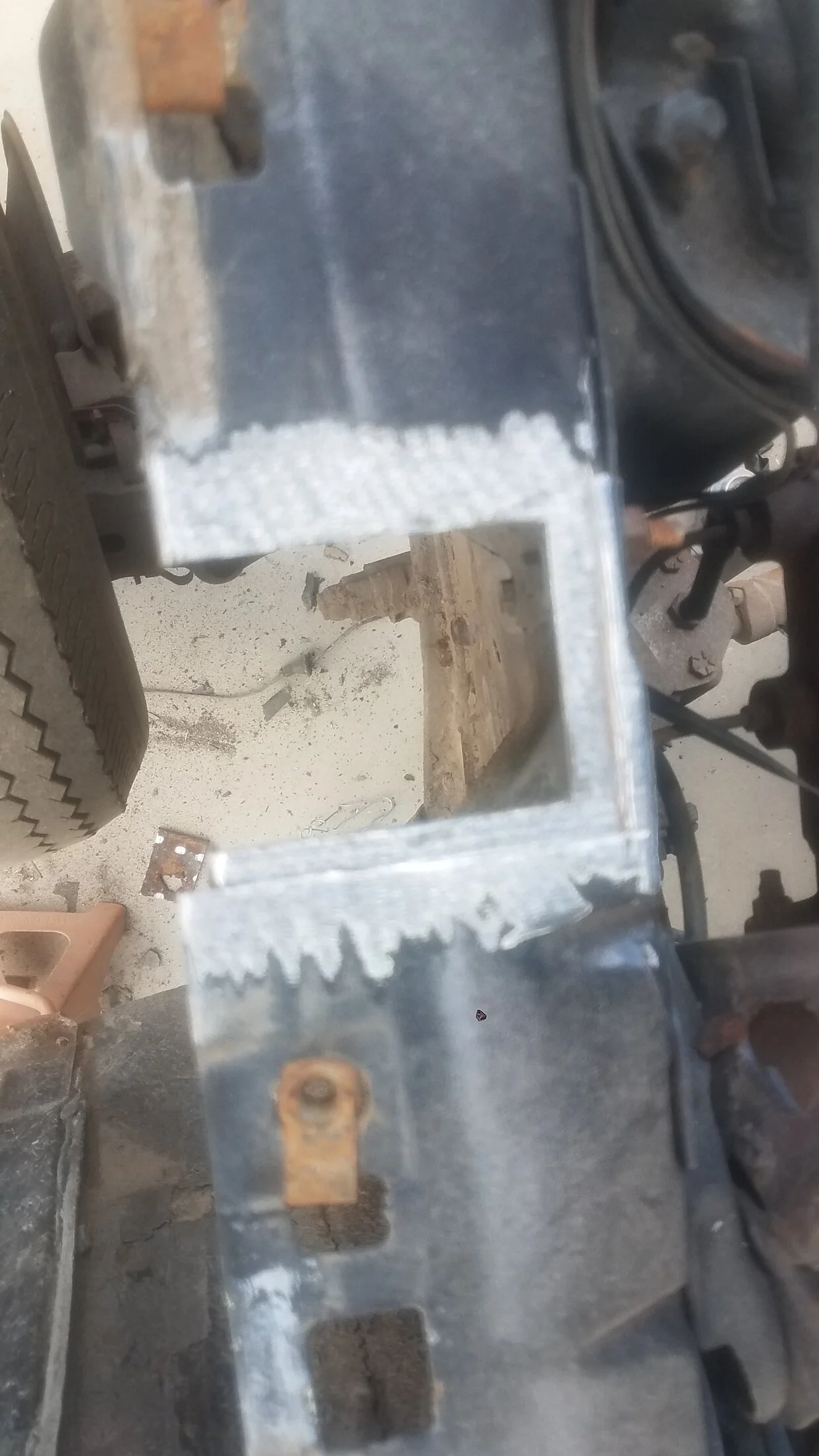

I cut the rusted pieces out of the aprons ,now to make the patches.
This is a pretty common place for rust in 67 70 .

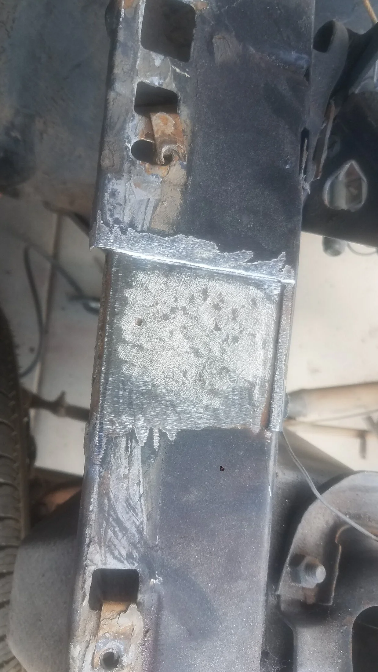

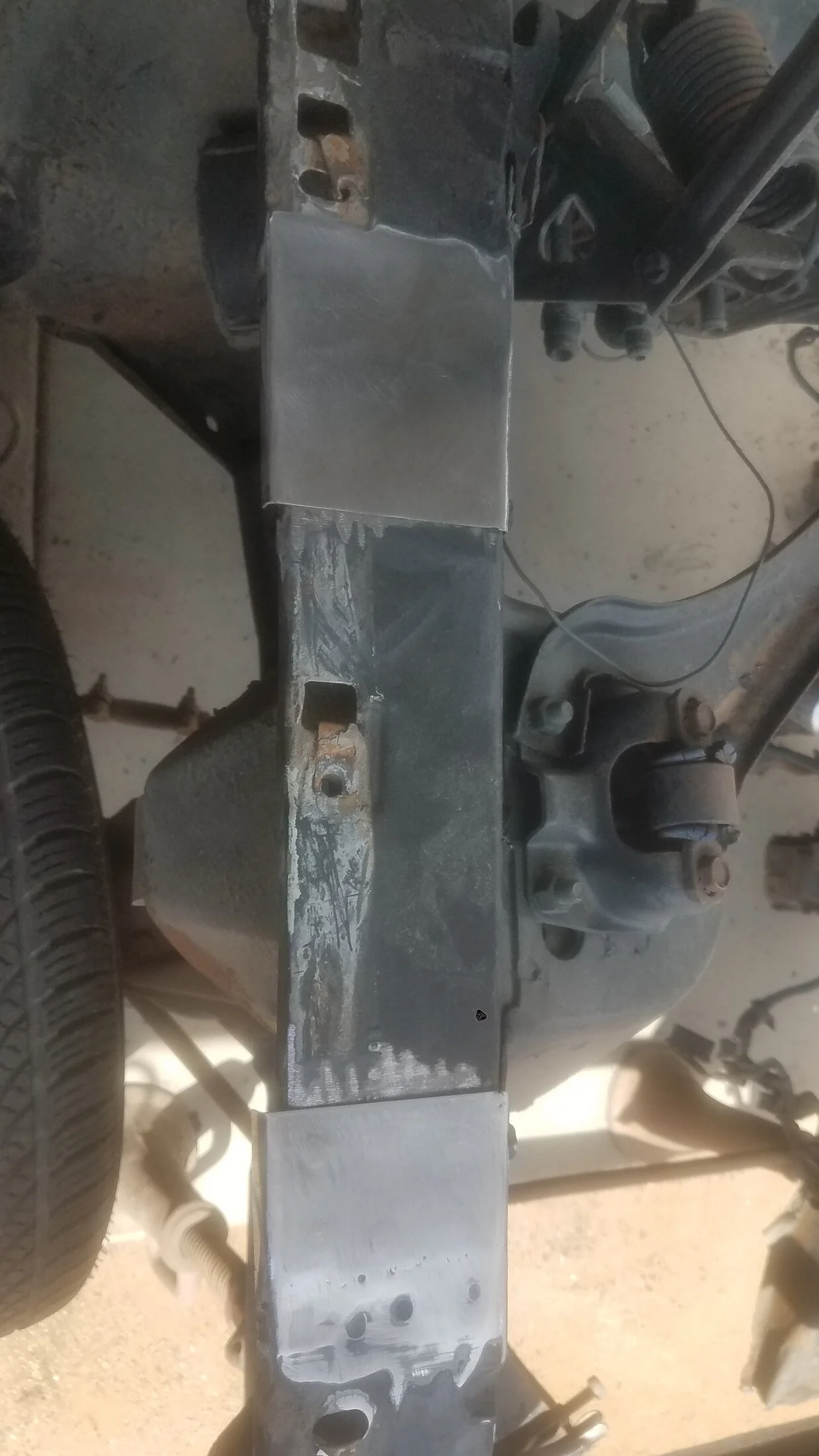

All three patches in the front aprons are finished . Just some brackets inside and the floor patches and grind the welds left .
