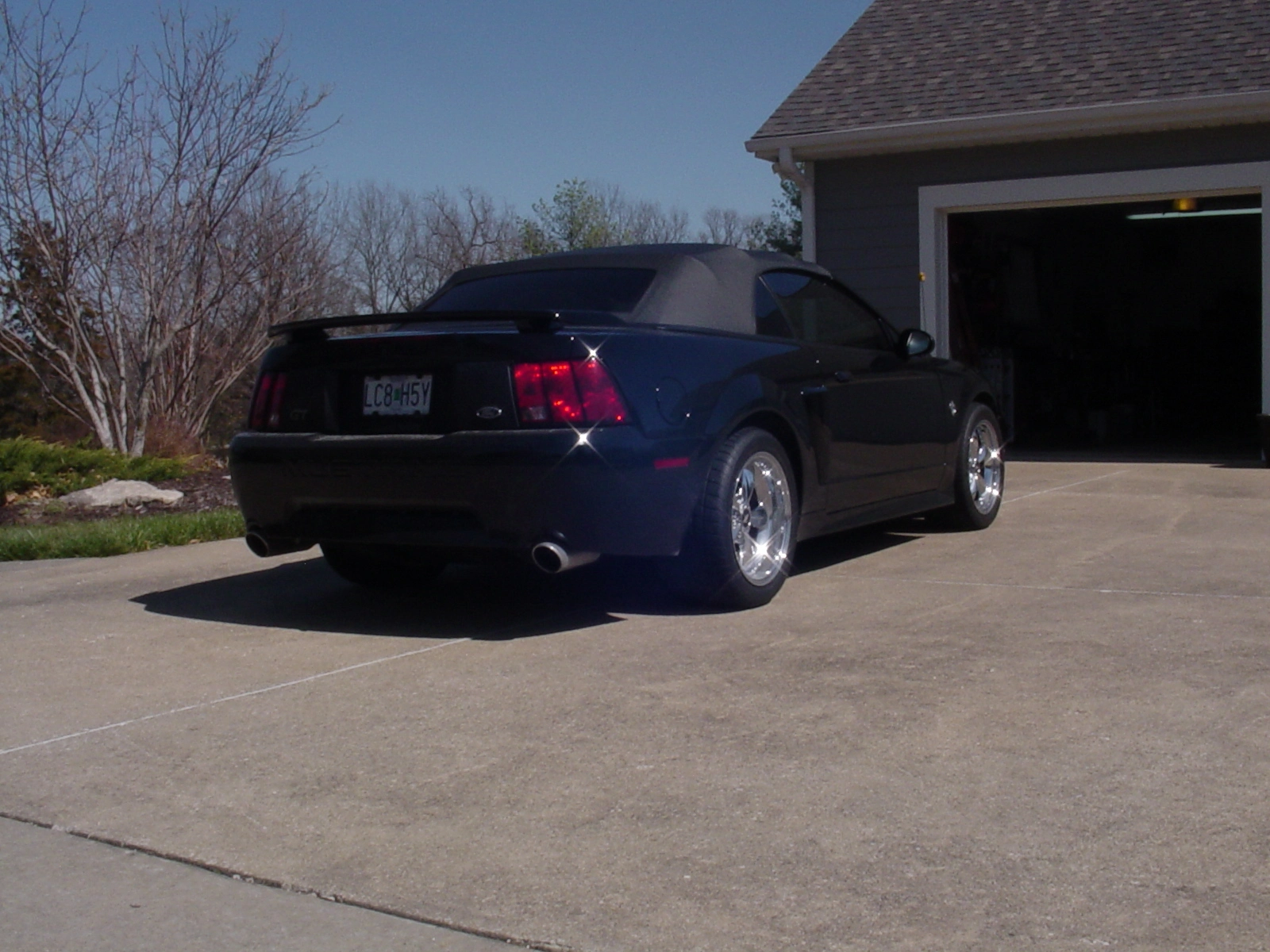

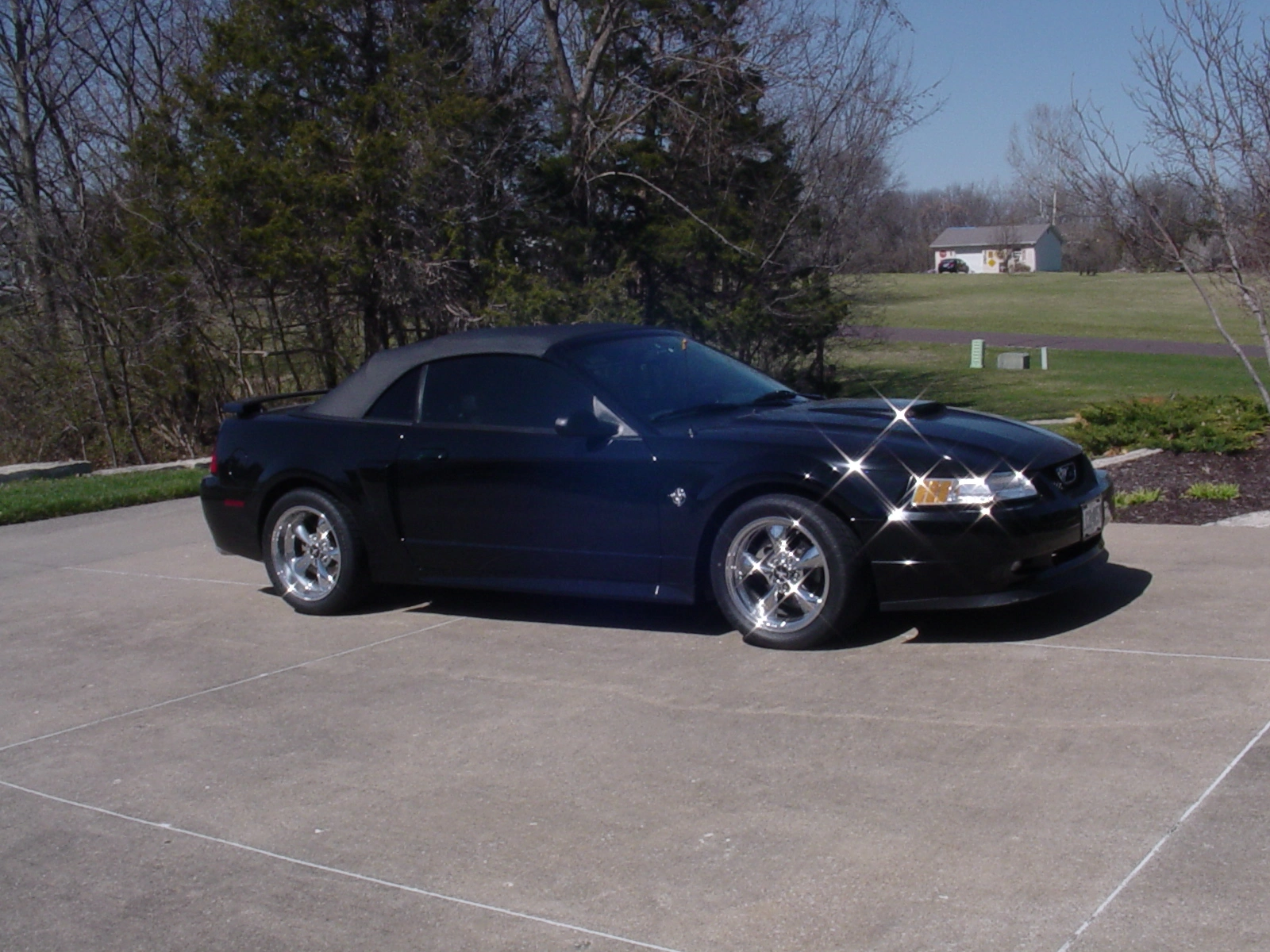

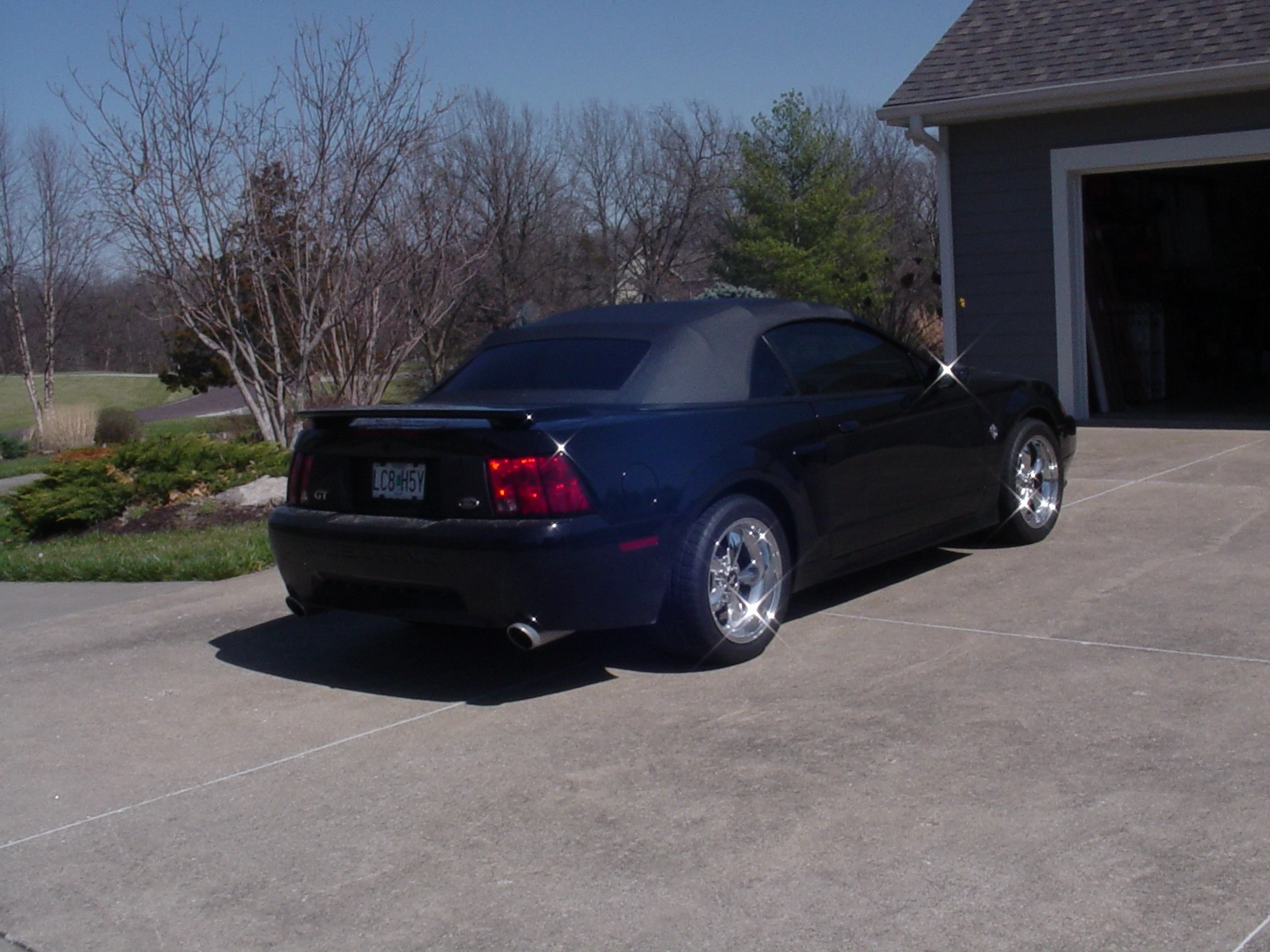

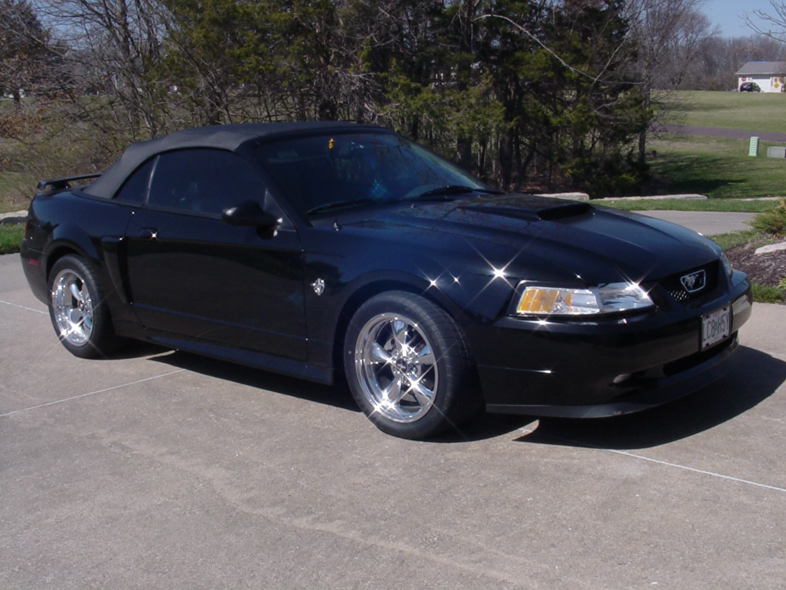

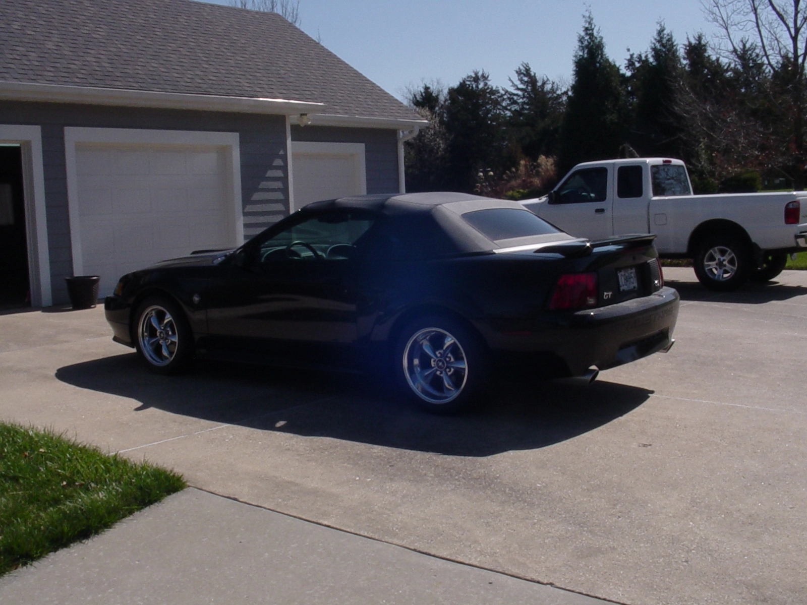

pics of the car?
just took this ... I'm not really set-up for digital stuff

trying this out ... don't normally tread in the unknown (when I can help it)
