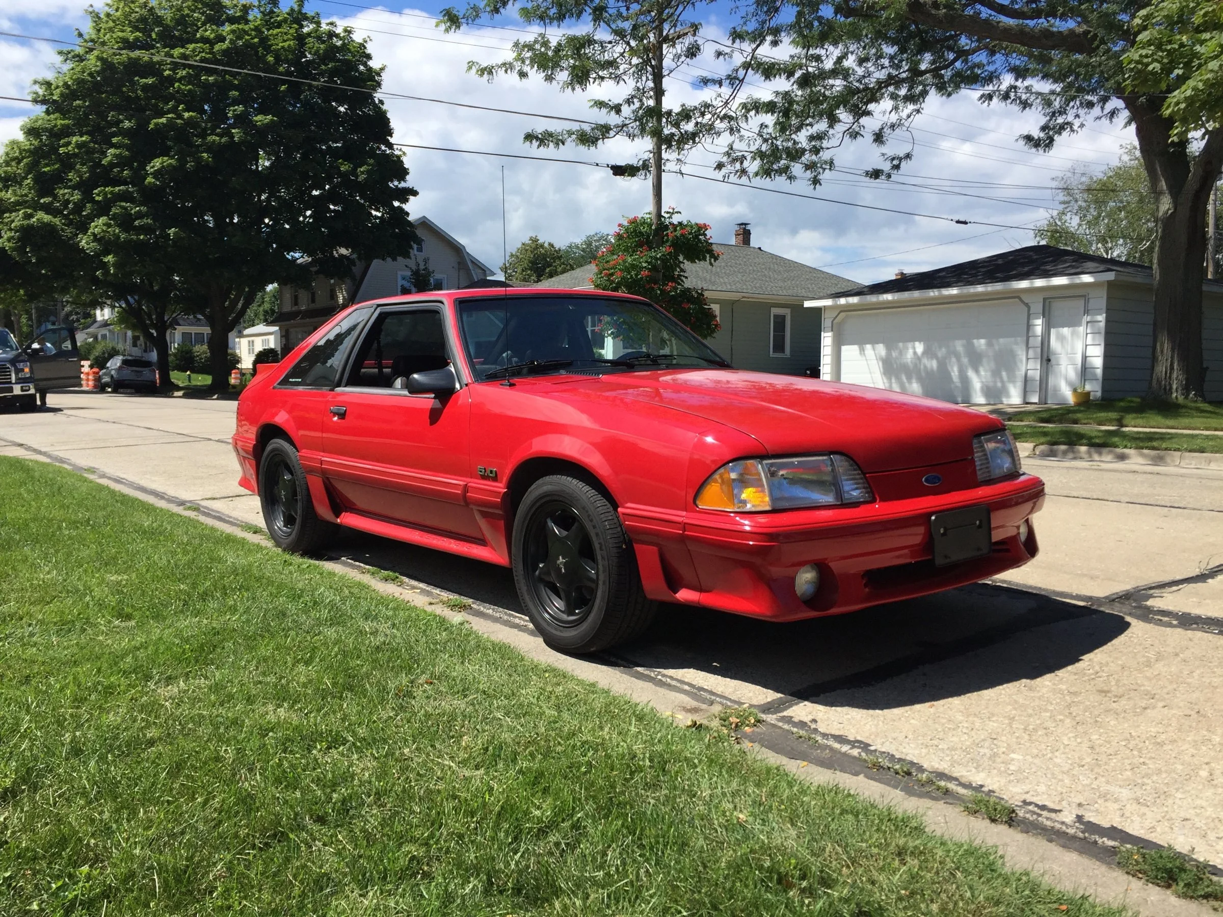

So my new 90 GT has crappy paint. Some areas are totally flat but a good portion of the car is just heavily oxidized. So I figured I would try my hand at buffing it out. As a previously ASE and Ford certified automotive technician I figured I could hack it.

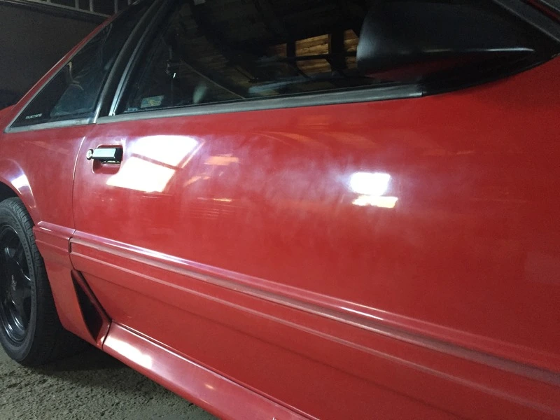

I prepped the car by washing it. I used a claybar and detail spray, and then I buffed with Meguiars Ultimate Compound and a buffing pad attachment for my cordless drill. (not the right equipment I know)
The results, as you can imagine, are about as bad as this plan...
The car has a lot more shine to it, but it is definitely swirl scratched.
So my questions are:
1. How (if at all) can I fix this monumental mess I have made? Clearly a real orbital buffer is in order but who has insights in technique.

That's really not such a mess at all.
If you read through Dan's link, you'll see that it's a three step system to polishing a car. That's similar to what I do at work.
First thing, red is like black, it'll show swirls reallly bad. I think you've figured that out already though :jester:.
Second, reds like blacks take more effort to remove swirl marks.
Third, though you're problem can be easily fixed, it'll take you a good portion of a day to fix.

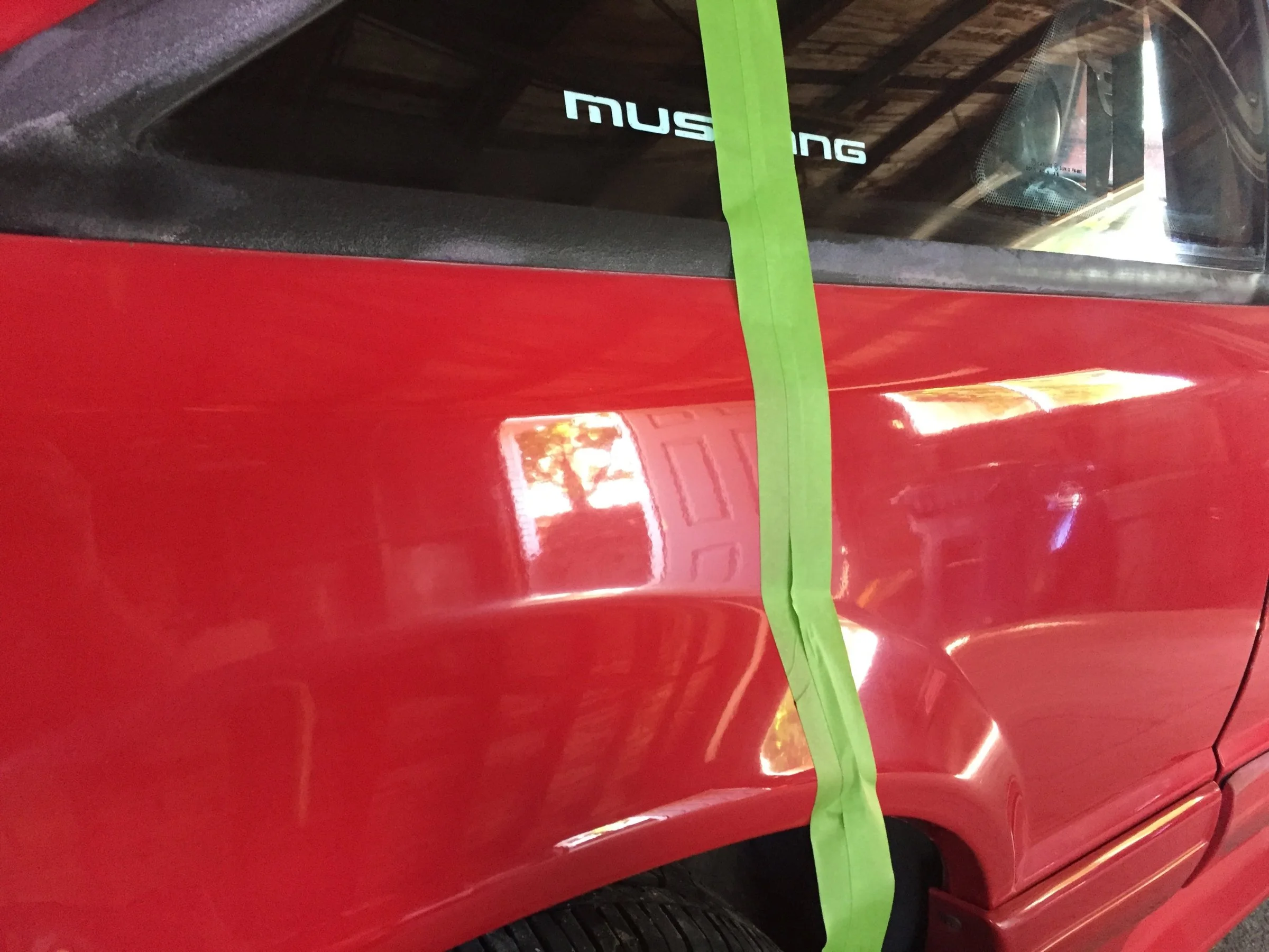

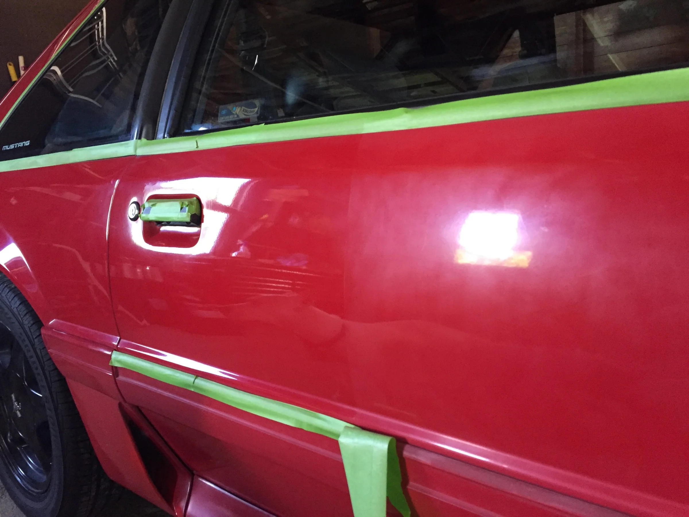

I ended up getting some of the Meguires Swirl Remover 2.0 Polish and hitting it with a microfiber pad and a little elbow grease. Those great results are all by hand!
When I went to order one of the kits online the wife caught a glimpse of the price tag and started asking questions...
So as a compromise I decided to try it by hand first just to see if I could make it any better before ordering.
I'm still going to get a DA polisher but this was a nice way to get her cleaned up and out on the road.
