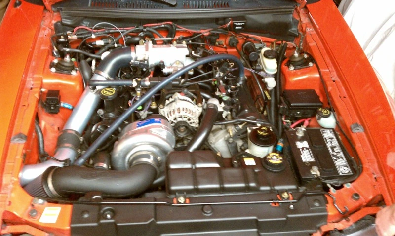

With my 00 GT a long time ago I went with the p1sc procharger intercooler setup it made good power at 11 psi 440rwhp and then blew it up cause of stock internals I really did like procharger
