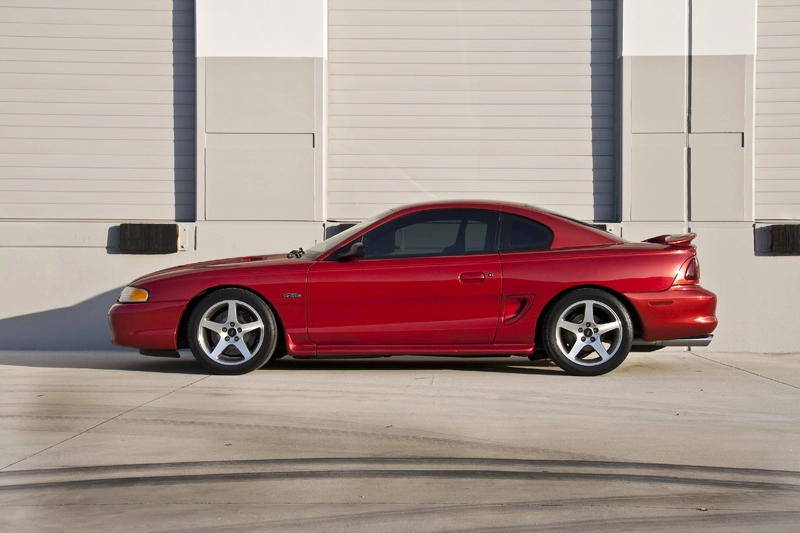

is this too low for you?
What suspension are you running? That car sits PERFECT imho.

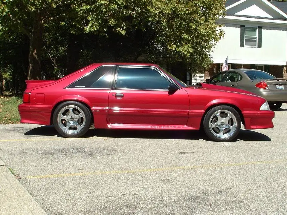

That car does look good. Reminds me of a car I featured in 5.0 Mustang a few months ago:
^^UPR Pro Series suspension front and rear. That's a very smooth and comfortable street/strip car. (runs low 9s in the quarter)

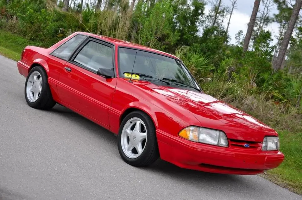

March of 2011 issue.
That car looks absolutely sick.
That fox of your's looks sick to. Keep up the good work :nice:
