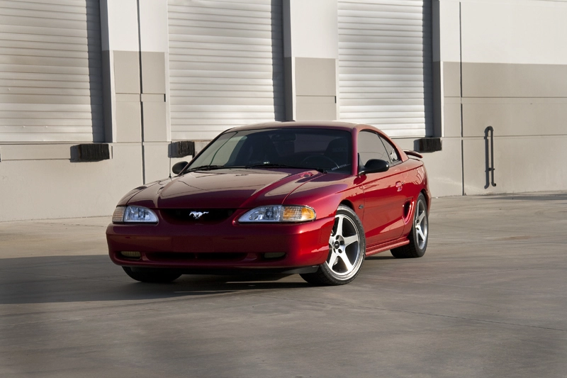

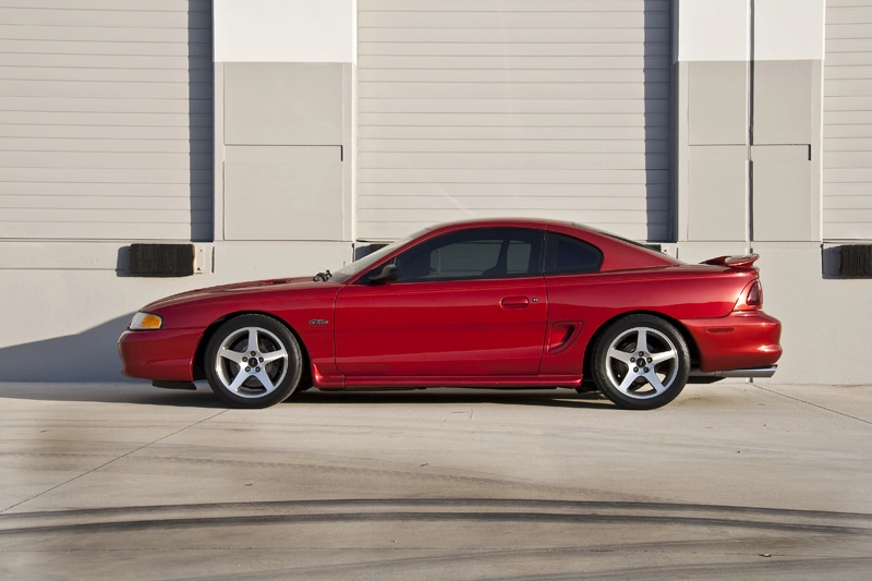

is this too low for you?
:drool:
No such thing as too low when it comes to looks. I'd LOVE to have my car that low, but with the 80 gazillion speed bumps I go over daily, along with the ins and outs of driveways and the man-eating sized potholes around here, I'd tear my mid-pipe out in a week.

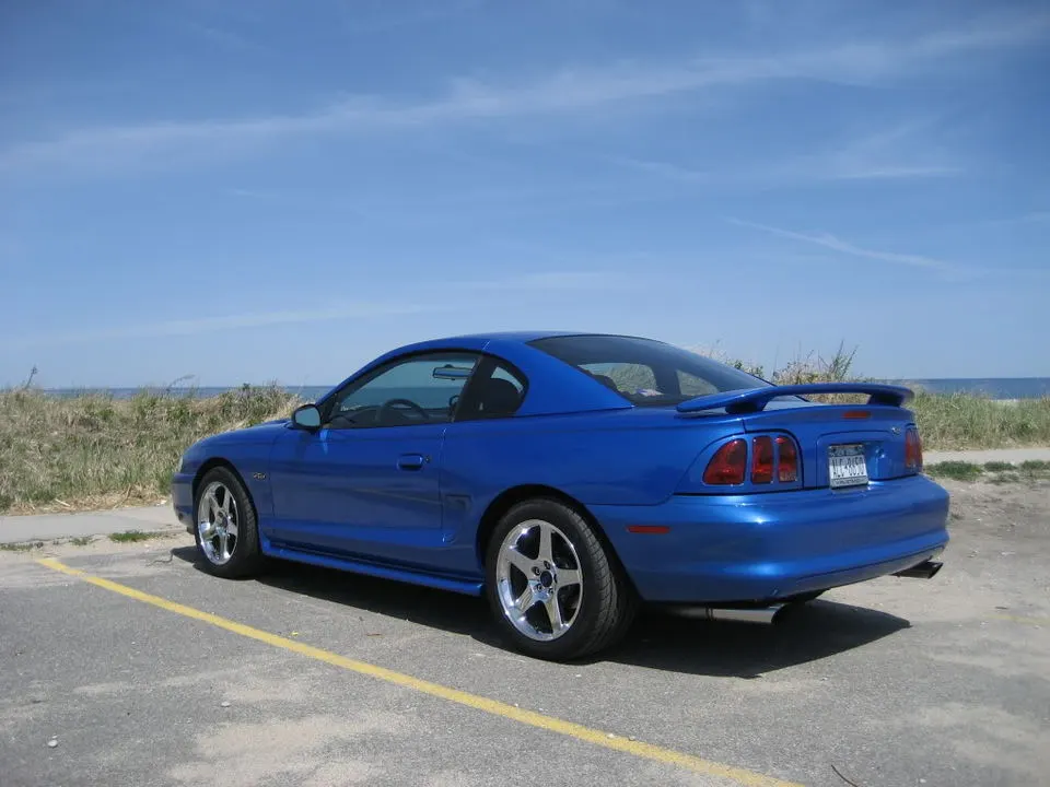

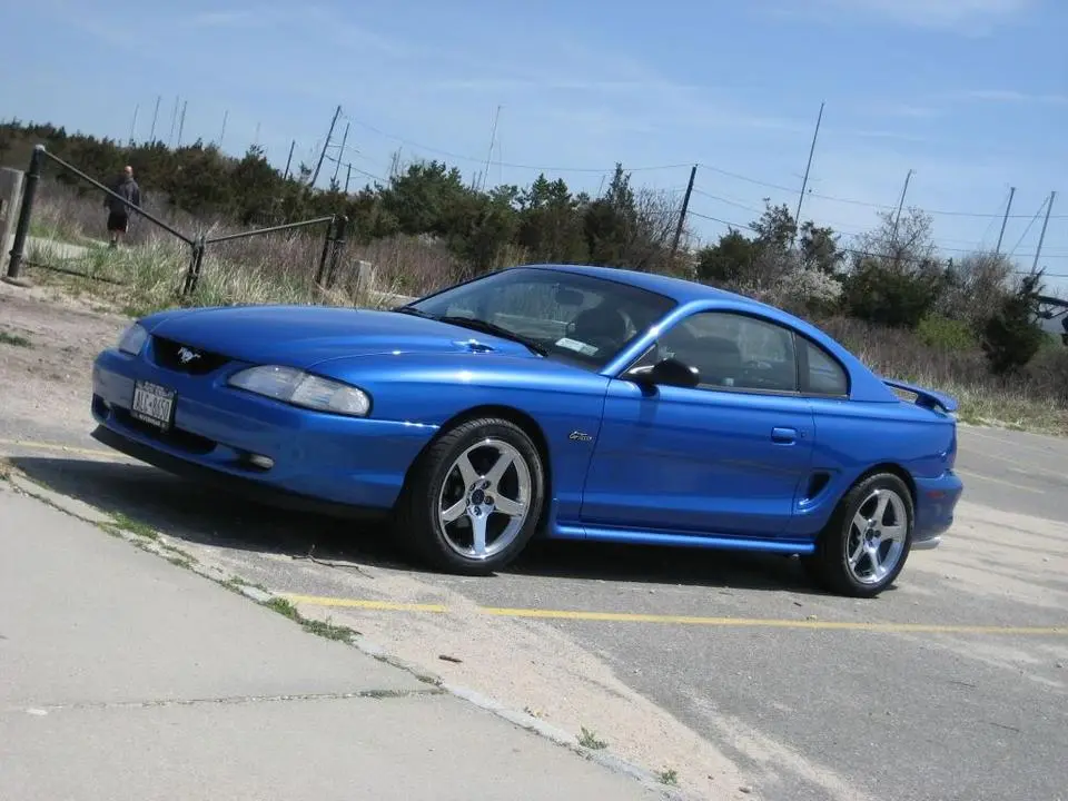

Here's an aero GT with the Bullitt springs (with a thanks given out to LI98GT for having such a great car to look at :nice:). I think it looks really nice and is a nice in-between for looks, ride quality, ride height, and performance.

the blue sn95 looks damn near perfect
Yup, 20% tint all the way around and it would be perfect. I love that color and stance.
