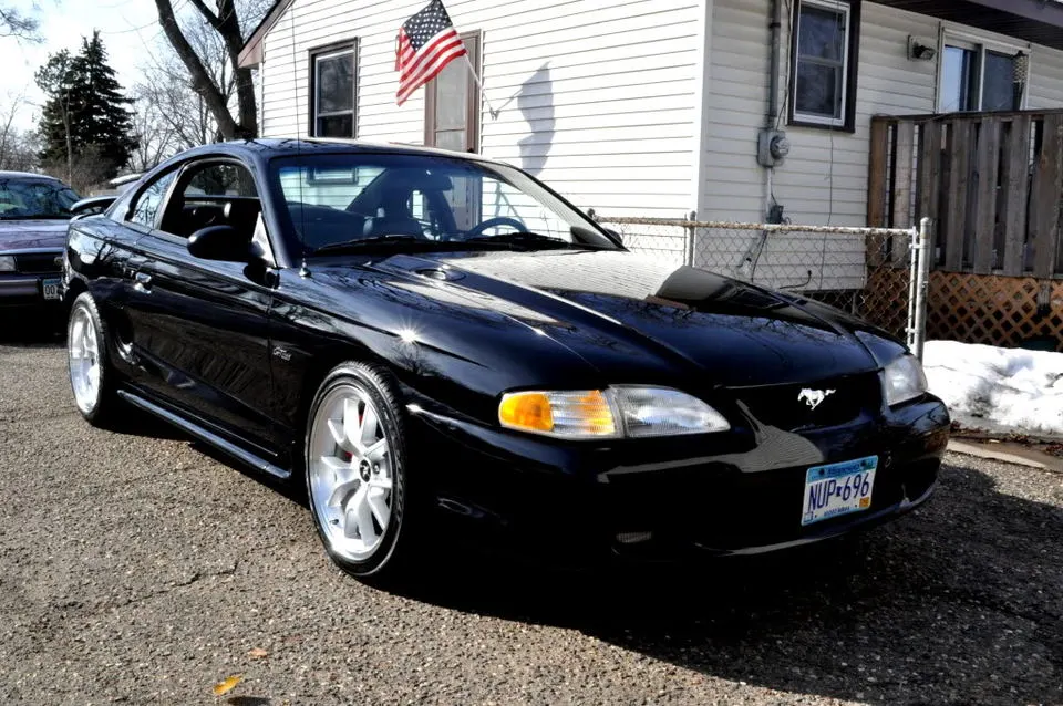

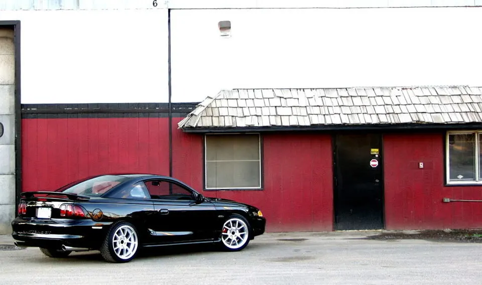

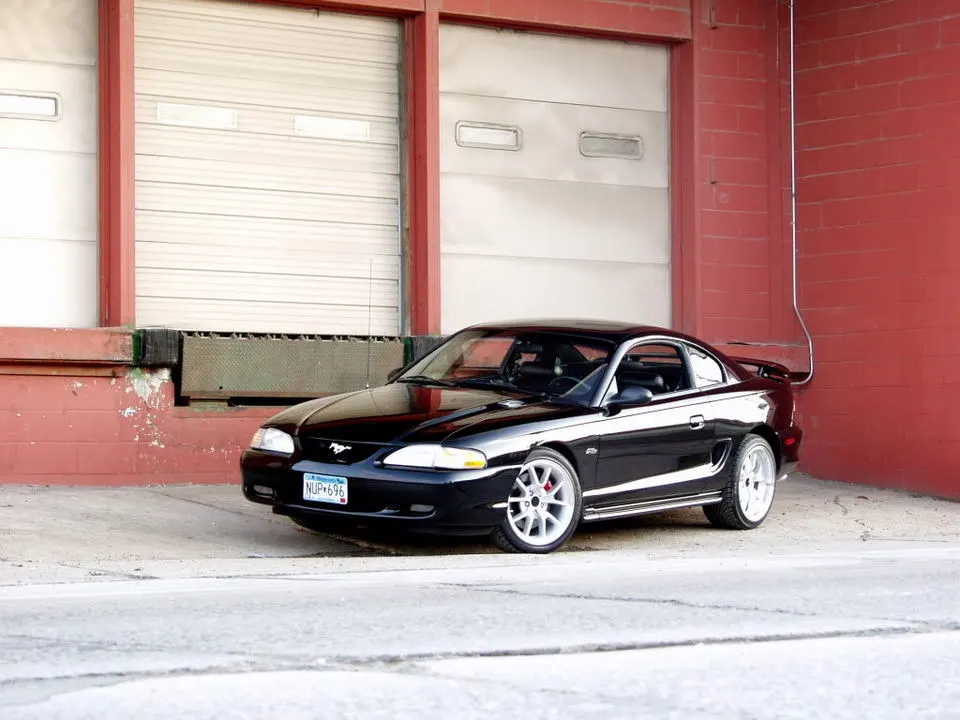

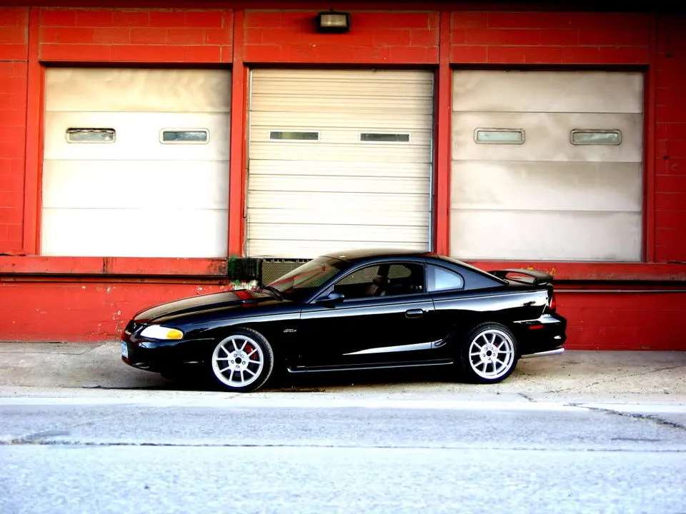

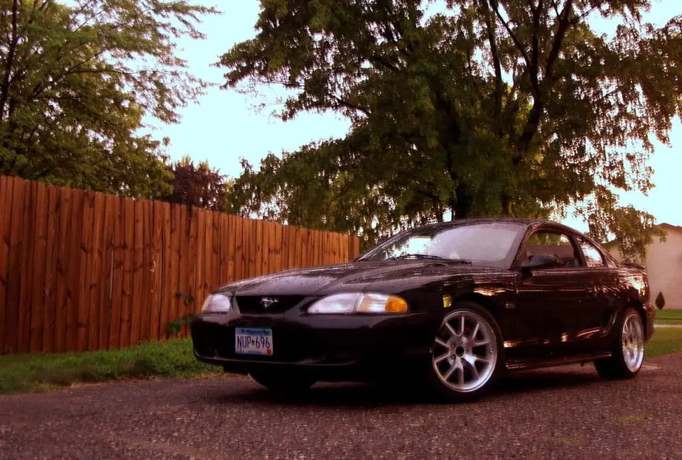

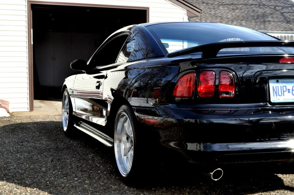

SURE! BTW, I hadn't removed the rear ISO's yet in these pics...

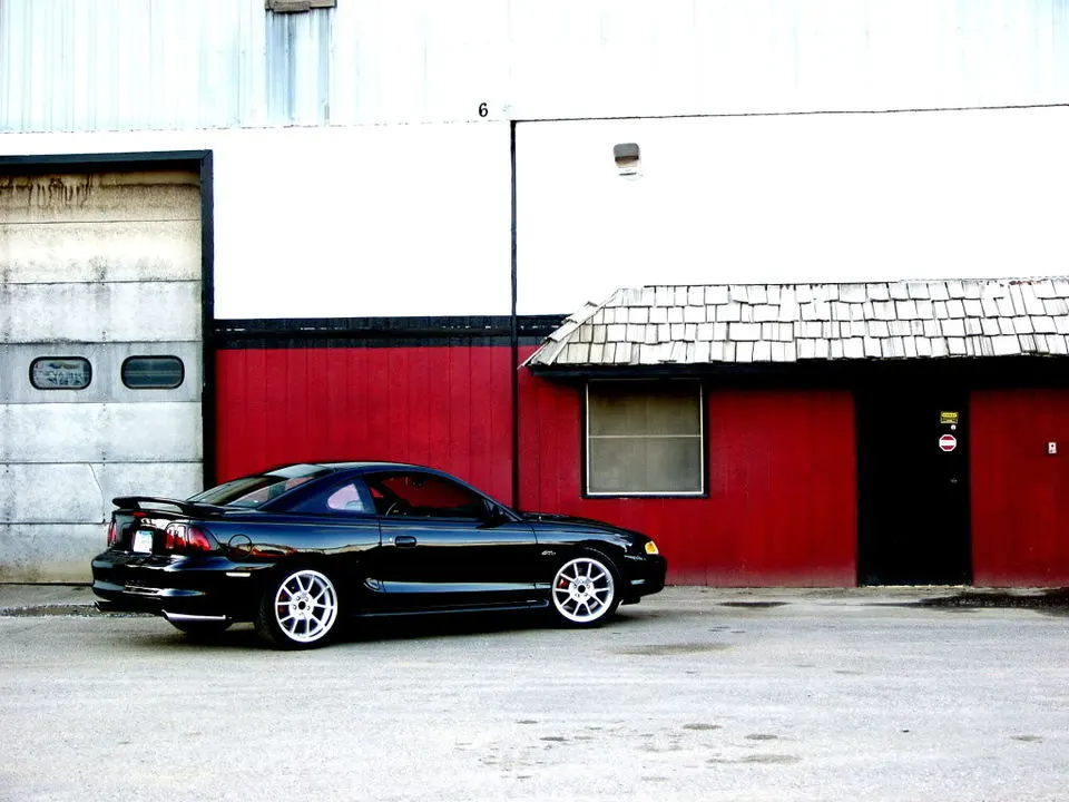

In the following pics I have 285 rear tires as opposed to the 265 rear tires in the pics above.

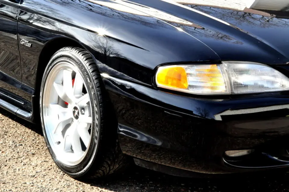

What suspension are you running? That car sits PERFECT imho.
-Eibach Sportline Springs (No ISOs in Front)
-Tokico 5-Way Sport Shocks
-Suspension Techniques Front Sway Bar
-OEM Ford Cobra Rear Sway Bar
-Steeda Adjustable Rear Sway Bar
-Suspension Techniques End-Links
-Maximum Motorsports K-Member Brace
-Maximum Motorsports Subframe Connectors
-Maximum Motorsports Adjustable Lower Control Arms
-Ford Racing/03' Cobra A-Arms
-2004 Cobra Steering Rack w/ Poly Rack Bushings
-2004 Mach One Steering Shaft
-UPR Bumpsteer Kit with FK Chrome Moly Hiem Joints
-PBR/Cobra Caliper (Painted Black)
-Stainless Steel Braided Lines
-RotorPros Slotted Rotors
-Porterfield R4-S Pads
-OEM 17x9 2003/2004 Cobra Wheels (Machined Finish)
-275/40ZR17 Nitto 555
