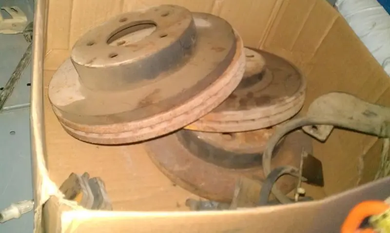

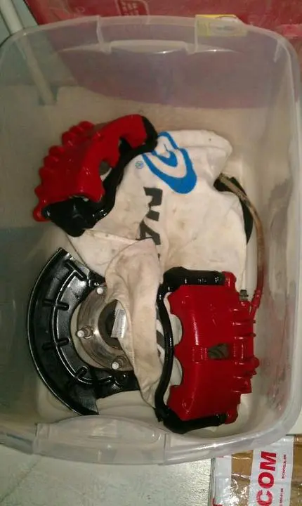

i guess i'll do a little update. i got everything in for the turbo kit, as well some 9333pt1 head gaskets, 1250s-3 intake gaskets, and some arp head studs to regasket and stud the top half of my engine. i also managed to pick up some 04 gt brake/5 lug stuff for $100 (i got twin piston front pbr's, rear calipers, all 4 good rotors, and 04 spindles) , so now i'm piecing together a 4 wheel disc 5 lug swap as well. i ordered 31 spline mosers and an eaton detroit truetrac. i also got a set of rear caliper brackets from a 95 gt and some front spindles from a 94 v6 car.
what do i need as far as master cyl, prop valve, brake lines, fittings, etc? i've done searches online and have read many opinions and what not, just seeing what you guys think. do i need the steel braided line kits for the front and rear from maximum motorsports?
I would also ditch the 04 spindles. Not because of the track width, but because of bumpsteer issues with 96+ spindles on a fox with the stock k-member. The steering geometry will be all out of whack. Unless you want to invest in a MM k-member, get a set of 94-95 spindles.

way ahead of you guys, i already picked up some spindles off a 94 v6 car from a salvage yard. i will be selling the 04 spindles. what about the rest of the stuff needed? should i do a 94/95 booster/master cylinder, or can i just get a 93 cobra master cylinder and use it with my booster? 3-2 conversion? are the braided line kits for the front and rear from maximum motorsports the best way to go?

okay so i have another question...i've been looking at the MM stainless hard line and 3 braided hose conversion kit for the rear of fox's doing a disc swap using sn95 calipers, but i can't tell if the braided caliper hoses will work with 04 gt rear calipers. i see they sell the rear braided caliper hoses for 94-95 cars by themselves, but they do not for 96-04 cars. does anyone know if the hoses will work with my setup?
here is what i'm talking about:
http://www.maximummotorsports.com/s...roduct_info&cPath=49_144_469&products_id=1438
Sn95 calipers means 94-04, not just 94-95. You should be fine with that kit. I do see what you are saying about MM not selling a 96-04 rear brake line kit by itself though, only 94-95. I know that in 96, the hoses became body mounted, and not axle mounted, but the fluid bolt for all the rear calipers should be the same. Just the mounting changed.

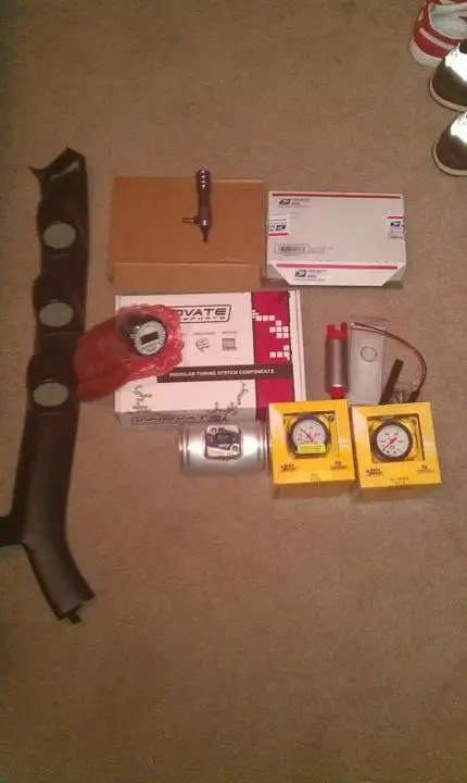

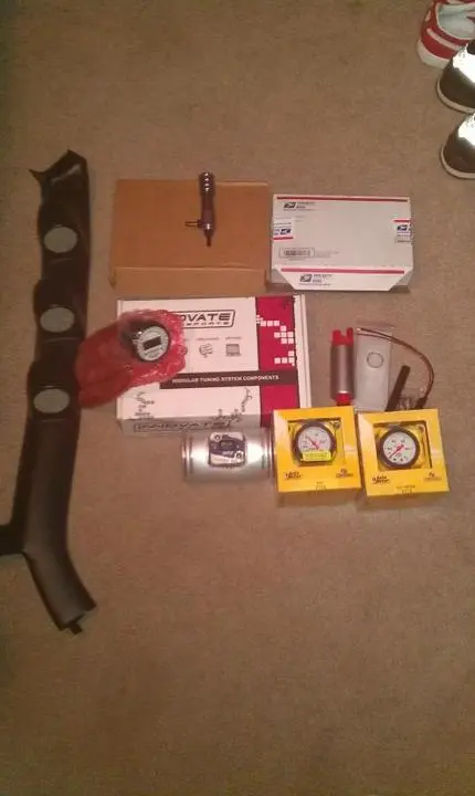

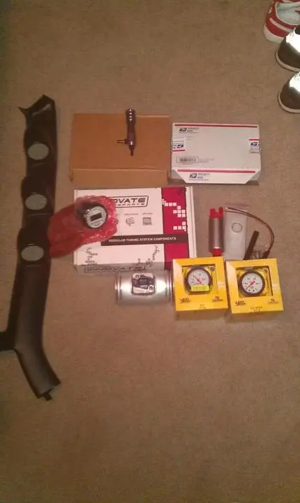

hallman pro boost controller, 42# injectors in white usps box, innovate wideband, 340lph fuel pump, PMAS HPX slot maf in a 3" tube, boost/vac gauge, fuel pressure gauge, triple pillar post pod

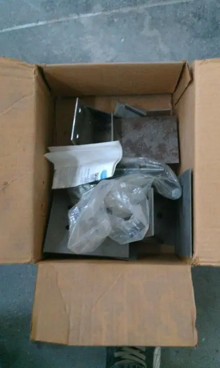

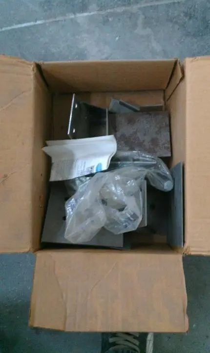

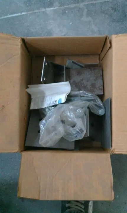

SMR torque box reinforcements

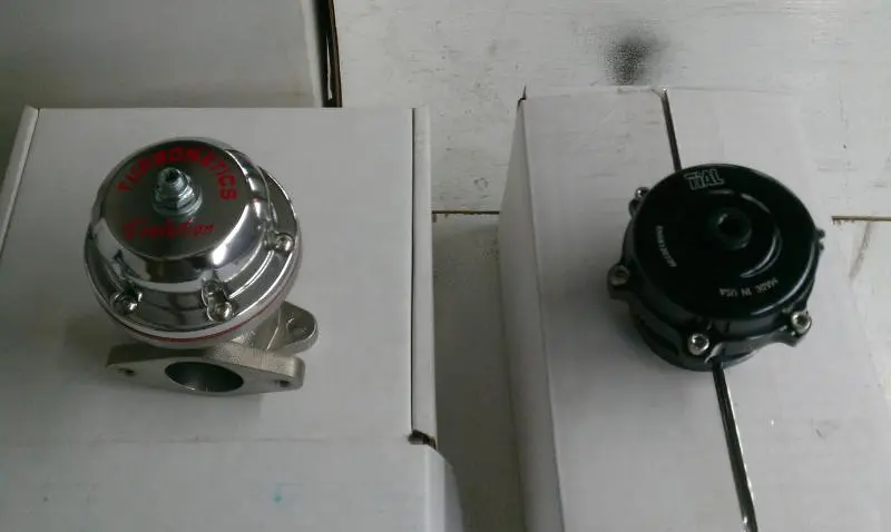

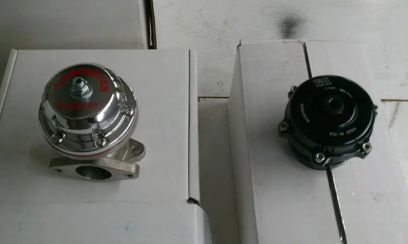

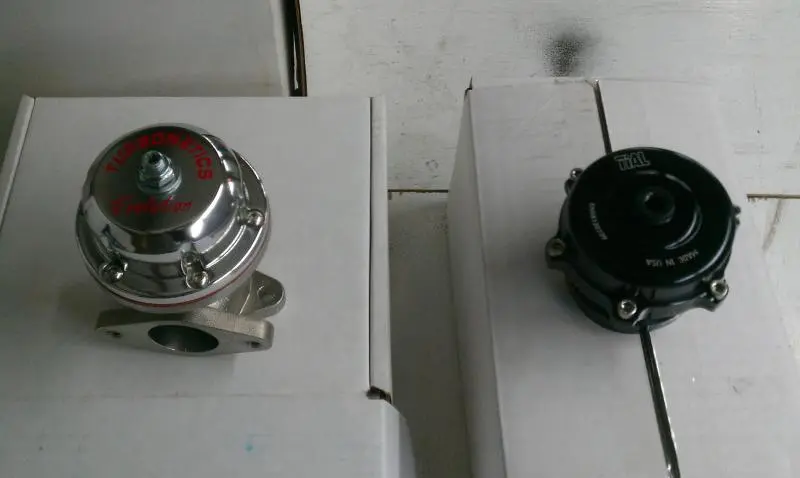

tial Q bov and turbonetics evolution wastegate

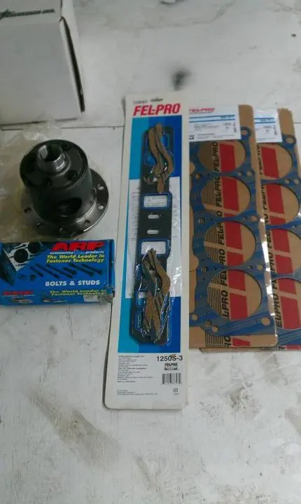

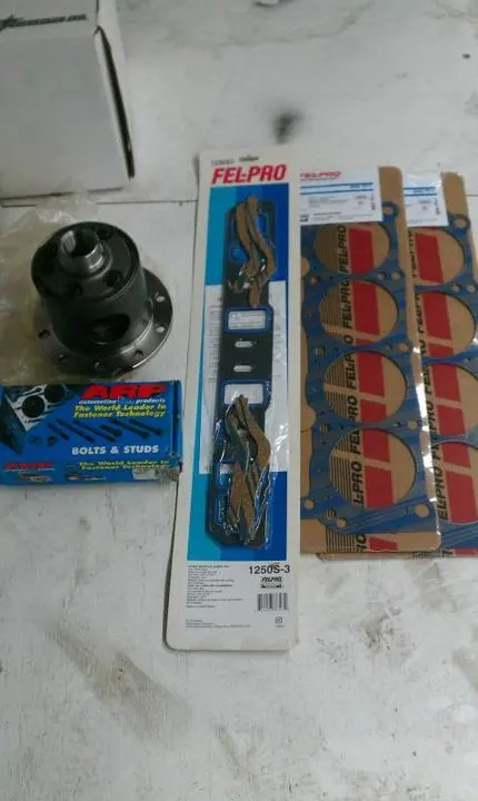

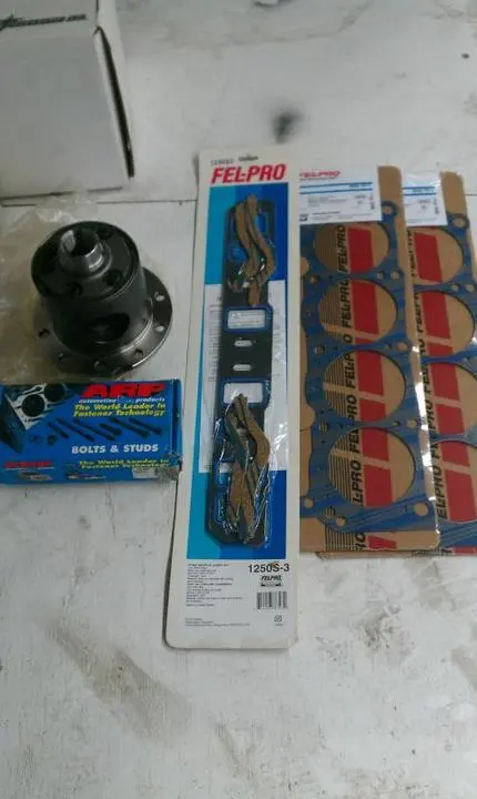

9333pt1 head gaskets, 1250s-3 intake gaskets, arp head studs, and 31 spline eaton truetrac

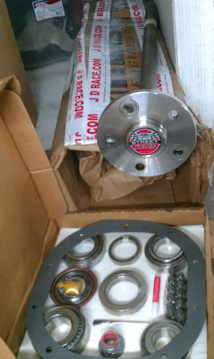

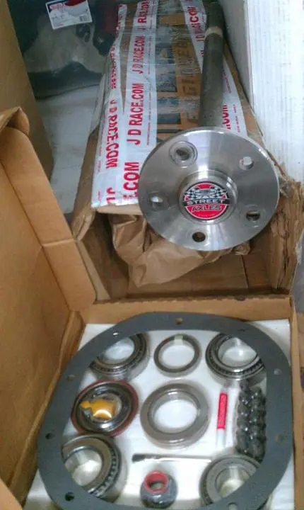

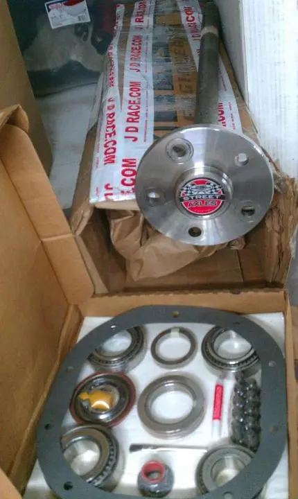

31 spline 5 lug moser axles, install kit

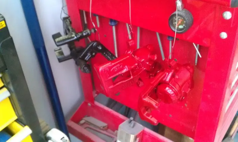

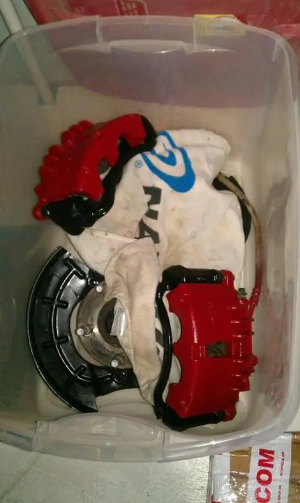

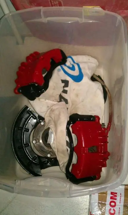

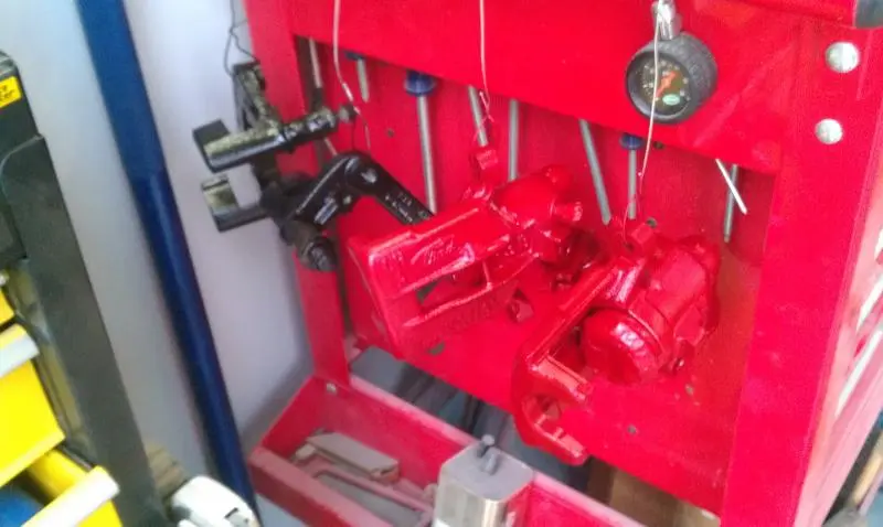

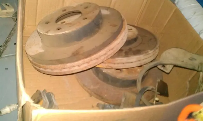

04 gt front calipers and 94 v6 spindles after cleanup and paint (hoses are being replaced with MM braided hoses)

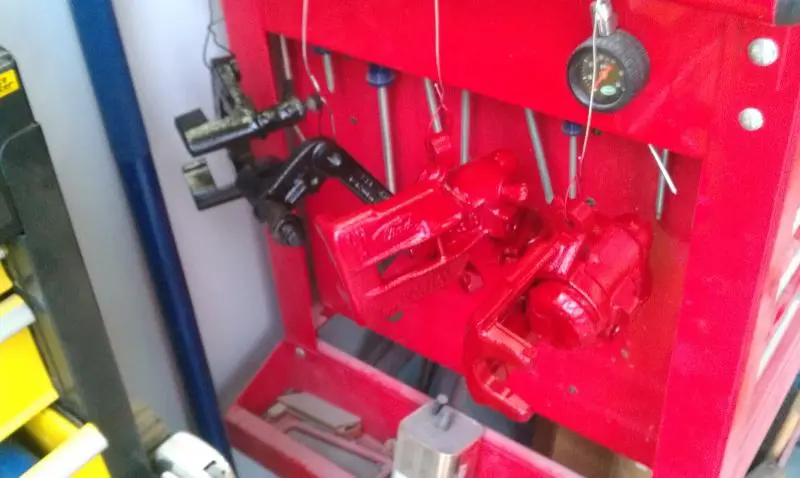

04 gt rear calipers freshly painted

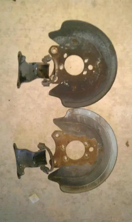

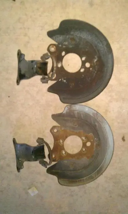

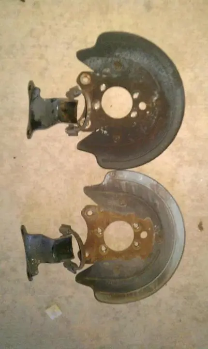

sn95 rear caliper brackets. they will get modified and freshened up when the time comes

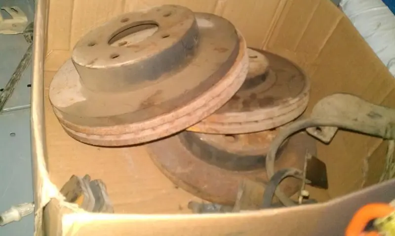

front and rear rotors. will get freshened up as well

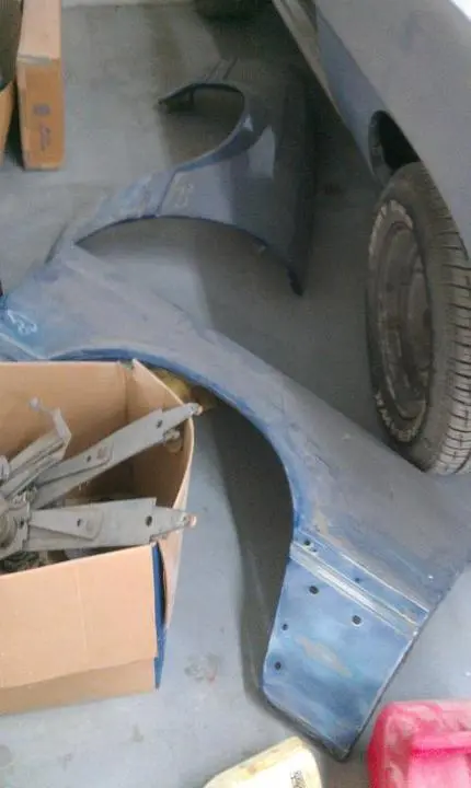

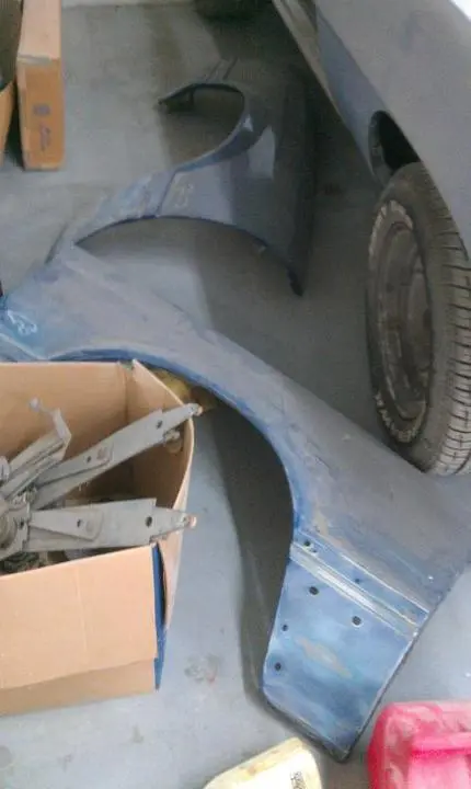

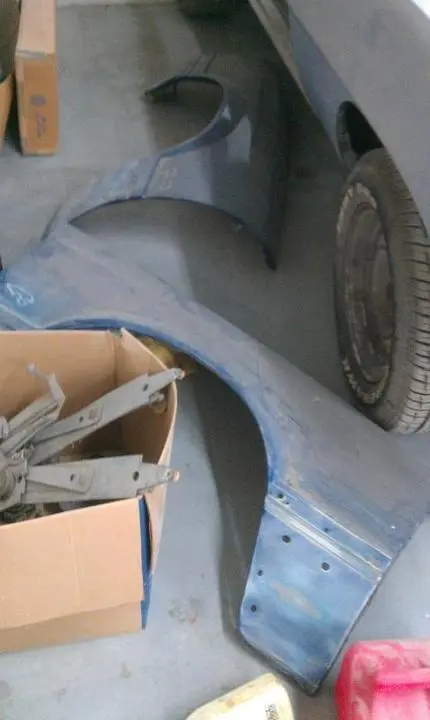

new to me 91-93 fenders

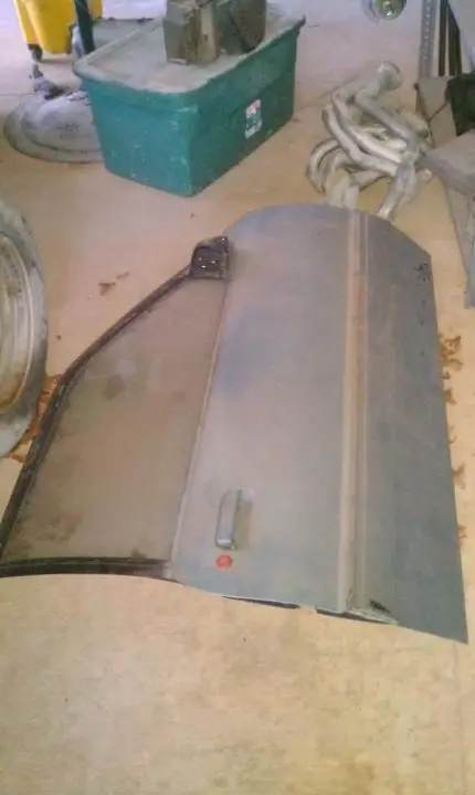

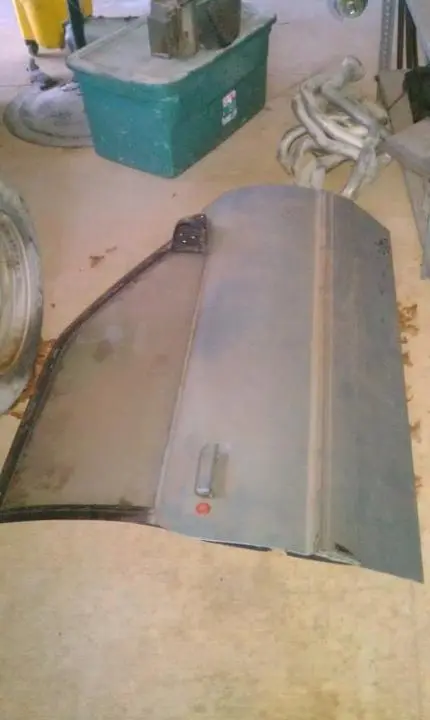

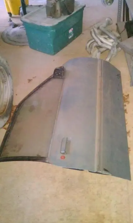

new to me PS door

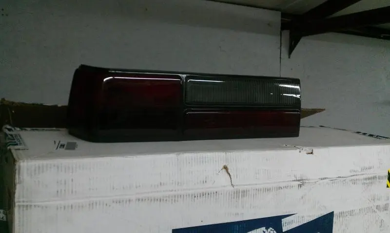

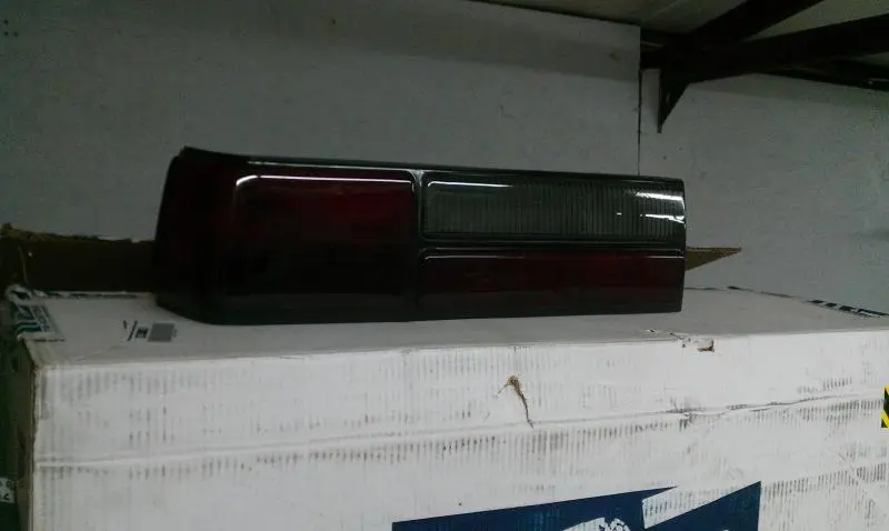

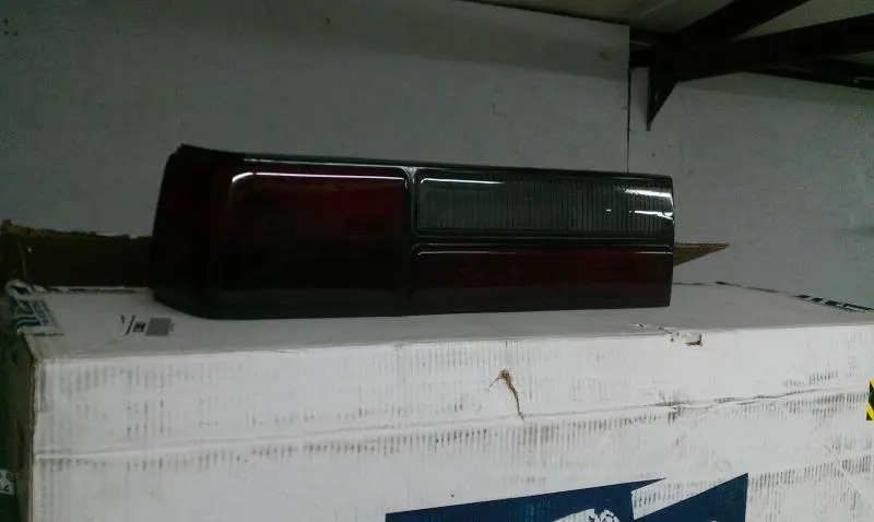

i've had these tail lights for a long time, i sprayed them with vht niteshades a long time ago and used to run them until i put my cobra tail lights on. should i stick with my cobra tails or put these back on?
