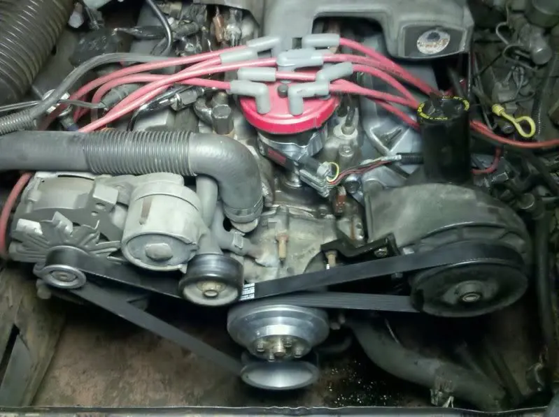

Looks so much better, hopin to pick up a little power and after my electric fan install its time to hit the track again in March. Minus longtubes, its a full bolton car.

Does look smuch more open, but for power gains...not much if any to be had.

I realize that but everything counts when I'm out to go as fast as possible on stock motor.

Im still thinking about doing this, just havent had the extra coin lately to order everything i want!
Any idea how much weight you took off the nose?

I think I took a good 40 pounds at least off the front. With both pumps removed and what not. I want to weigh it so I'll get around to that and post it tomorrow.

i did the same a few months ago. definitely looks much better under the hood. did my longtubes at the same time.

Anyone have some pics of how the two FMS brackets bolt up to everything?
I got my brackets today and thought there might be an exploded diagram or something that shows how it bolts up but there was not. sposta be nice here this weekend (well, in the 40's) i might try to get time to mess with it this weekend.
