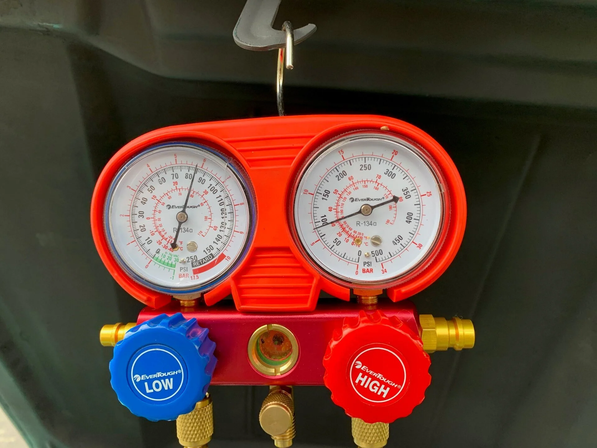

Here is my static pressure at 80 degrees:

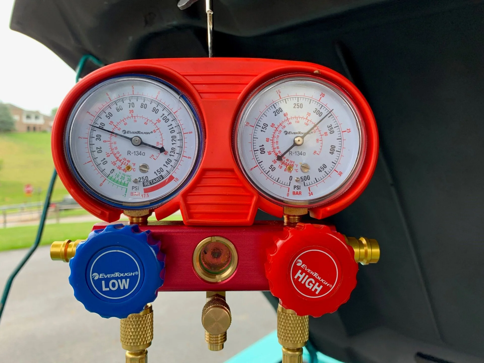

Here is my running temps... Low side stayed between 30 and 40 but high side jumped to 210 but kept climbing and climbing until I shut it off at 340.

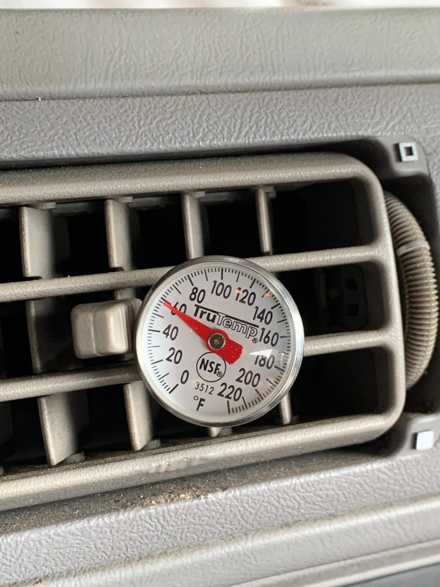

Here is what the vent was saying:
I have no clue what to make of these numbers... Really hope its just overcharged:shrug:
Ran the system for about 10 minutes at 1100 rpm with my massive shop fan at full blast blowing into condenser.
Update: Tested the system and while running some water over condenser to cool it. Pressure went back down to where it should be so my problem was airflow across it. Went out and bought an auxiliary fan and mounted it to the condenser. Set it up on a relay to activate off the compressor clutch. Blows 37 degrees out the vents now.

glad you found it. I was going to chime in when I saw your pressures and say that there are typically too causes of a low side pressure being too low, and hugh side being too high. One is overcharged, which I don’t think you were. Second is poor airflow through the condenser.
