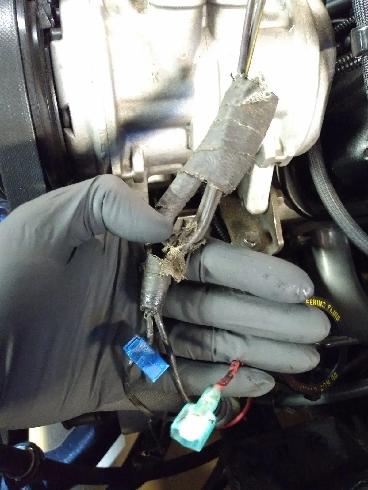

So I disconnected the ac compressor harness. Fan turns on and stays running like it should.
Then I look further down on the wiring. It appears someone connected a red wire to it. Not sure why they want the compressor running full time?
Either way, should I disconnect it? I might leave the whole thing unhooked for now. I never use the AC. Maybe delete it at some point.
They probably cross-connected it like that to bypass the safety switch due to either the switch or another component being bad. That was a bad idea on their part, because if the pressure in the system gets too high, you can have an explosion (though usually no fire unless the PAG oil hits the headers), and if it drops too low, the compressor can catastrophically lock up due to no oil circulation.
On a side note, @General karthief should be happy now.

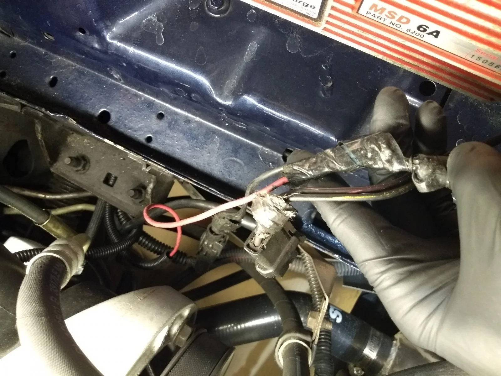

Makes sense. I just disconnected the red wire, hooked the harness back up to the compressor. AC blows cold, and the compressor cycles on and off, which I believe it's suppose to when I have the AC turned on. Stays off if the control is off.
Maybe I'll delete that red wire.
