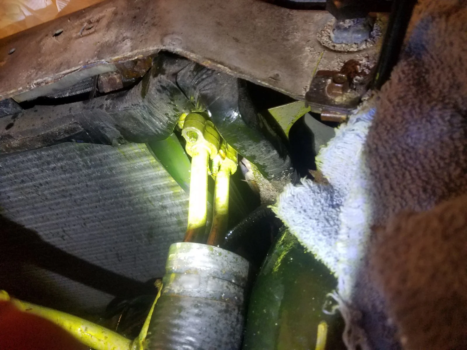

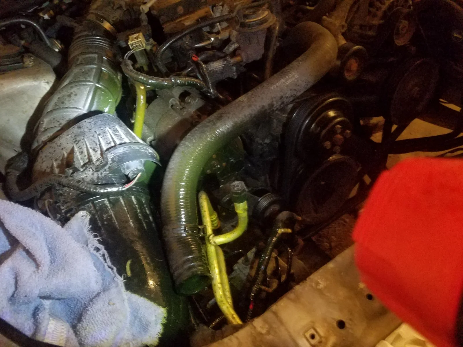

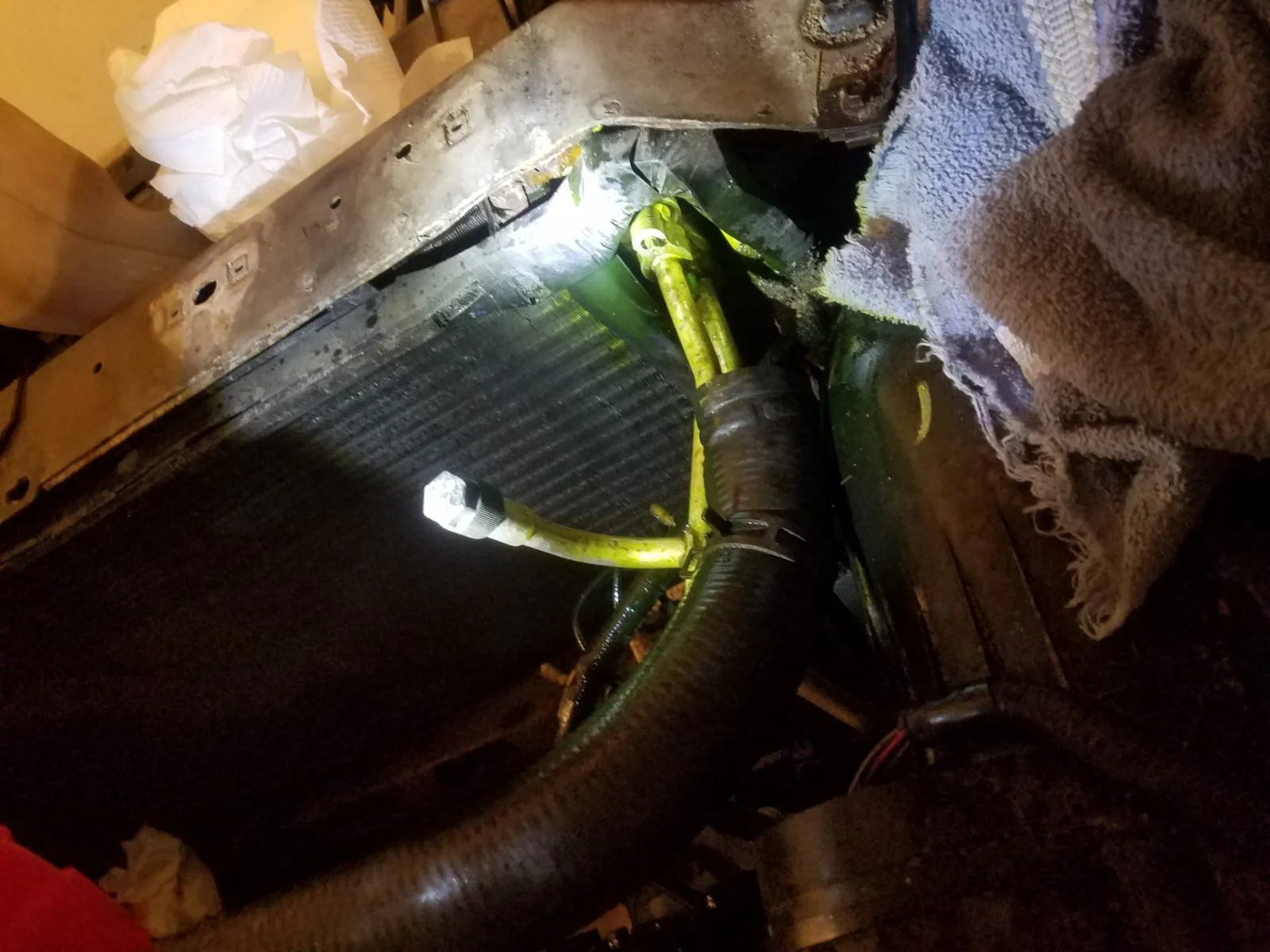

Hey guys im trying to remove my AC condenser and doing it i was removing the two nuts that connect to the ac condenser itself and it popped shooting yellow neon fluid all over my engine, it sounded like a ballon letting out air super loud while spraying my engine with fluid, any idea what i just possibly messed up? Im afraid to take the bottom one off now. Any help would be appreciated.

Did you evacuate the system first? If not you just released the refrigerant, the coloring is for leak detection and there should be oily residue(there is oil in with the refrigerant to lubricate the compressor).. You can finish the removal now, you may get a little more release as it heats up and turns into a gas but nothing like the first release. Not a system to play around with if you not trained in it, hundreds of pounds of pressure is created on the high side during normal operation that can F you up good.

Okay, say i didnt fully clean everything out but most and the refrigerant was still on the engine, its literally all over the left side of the engine (wires, metal tubings, plastic pieces) and even got some on the windshield because like you said its alot of pressure and it shot everywhere, and if i got everything fixed with the front part atleast, is refrigerant flammable? Would it catch fire when the car heats up, i tried lighting it on the tool i used to unscrew the nut because it got drenched in it and it didnt catch, but my car is in my garage and i dont want to waste my money if the cars just going to burst into flames and i dont want it taking my house with it. I dont want to totally scrap the car because ive put alot of money into it and i could always cancel the truck coming on tuesday but the car has 140,000 and im still unsure if its even worth it, with the money i already put it in i couldve gotten a 2004-2007 GT with 100-130k miles and no issues (so far around 6k including price i paid for the car but not adding whatever i would be spending on repairing it to fix this)
This is actually a good question. Any stock or aftermarket refrigerant for vehicle AC's is not flammable but that doesn't ensure what was in your car isn't. Flammable refrigerant's can't legally be used in cars but that doesn't prevent them from being put in by the unscrupulous or the downright idiot. Even then I don't think you have much to worry about by what you've described. A garden hose and paper towels along with some common sense should take care of your concerns. Wash everything down but don't go nuts on any electronics, wipe everything down well and give the engine some time to dry out. As someone said, what you're mostly looking at is lubricant. What were you trying to achieve when you started tearing down your AC? I'm no AC expert but some here like @wmburns are probably better sources of information specific to your car but there is nothing about AC that I can rationalize junking a car over.
