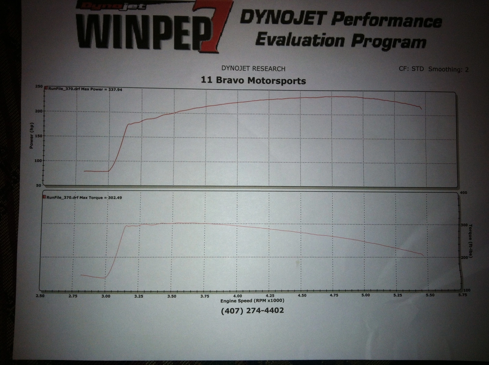

According to this dyno sheet when is the best time to shift???
Paul Randle
Sep 27, 2012
87
orlando
I have been told to shift before the power drops off then i was told to shift right after. But can anyone give me a clear answer as to when is the best time to shift according to this dyno sheet?

All vehicles are built differently with different mods. Shifting AFTER the peak power point doesn't sound right to me but it's all about seat of the pants feel as you approach or pass the peak power point. If you don't feel like your car is still pulling hard then shift. It's really preference and by feel.
The miles wouldn't concern me. It looks like 4800 to 5k would be about right but it is gonna matter where it drops to rpm wise when you shift. You may benefit from a little more time in the upper rpms even though it is not in the peak HP/TQ area so that it drops to a higher rpm that is in your power band when you shift. If that makes sense.

That's correct, which is why one shouldn't take the "hotrodders' rule of thumb" nor the tachometer redline as gospel. It all depends on the shape of the torque curve and the gear ratios.
I just ran an acceleration simulation using your torque curve and gear ratios. The rpm numbers I came up with are:
1st to 2nd: 5900rpm
2nd to 3rd: 5700rpm
3rd to 4th: 5400rpm
I agree. I'd like to have seen the torque at lower RPM. You want to come into the next gear at nearly peak torque, maybe a few hundred RPM before then. That way as torque starts to fall off the horsepower is coming on.
