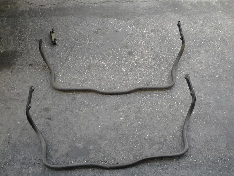

I found one through Craigslist and I picked it up today. It is now installed, and my car is quiet once again!
Also, I noticed that it broke right across the driver side rear bolt hole. The break was pretty clean, but it was rusted on one side, and clean metal on the other. I guess there was a break there for a while, but the bouncy shock was just enough to finally kill it off.
Either way, here's a comparison.

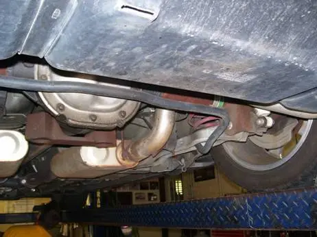

oh so it mount to low control arm ? I thought it mount other place, dam that wat for own camaro for so long. camaro is mount on different place. and i think my 98 gt mount on different spot.
let me run to my car really quick, it dark as hell out side. brb

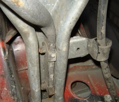

here's another pic from online. It bolts from the inside of the control arm and the bolts come through the outer side of the control arm, and thread into these U-nuts that are located on the sway bar itself. There should be two holes in the control arm for the bolts to pass through.
pix still not work . anyway while doing tranmission mount, i have chance to really look at the rear low control arm. I finally found 2 holt that rear sway bar bolt too, on left side i only see 1 bolt and other bolt missing, and on driving side, still have a 2 bolt with a broken rear sway bar peice lol. so you say find any 94-98 mustang sway bar will bolt right in right ? any different from a v6 or v8 rear sway bar ?
