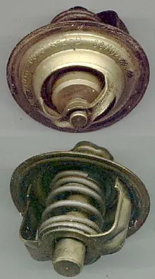

it goes in spring toward intake right?
Correct.
Use a better one like this:
Top (pointy end) goes towards front of vehicle.
