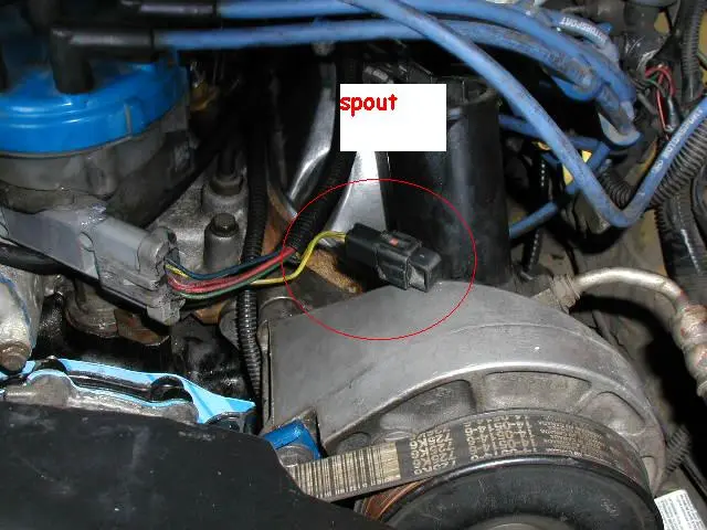

Hey I want to adavance the timing on my car and I have no clue how to do it(website is fine). I would like to get it to 13*, or do you guys recommend something else? Also where is the air box silencer and what does it look like? By the way I have a 1993 mustang gt auto.Thanks
in case you dont know what the spout is.heres a pic. you can unplug the small tip of that connector.
loosen the distributer bolt, remove the spout and hook up your timing light. start the car and adjust the timing. shut the car off and tighten the nut. i usually like to start it again to make sure the dist never moved. Then put the spout back in.
