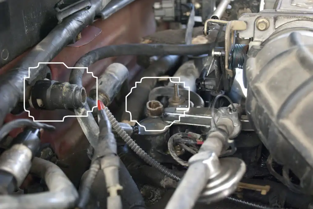

have a question fellas. i own a black 2004 ford mustang gt 40th anniv. premium edition. all original engine parts except for the MSD blaster coil packs i put on and the aftermarket starter/alternator. my question is involving the hvac system. two days ago i was at a stop sign then when i took off engine coolant started spraying out the hood all over the windshield. i know the hose leads to the heater core but the hose is coming off a plastic tube pointing up and thats what was blowing coolant out. im being told i need new intake manifold but it just seems stupid to need a new manifold because a little piec of connector tube is broke. anybody know if this is a bolt on part or not? i can actually see a bolt on it so is their like a adapter or something bolt on
have a question fellas. i own a black 2004 ford mustang gt 40th anniv. premium edition. all original engine parts except for the MSD blaster coil packs i put on and the aftermarket starter/alternator. my question is involving the hvac system. two days ago i was at a stop sign then when i took off engine coolant started spraying out the hood all over the windshield. i know the hose leads to the heater core but the hose is coming off a plastic tube pointing up and thats what was blowing coolant out. im being told i need new intake manifold but it just seems stupid to need a new manifold because a little piec of connector tube is broke. anybody know if this is a bolt on part or not? i can actually see a bolt on it so is their like a adapter or something bolt on. the part on the right that is circled is my problem. this is not my engine though mine has two heater core hoses not one
The intake is a single molded plastic piece. The heater hose nipple (the broken part on the right) is molded DIRECTLY from the plastic intake. I think what you are failing to realize is there's a flexible hose between the two nipples. With the broken intake nipple there isn't enough nipple left to hold a hose clamp.
The bolt in question is to hold the fuel rails down.
I'm sorry but you do need a new intake unless you can find a piece of plastic tubing that just fits the inside diameter of the intake heater nipple. The challenge here is to get a coolant tight seal so the choice of glue would be important.
Note, I have found the 4.6 intake to be easily damaged when over heated. So if the motor did overheat then replacement should be considered just because it's likely there is damage elsewhere.
Note, the 4.6 modular motor needs the heater coolant flow to purge air from the system. That is way it's not recommended to PLUG the heater hoses. If needing to bypass the heater core, LOOP them instead.
An intake replacement does take some time to perform but it's not really so hard to do. I have done (4) now on various Fords owned by my family.
thanks buddy! i kinda wanted an all metal intake anyway.
