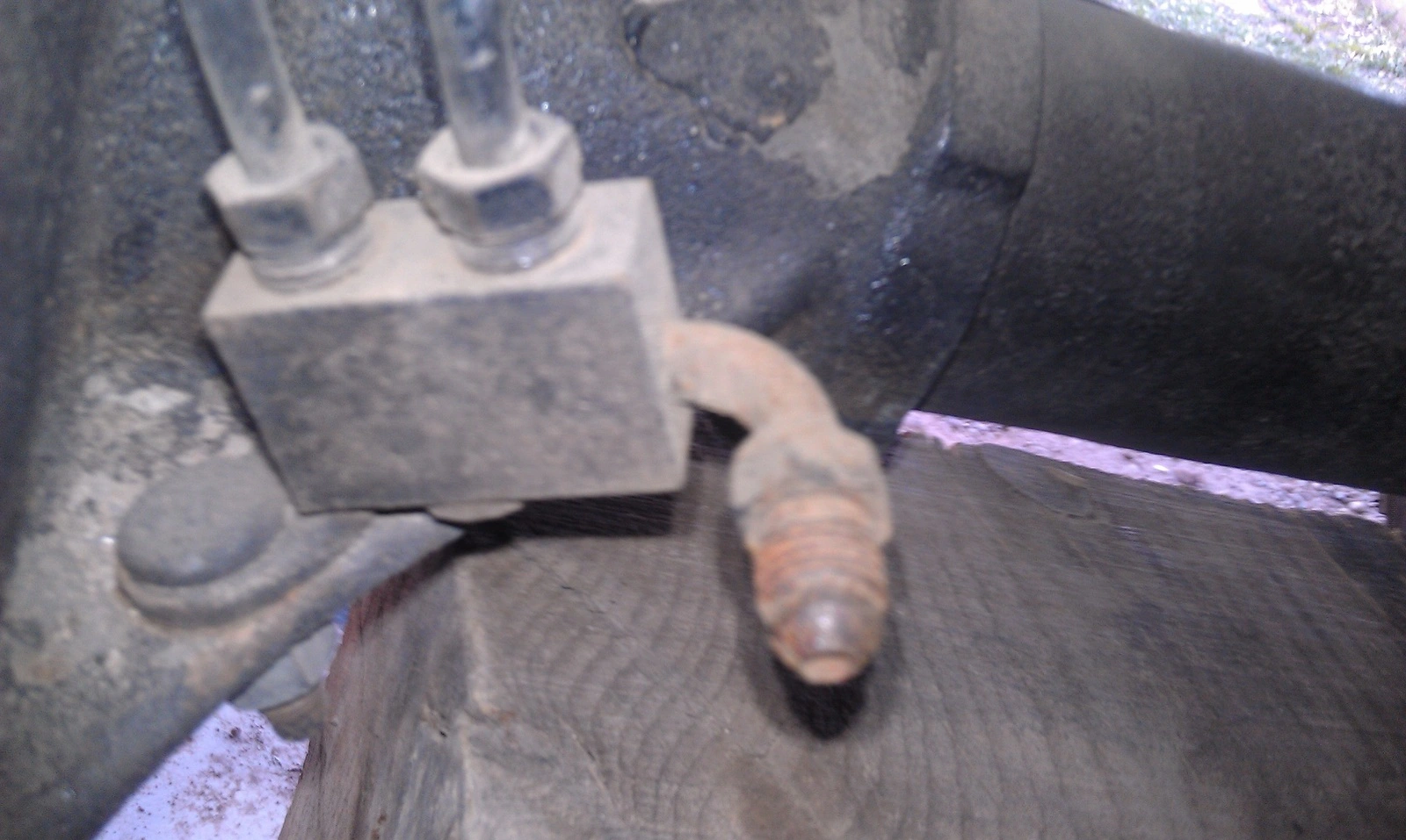

View attachment 70851 Hi,
I am currently in the process of finishing a SN95 rear end swap into my 1986 Fox GT. However I am picking up this project about half way through after my brother walked off in the middle of the project. I think I have everything figured out with the exception of the brake lines. The SN95 rear currently has soft lines going to the calipers and meeting at a hard line T with a fitting im not familiar with. Can anyone tell me how to adapt this fitting into the stock brake lines from the 86 GT? Any info you can give me would be appreciated. Also any thoughts on having to upgrade the brake booster / master cylinder while im at it?

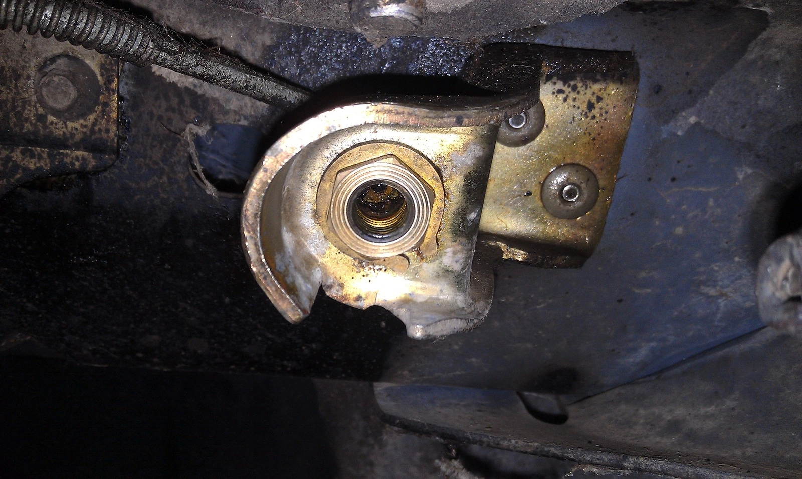

Yes, you can use a brakebooster and master cylinder from a 95...gt or v6, it doesn't matter. The second photo you showed, the fitting attached to the car, accepts a 3/8" banjo bolt. The easiest thing is to lose the hard line on the axle. Get one from a foxbody. You will have to shorten the hard line and get a fitting to adapt it to your soft lines on your calipers. The new fox body hardline will have a soft hose coming off that t fitting which will run up and attach to the car with the banjo bolt. Good luck with it!
