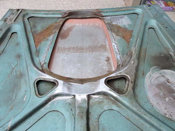

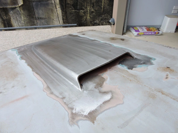

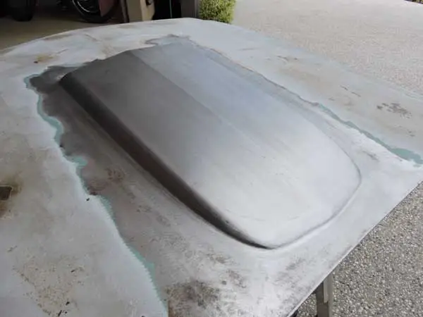

From memory it was $1200 for the forming and attaching the scoop and $1000 for preparing and painting the hood. This is in Australia, I dont know how your labor charges for top tradesmen compare with ours.
If Drake sells a metal scoop it would be the to go provided it can be welded.
