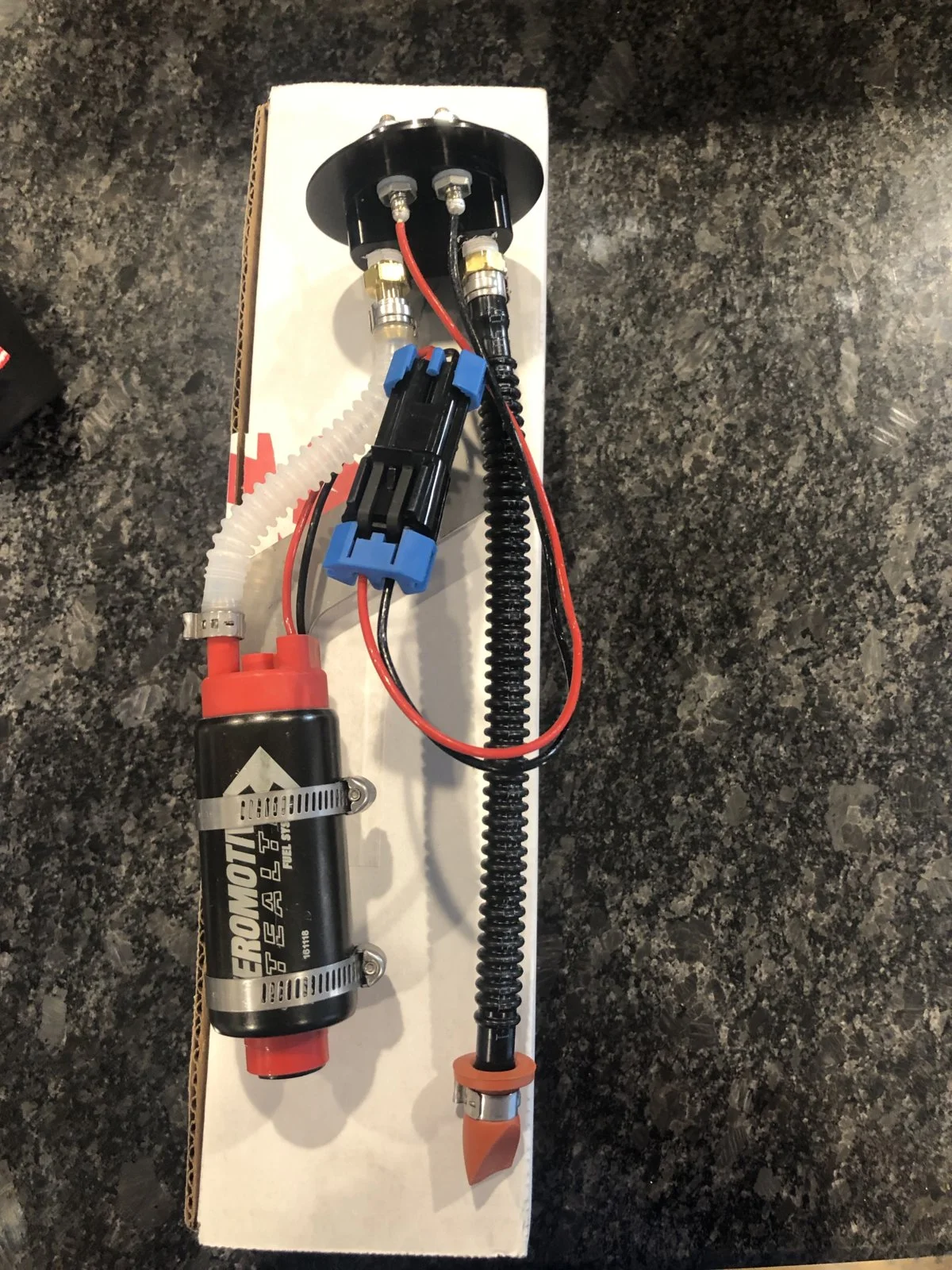

Hey guys just picked up my 92 gt with a dead fuel pump so I went and purchased a aeromotive 340lph in tank fuel pump and hanger #18638 ,
my question is where can I get connectors to hook this up to the factory fuel supply line and factory fuel return line? I have been searching all over the internet for answers. Or do I have to buy new lines and make them myself? Any help would be great and much appreciated .

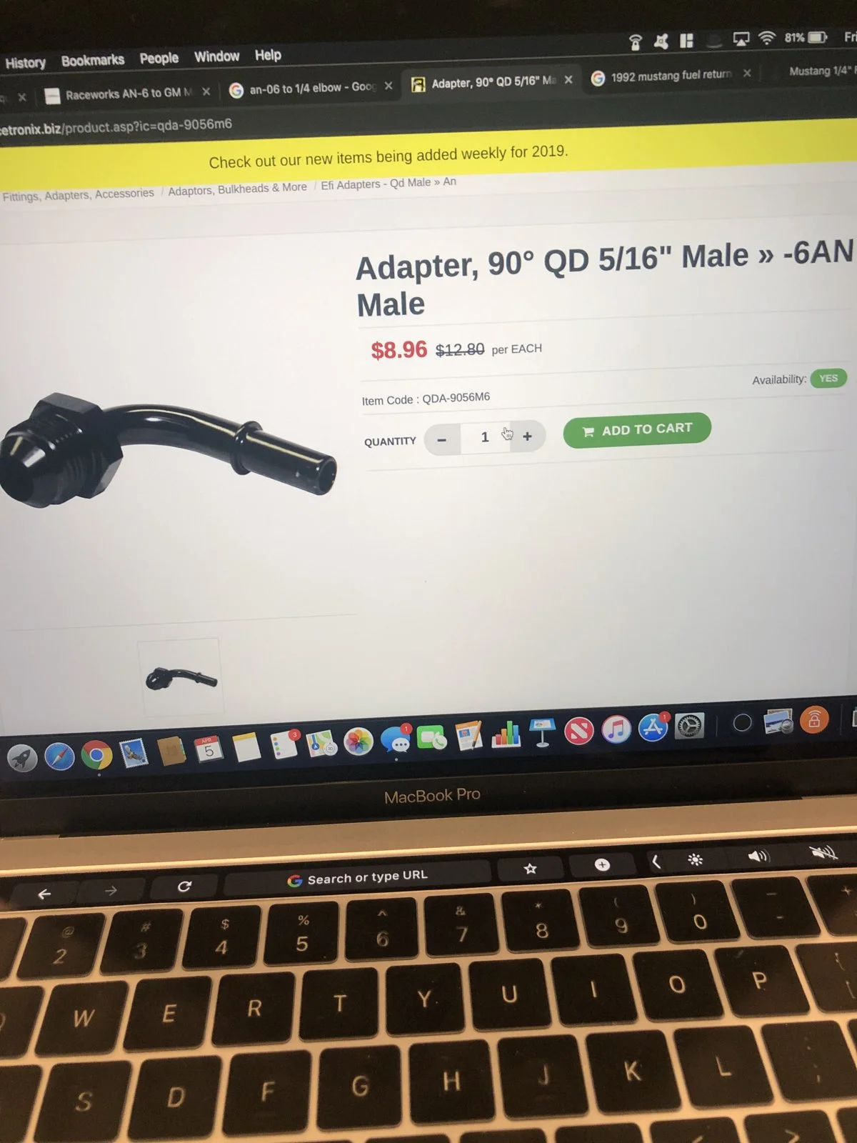

What I think i need is a AN-06 to 5/16 quick connect fitting 90 degree elbow for the supply line and
AN-06 to 1/4 quick connect fitting with 90 degree elbow
I have found the 5/16 but the 1/4 fitting i can't find and maybe it doesnt even exist !

You should never have to buy new lines unless you want to. I mean, you could choose a cut-off point anywhere in the lines that you like and adapt them to either another hard line or soft one or even into a manifold.
This is certainly not the only source but it's one of the first that popped up:
https://www.jegs.com/c/Fittings-Hose/181705/10002/-1
Do you possess a line flaring tool?

That pump is too big for the factory fuel return line, therefore, idle fuel pressure will be too high.
If you are still using the EEC-IV with no chip, it may not want to idle. If you have a "chip" or aftermarket ECU, you can tune it out.
Bigger is not always better. 250 lph should suffice.
Even if you increase the fuel line size, the factory FPR will be a problem.
You have a Vortech S/C; how much boost?
What size injectors?

Like @TOOLOW91 suggested, that fuel pump is too large for the application. Alongside driveability issues, you stand the [real] possibility of boiling the gas in a return type fuel system by constantly recirculating the fuel.
A 340L pump will spend the majority of its time pumping the fuel constantly from the tank, to the fuel rail where it doesn't get used then sent right back to the tank where the cycle repeats.
This is not a good plan. Pumping more fuel doesn't make it go faster.
I put down 480 RWHP through a PD blower with a 255L high pressure. At cruise, I still by-passed more fuel than I would have liked so I installed a Boost-a-Pump. It does a couple of things for me: It regulates power to the fuel pump at all times, taking care of the instabilities in our electrical system :rolleyes: and also provides a regulated selectable voltage increase during boost. You will see an example of this in the article I referenced.
Ok so if I can return the pump I should , then just purchase a factory fuel pump assembly and order a walboro drop in and call it a day ? If I can’t return the 340 pump then I will still order the walboro and install it in the aeromotive fuel pump holder ? Does this sound like a better plan ? I’m new to forced induction so I’m still trying to understand everything. I appreciate the help with this . One thing I did learn from this is not to jump on things listening to one person lol because it cost to much money !!
True story, and 'Yes'. You should install a drop-in pump and save yourself a bunch of money and headaches.
Either sit on the pump for a time where you have $10,000 in a 700+ HP motor or sell it if they won't take it back. Be aware that they might offer in-store credit if they do take it back. Maybe they have the Walbro pumps too?
