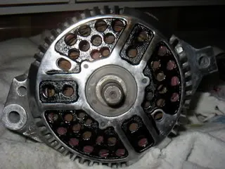

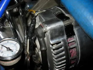

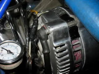

ok here are pics of the install for the 3G alt!

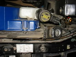

first i had to notch out the bracket so the new alt would fit

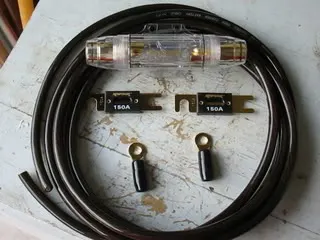

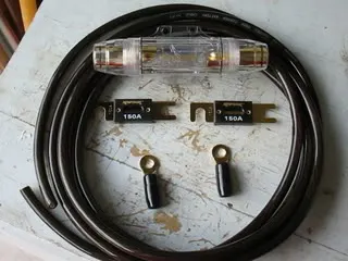

here are the supplys needed to complete the swap!

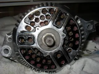

here it is installed on the bracket with the wires hooked up!

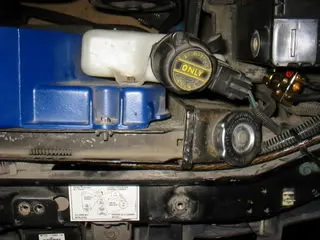

then ran it to a 125 amp fuse mounted on passenger side fender!
ran the wire infront of the rad and under my rad support bracket
and out the other side to the drivers side fender!
then put my rad support bracket back on ! hides the wire nicley!
then ran the wire to the solenniod
