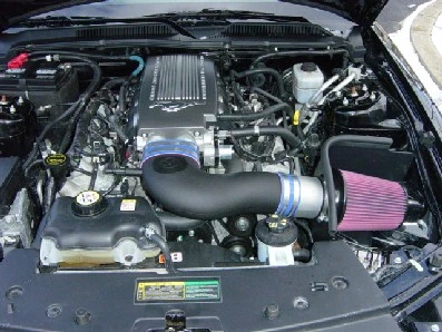

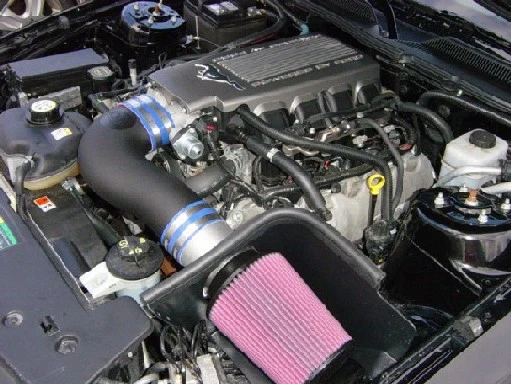

C&L Racer Pics
Great, thanks for the info. I decided I did not need to pull them anyways...
Some pictures of my C&L Racer.
Black07GT
The C&L Racer looks great!
