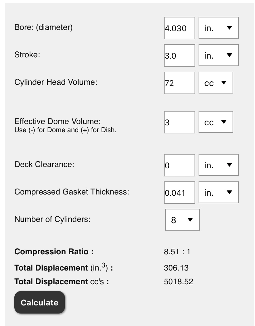

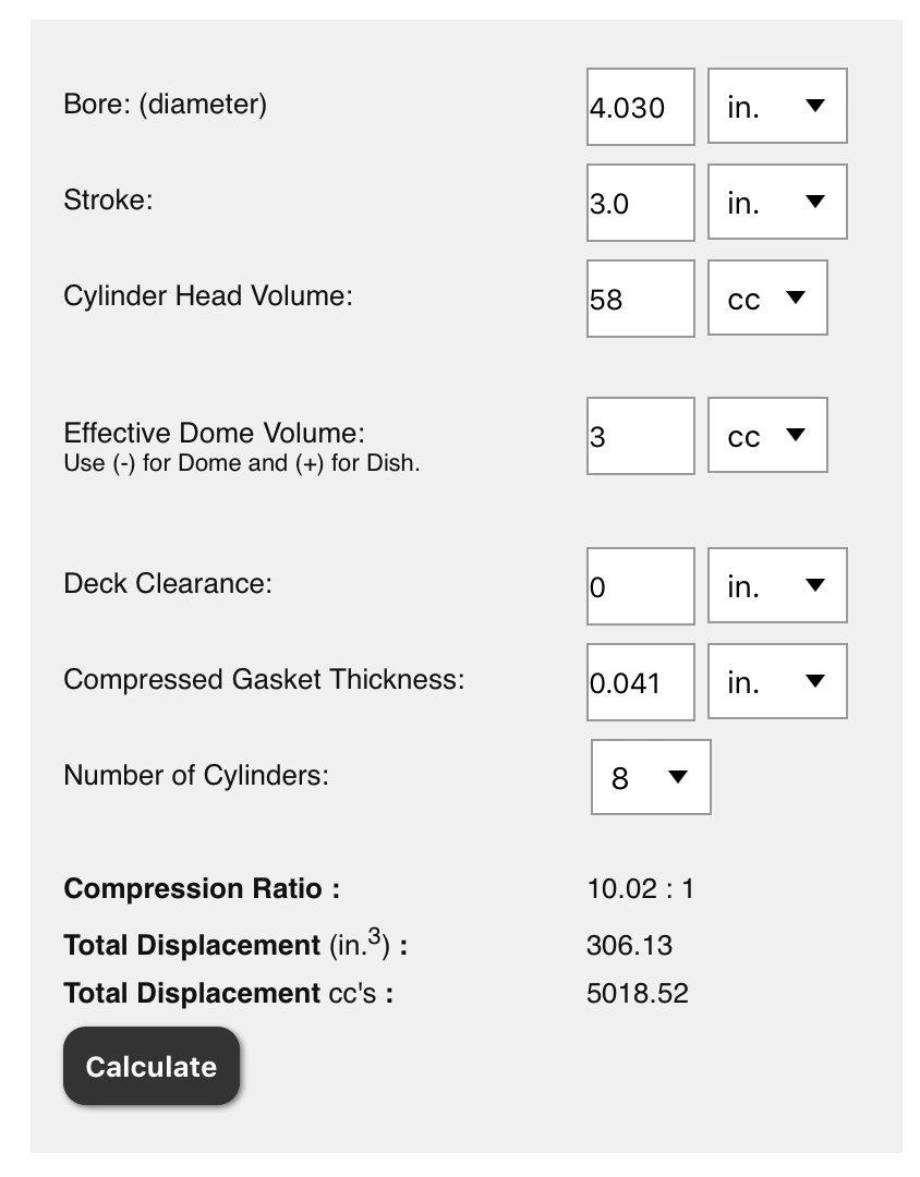

Im looking at getting a set of these heads and they seem to come in 58cc, 60cc and 72cc combustion chambers. When I used the compression calculator with those heads I get 10.5:1, 9.77:1 and 8.7:1, I would like a head that has a combustion chamber in the mid 60s that keeps me around 9:1. Im using a Vortech V1-S trim at around 10-12 psi so I don't want too high of a compression.
Bottom end DSS rods and pistons with valve reliefs cut into them, explorer throttle body and intake, 60lb injectors, stock cam to be replaced with e303 or something that will compliment the entire package

If it were me and the assuming that the math is right, I would take that 9.77 option all day long and shoot for whatever boost pressure (irrelevant number by the way) that dyno-tuning determined was the best.

I wouldn't fret too much with compression as it can be compensated for in the tune. The coyote motors are 11:1 and people run all levels of boost on them without issue. The key is the tune.
my concern is the 72cc would be sluggish during normal driving and safe during boost and the inverse with the 58cc. Anyone running these heads on a boosted application I would like see what boost levels are being "safely" run?

Ive got the 72cc heads on my turbo 351, it's around 8.6:1. Runs fine.
Assuming your data is correct on the actual cr I would use the 9.xx:1 comb chamber(64cc?). You can adjust that slightly with head gasket thickness,camshaft,fuel octane,actual tuning etc etc. No reason a 9.5-10:1cr aluminum headed sbf shouldn’t run fine.
using summits compression calculator

In terms of the cylinder head choice.... let's start with the use of that Exploder intake. First rule of making power is to have an intake that out flows your heads. Bottom line, why have a 300 CFM cylinder head if you're going to choke it with a 250 CFM intake manifold?
Yeah, I can hear the novices with... "It's supercharged"... No matter, the combination of small intakes and big heads doesn't work.
If the OP is stuck on that truck intake, use an AFR 165 or a Twisted Wedge 170. Equip them with the matching valvetrain pieces and have Tom's kid port the snot out of the truck intake and you're close to a matched inlet track. (I don't/won't port these intakes anymore)
