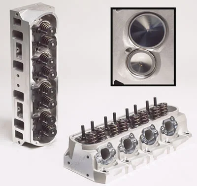

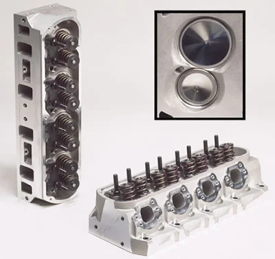

http://store.summitracing.com/defau...ults=false&N=0&target=egnsearch.asp&x=52&y=13
http://www.jdsperformance.com/index.asp?initemuid=53&fcmd=item&inmake=all
Through summit the "R" heads are $1570, through JD's they are $1480. Have summit price match and you'll be at $1490 shipped. Just an option.

5.0 HOtrain- I looked at the R heads, and they seem to be a good head, and it looks like they gave you good dyno numbers. Dont you need a special type of piston for those heads or is that just twisted wedge heads? I might be interested in them if they offered them in 58cc. And I think that i would have to spend more to have them upgraded with springs for a solid roller cam.
But thanks for the option and replying to the thread. :D
You need a TFS specific piston. I run a hydro roller and the springs that came with the heads. I had mine milled a little to get compression where I wanted. As far as #'s, from 5600-6700 the motor was making 555+ fwhp. I shifted at 6000-6100 at the track when I should have shifted around 6800-7000. At 3300lbs I got a shakedown pass of the #'s above, 126.66mph isnt too shabby. FWIW, that was my 12th ever dragstrip pass.
