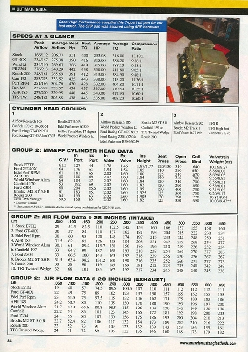

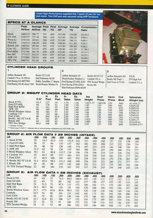

So, now AFR and Canfield have the "same" numbers? I thought you said the Canfields outflowed the AFRs...
Canfields make 5 more CFM at the top..but are behind the AFRs in both peak and average power/tq numbers. With more .76 compression.
Why is it that every article shows the AFRs beating the Canfields? Perhaps because they're better?

Those numbers are basically the same in the article. I'm sure 5 HP / TQ / CFM could come down to random variations. Those numbers are close enough to be equal. Wasn't D.Hearne originally comparing them to 165s not 185s? Also don't you save a considerable amount of dosh for that 5 CFM / HP / TQ kick in the pants?

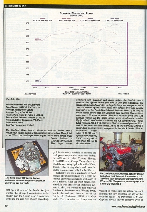

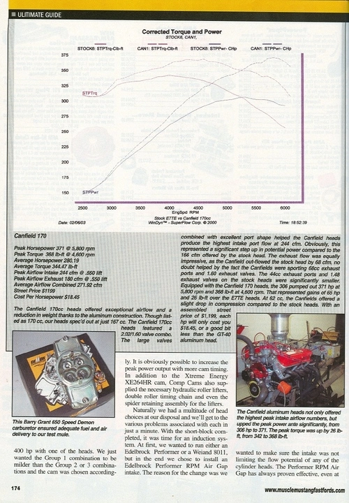

Just an observation: The Canfields were on their way to making more power in the MM&FF dyno pull, but power fell off rapidly, probably due to loss of valve control. Check out the spring rates on the Canfields and you'll see only 290 over the nose. That ain't gonna get it done using a HR cam like the XE274HR. Considering that the torque number was essentially the same as the AFR 185, the Canfield should have put out similar HP numbers if the springs had been right.
And yes, I know that the Canfields had a compression advantage, but they weren't CNC ported either. Canfields are good heads. I read on another board that the Z304 Ford head is supplied by Canfield. Can anybody confirm this?

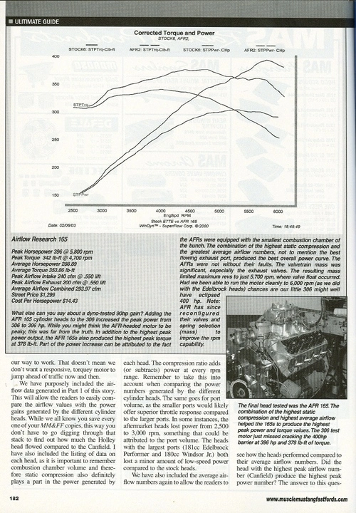

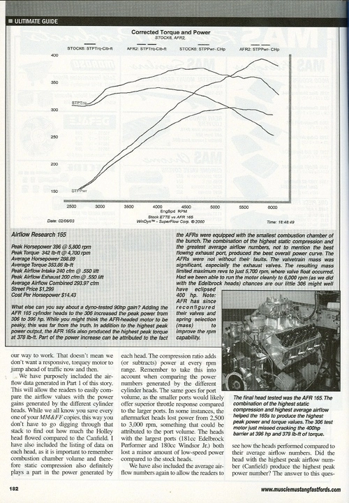

5hp, OK, but how about 25hp? 165 vs Canfield.

Well, one thing is for sure...if I had canfields I sure wouldn't waste my time pulling them off just to put on AFRs. Even if I had Edelbrocks or Trickflows. On a mild street motor I don't think you would be dissatisfied with any of the above results. They will all make an easy, streetable 350hp on a 302.
Those MM&FF results are full of typos. Check out the curves on the AFRs. No way torque is 342! Heck, average torque is 354! You really have to read those articles carefully and correct the mistakes as you go along. I suspect that the curves are correct, though.
Route666 said:
Now 25 is something. 26 less torque for the AFRs is also something. The average shows 9 HP and TQ over the Canfields, not exactly worlds apart.
Thats a typo, if you look in the paragraph below, it says 378lb-ft.
8hp for $100? I guess you never spent $300+ for a dual exhaust system on a stock V8 that might have netted you 10-15hp??? Or 600 for an intake manifold and carb that might have netted 25hp? 8hp/$100 sounds pretty good now doesn't it?
