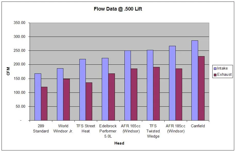

I pulled the flow data from an unknown site months ago and generated this flow graph.

will i be disappointed if i get the performers? they seem a little bit cheaper and they have decent flow but i'd need to have them milled a bit. Another option I see that seems decent is that panhandle performance has stage one roush 180 head that flow 230 on the intake and 185 on the exhaust for $1100. they have a little bit smaller chamber so no need to mill. what do you all think?

Interesting that the AFR 185s don't flow any better on the exhaust side than the 165s, especially considering that is where Fords need the most help.
Wonder where Performaer RPMs would go?
The 185's and 165's are the same on the exhaust unless you specify otherwise to AFR.
I'm not sure those numbers are entirely correct. I called Total Engine Airflow when I bought the heads because I was looking at Canfields and AFR 185's and they told me even their stage 2 port work on canfields didn't out flow the 185's. The velocity of these heads are supposed to be the real key. The 185's out flow Victor jr's with a smaller valve and smaller intake runner. So that air must be movin'.Maybe you should call a company the stocks them both and uses them on builds in house to see what they think.
