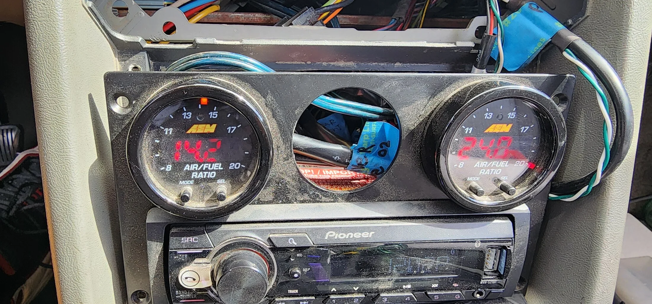

That being said. I have a couple problems I'm runningn into that I can't find the problem to. I have a 302 swapped 88 notch (original 4cyl)
First problem, when I start the engine (hot or cold start) it'll idle normal 14s-15s... 2 minutes into idle and bank 2 will idle rough and missfire (high 20s) photo attached. And that's ONLY bank 2 because bank 1 will stay 14s 15s upon start. It will do this for about one minute, I haven't timed it but thats my guesstimate.
Second issue, after the rough idle The engine will settle idle at at about 19s - 20s AFR is this normal? now I'm no tuner but shouldn't I see 14s-15s steady at idle? The engine runs and drives good, holds a 16.5 when cruising in both banks. Checked all 8 spark plugs they look decent, they don't look wet or too clean.

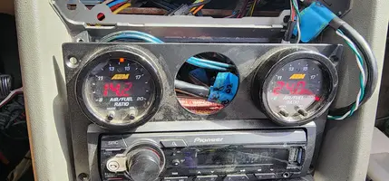

I did, i repaced my narrow band for wideband sensors. I have (AEM xseries) tapped my white analog+ signal from the gauge to pins #43 & 29.. one per gauge obviously.. I'll double check my ecu ground and injectors ground tomorrow.

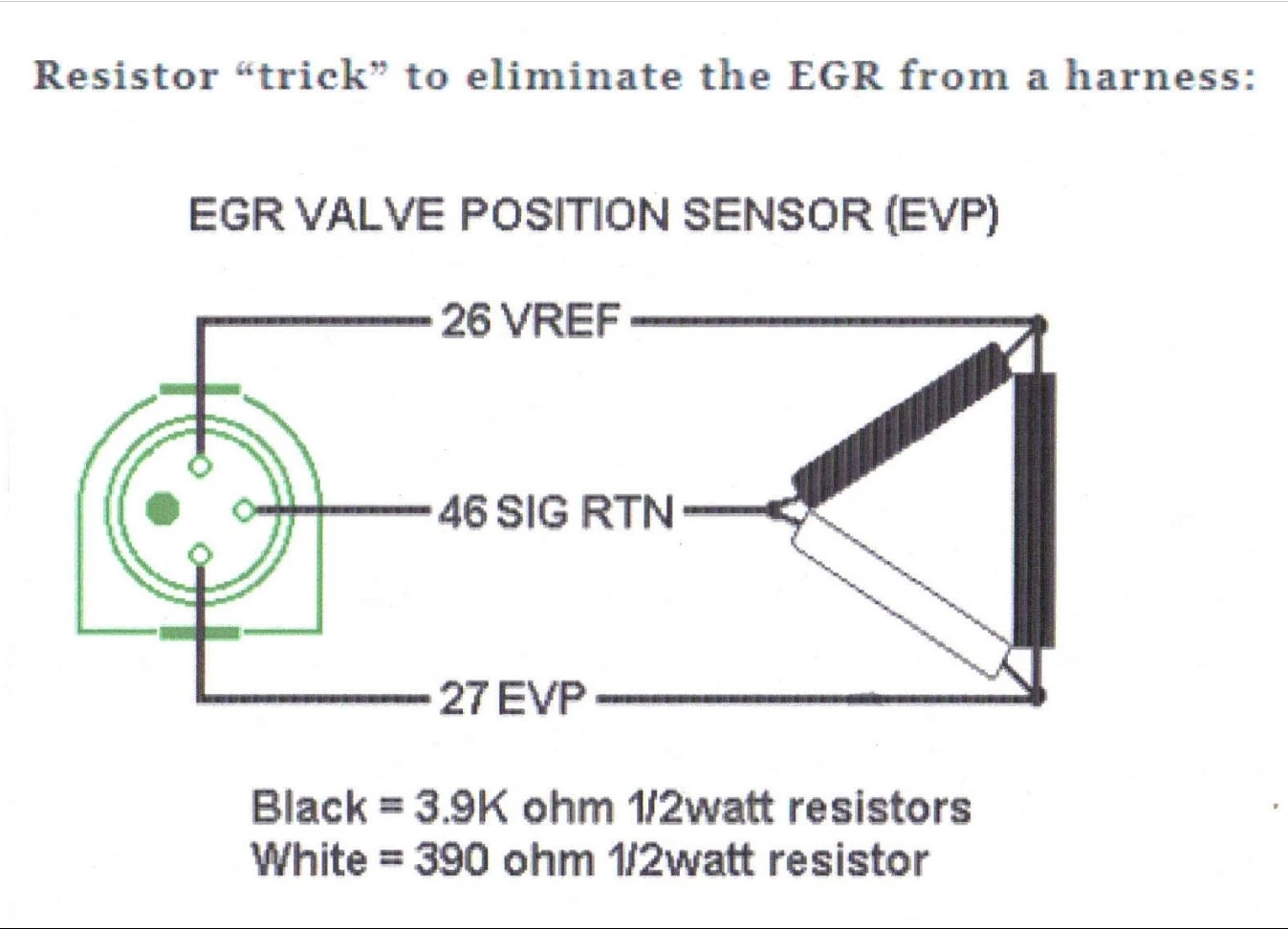

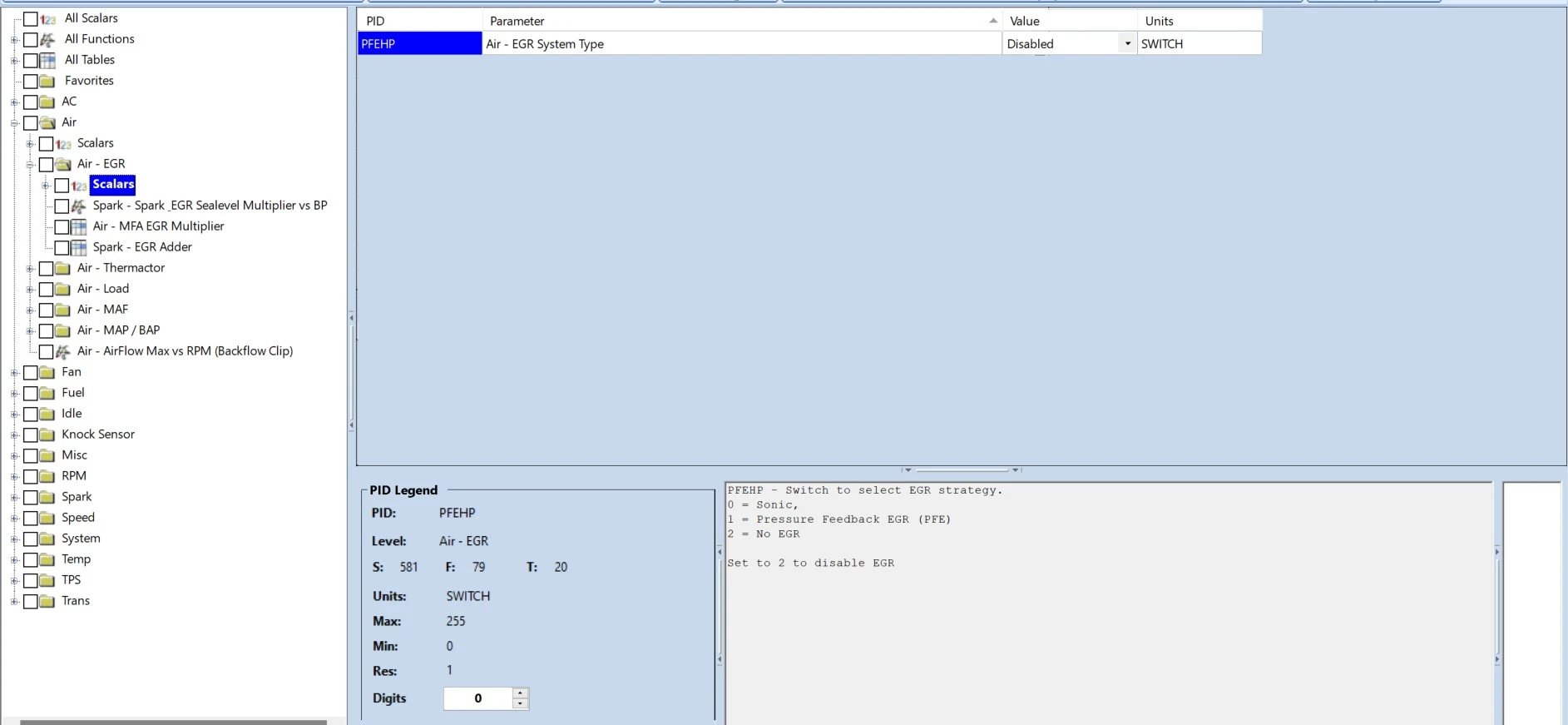

How about the EGR?..If you totally eliminated that too but didnt disable that or the thermactor in the ECU removing the EGR without putting the resistors or turning it off the timing will run locked out...

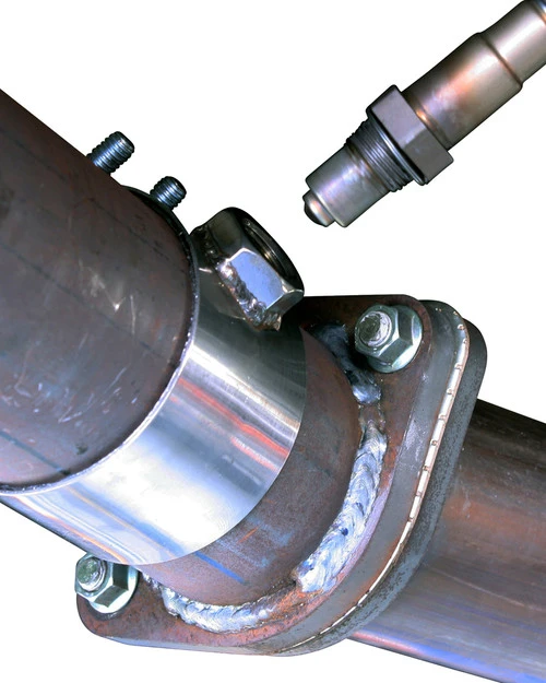

If you did totally eliminate the narrowband 02 sensors Id still run the narrowband o2 sensors plus add a couple no weld sensor bungs with bandclamp for the wideband to get a way better reading aswell as correction.

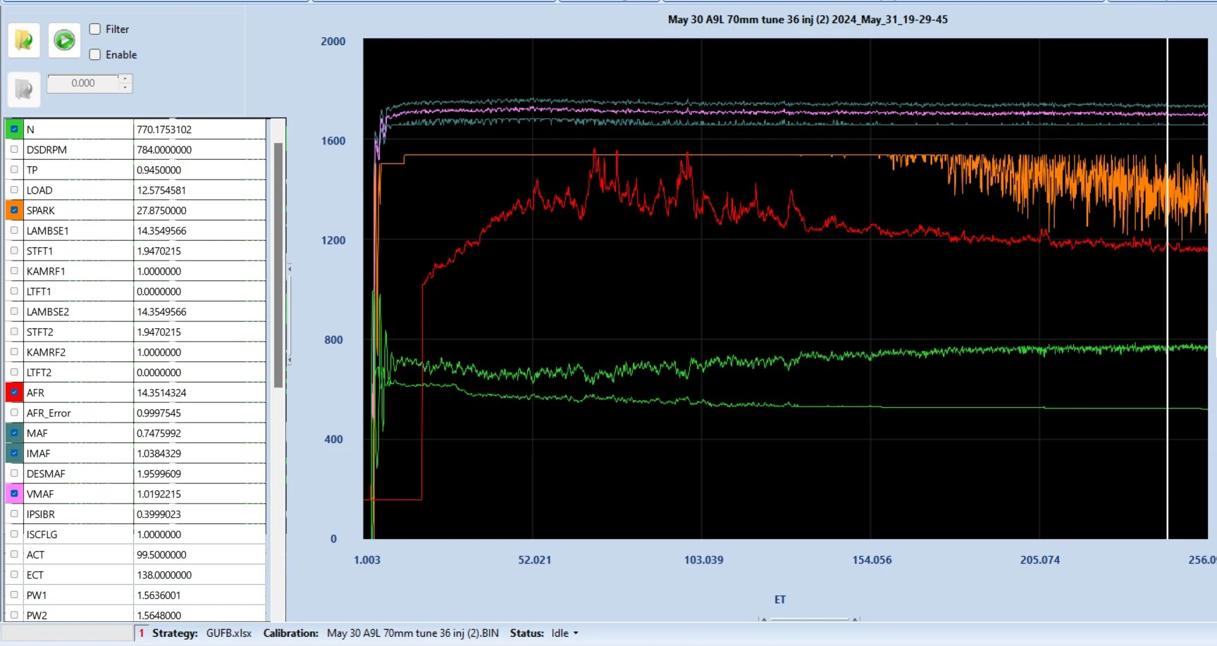

Having a way to pull a logfile definately helps and with your wideband you can datalog seperately but will need extra wiring done ...

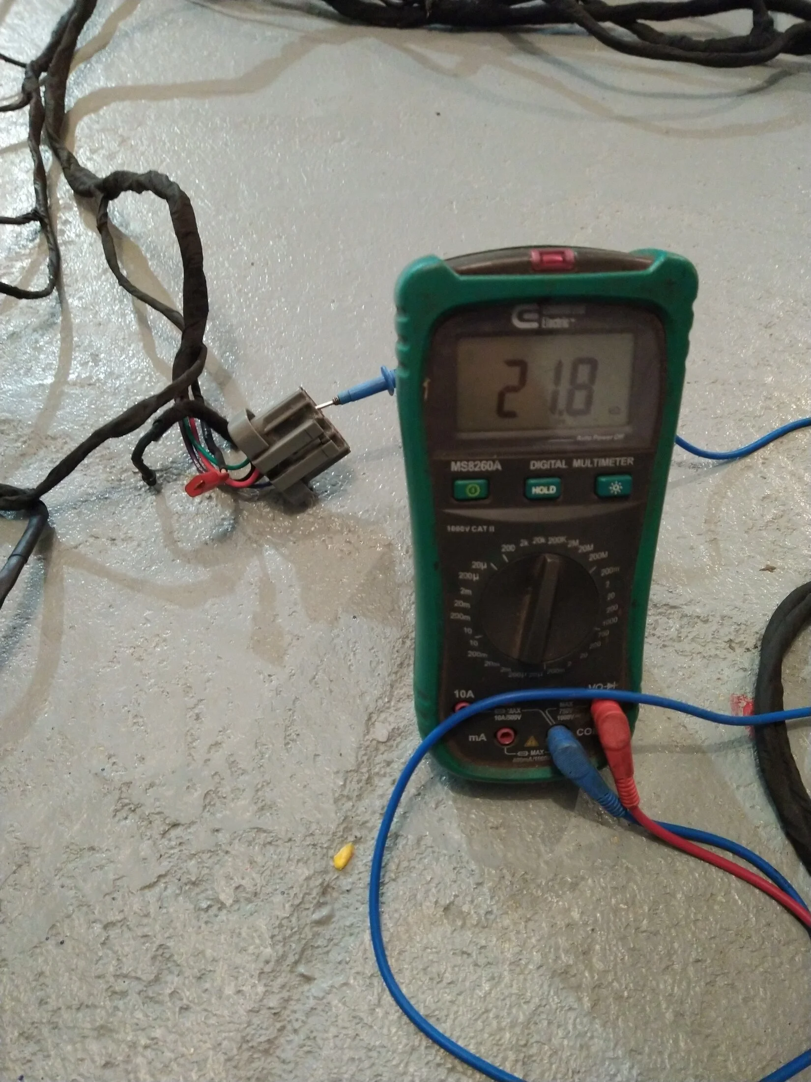

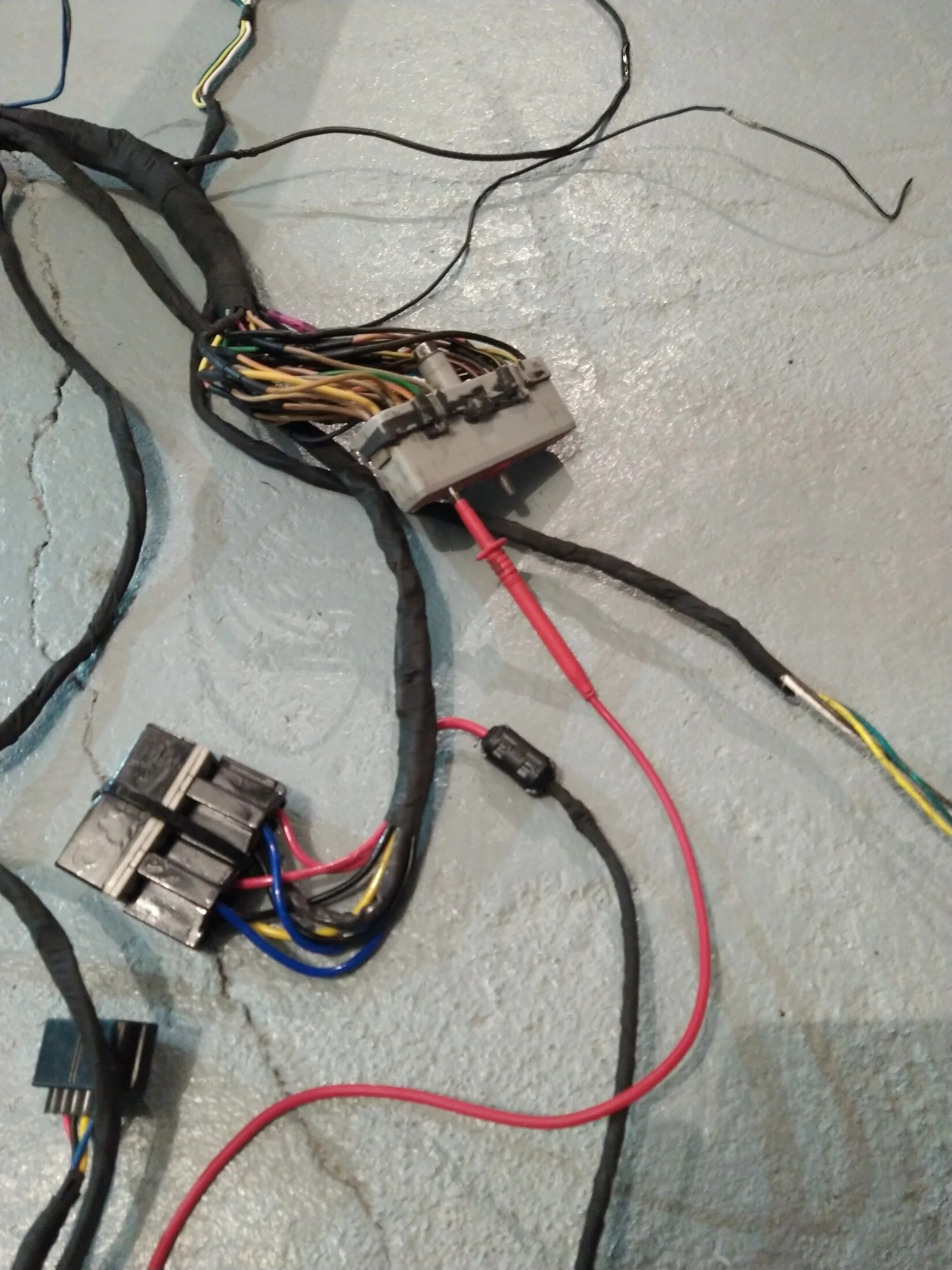

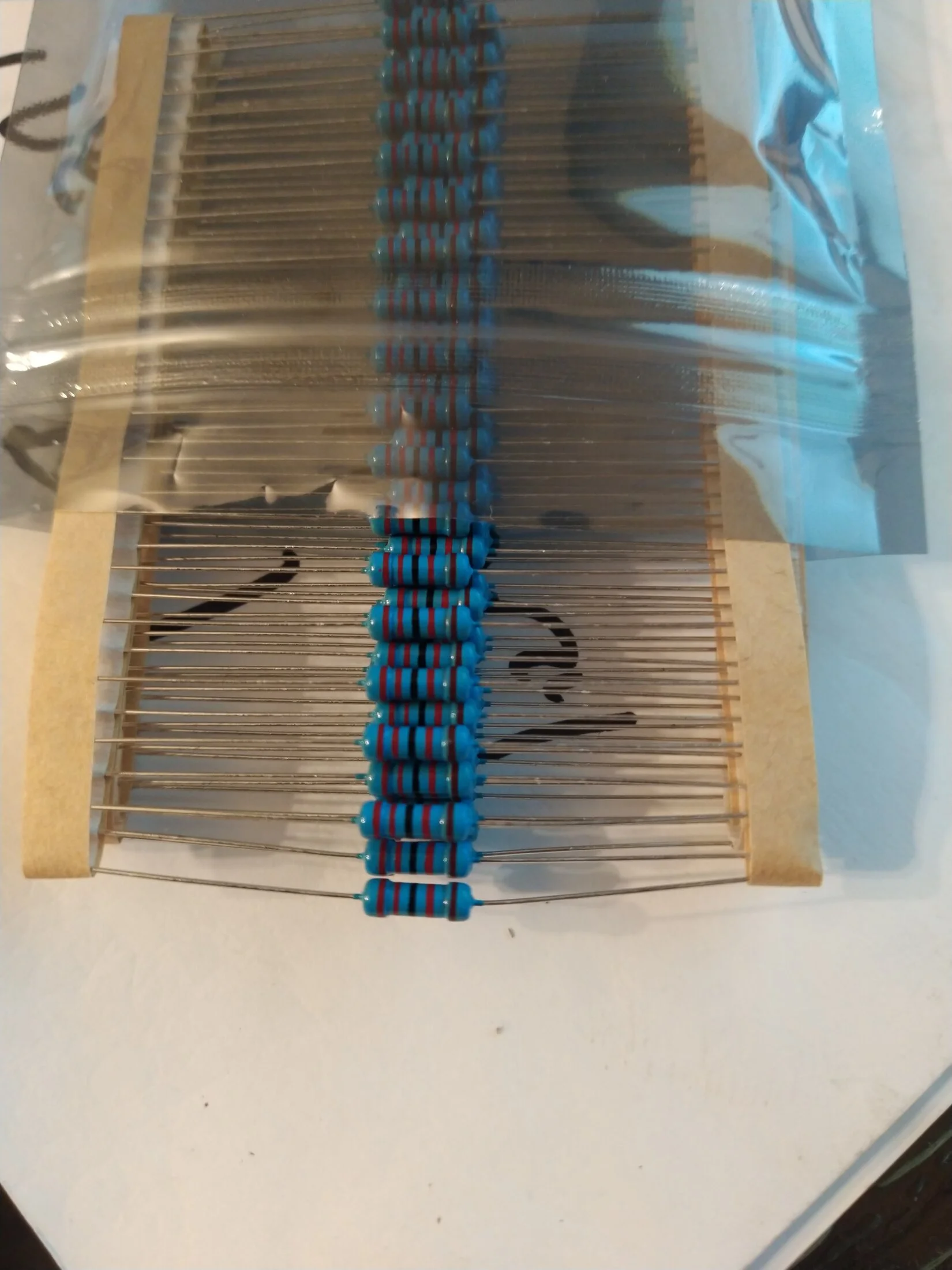

The only other thing I can think of is the wiring for your TFI module and the type of module youre running and whether you have a 22kohm resistor on the IDM circuit wire coming from the ECU plug if its a 5 speed manual since you stated the car used to be a 4 cylinder?
