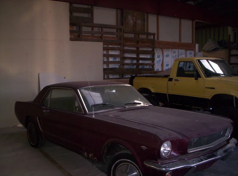

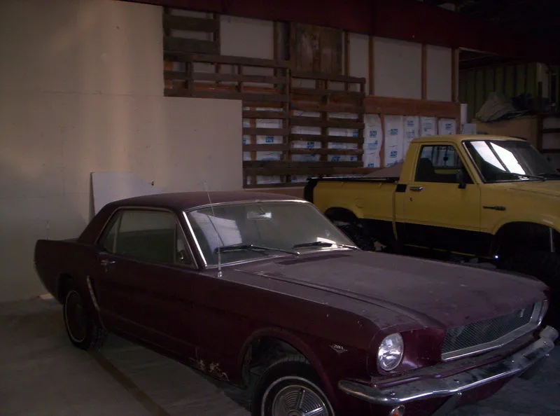

Ok, I moved the car today from storage to our shop where I'll be starting the process... :D
Here's a few pics of the car after sitting outside for 2 years... and our new shop. More to come!
