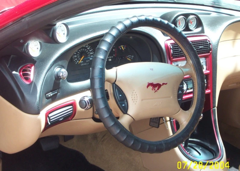

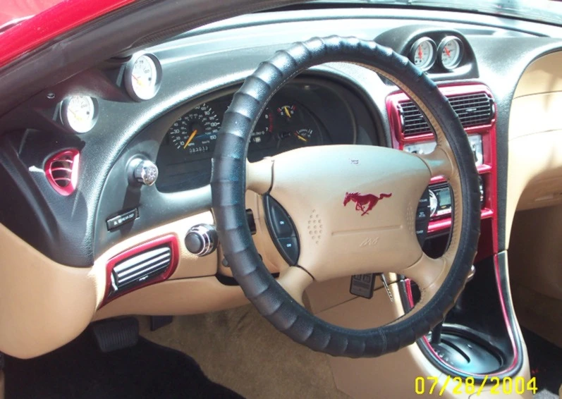

Here, 'cept I have the white face speedo now, and the old man SW cover is gone.
