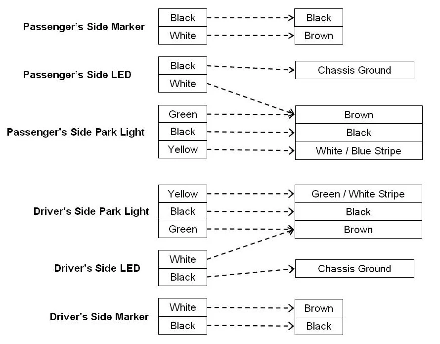

I put those in last weekend. Could pop the hood & send you the wiring combinations I used if that would help.
Hey, that would help me so much, please send me the wiring combination. I was able to get the headlight low beans working and turn signals. Now im trying to determine whether the LED's or parking lamps are blowing the fuse. Thank you, cant wait to get your wiring diagram!
