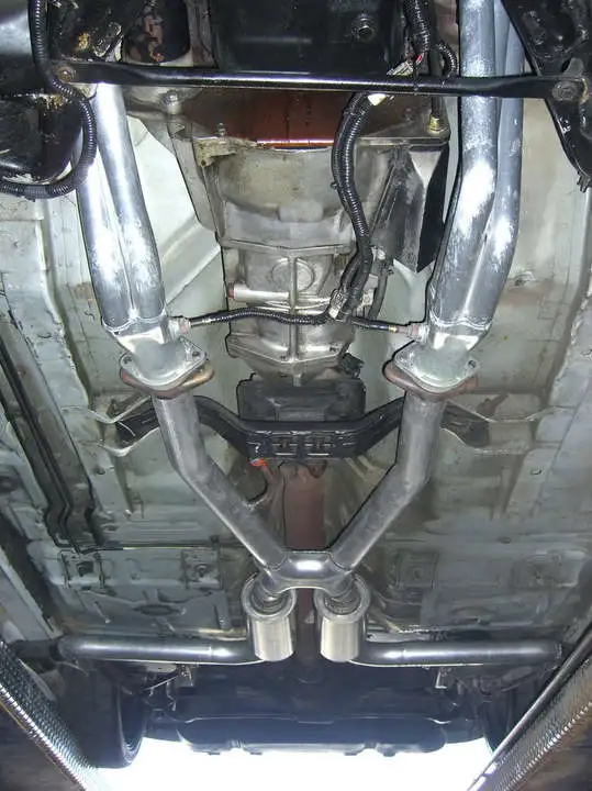

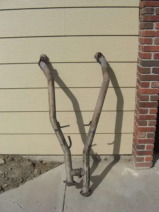

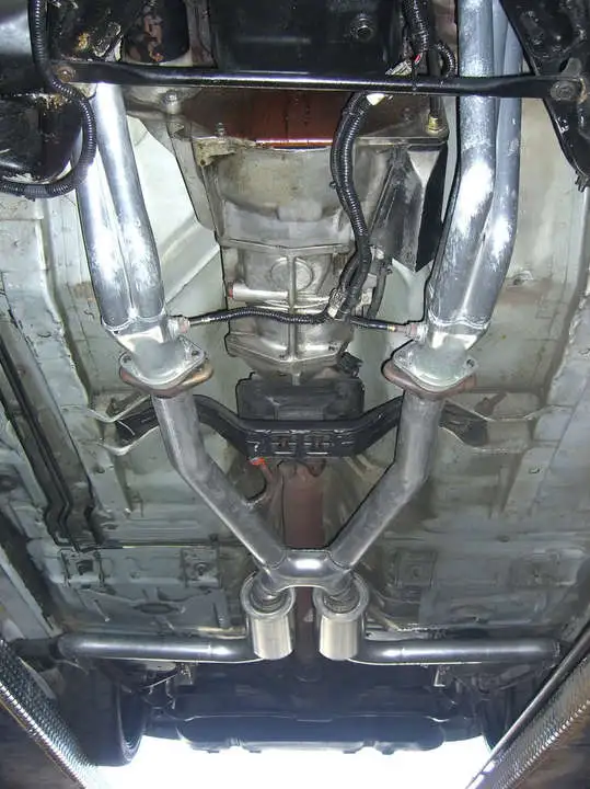

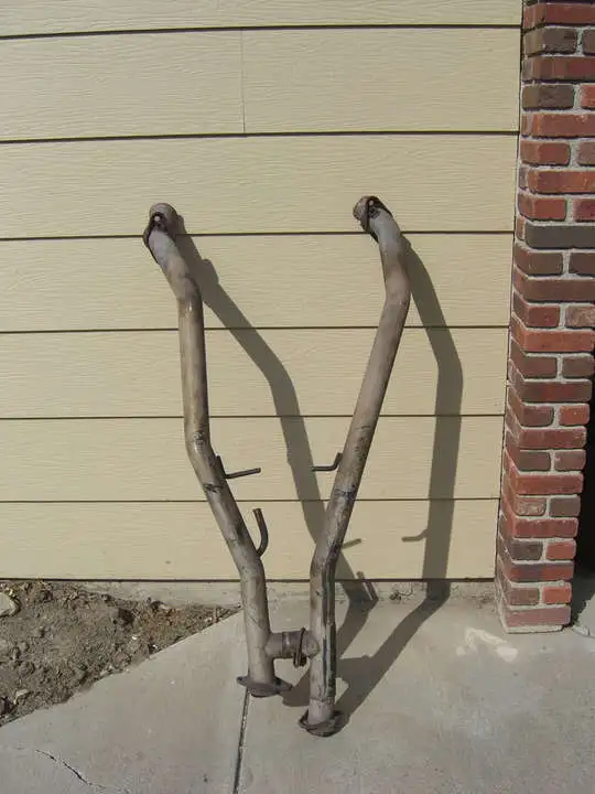

the o2 sensors plug into the mid pipe on the stock setup. if you have long tubes, which i assume you don't, they are in the header.
that line can be plugged up if you don't run your smog pump. if you plug that line, i'd remove all the smog stuff while your at it.
o2's with longtubes...
With factory manifolds...
