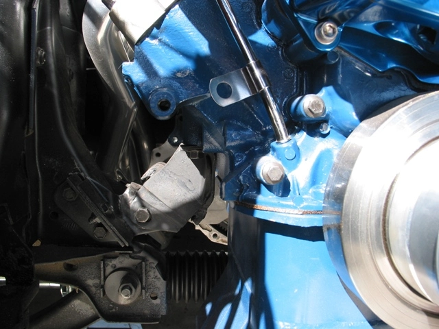

Use the stock stick and the stock tube. Here's a pic of my 8 qt Milodon pan on the Windsor.

The 20507. Front sump windsor. Yea it has a bung welded on the top and comes with a dipstick that you are supposed to cut to length. I think it is a new pan from them. Wow edbert that looks aweful nice!! Do you have a full pic of the motor?? Also is that a rack and pinion steering under there?? Again thanks for the info guys!! :nice:
