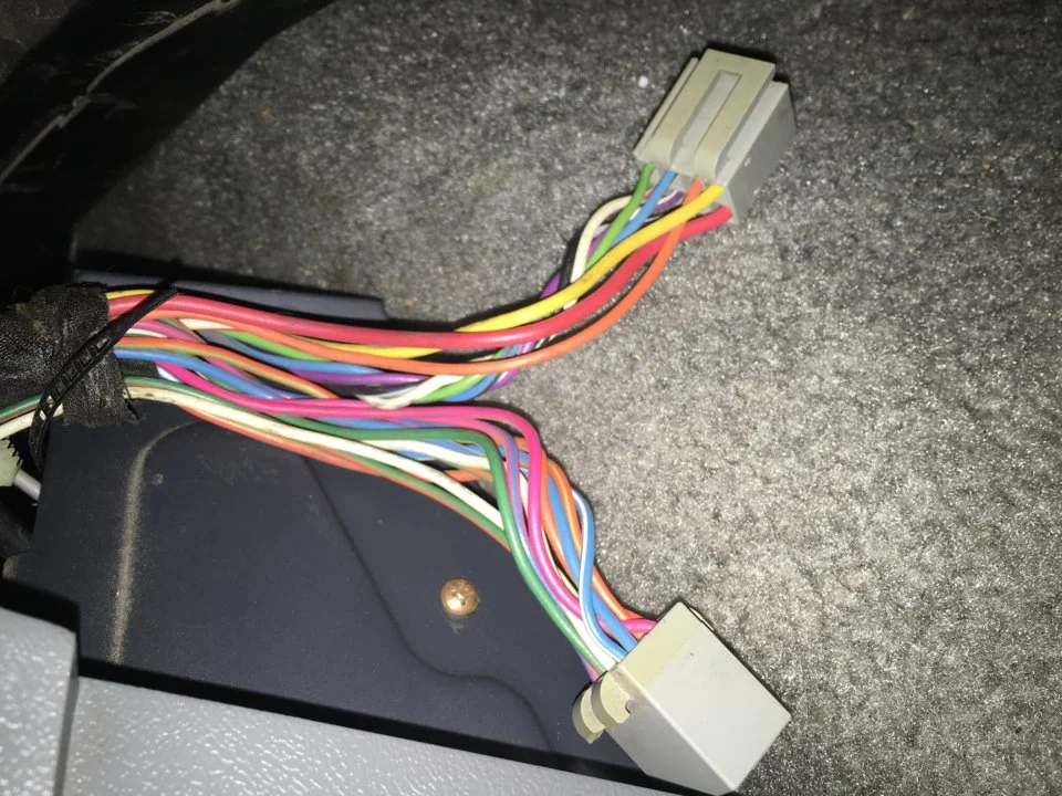

I've just installed a pioneer radio into my 88 GT, and I've come to realize the previous owner took out the stock amp. I have the radio wired up and it lights up when I turn the car on, but I'm not getting any sound. There are 2 plugs that went into the stock amp (1 for power and 1 for the speakers), but I don't know what to do from here. Advice?
Not 100%, but it looks like the connector on the bottom is the speaker harness, could you get pics of the wires on the bottom side of that connector? Also, the thread listed is mine, in that there is a harness listed from LMR that you may need to get and splice the wires. Looks like you are in a similar situation I am in...
