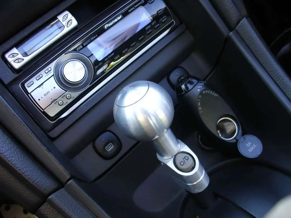

I just upgraded mine the other day with a Pioneer Premier DEH-P390MP. The sound difference is amazing:nice: I am a huge Pioneer fan because no other brand has the quality and features for the price. I am a pro installer for a number of years and the shop I worked for did Alpine, Kenwood, Clarion and Pioneer and every time the Pioneers sounded the best. The deck I just got can control I-pod, XM or Serius radio, plays MP-3, has a 16 charecter display, wireless remote, quasy parametric eq, x-overs and a whole lotta other features. The neat thing is the ability to bridge its internal amp to drive small subwoofers. The deck is only $130 and if you buy it from crutchfield it will come with the wire harness and a pocket to fill the lower hole. I ran new speaker wires to the doors and rear because I have 6x8 components in the front and if you go through the factory amps you loose the power of the pioneer (which is greater than the stock amps) and the factory x-overs send 300hz and down to the 6x8 and 300hz and up to the factory tweeters so the sound would suck if you put in new speakers too. I ran new speaker wires to the rear factory 6x8 "subs" from the new deck and bridged its amp to drive them. The bass is way more solid than stock and now that my door speakers can get the full frequency they sound a 100X better:nice:
rockford fitted subwoofer box (super light)
i swapped the 02 dual din opening to the 99-01 (dual single) so that i wouldnt need an ugly dash kit

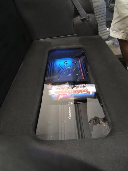

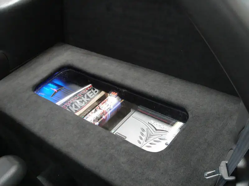

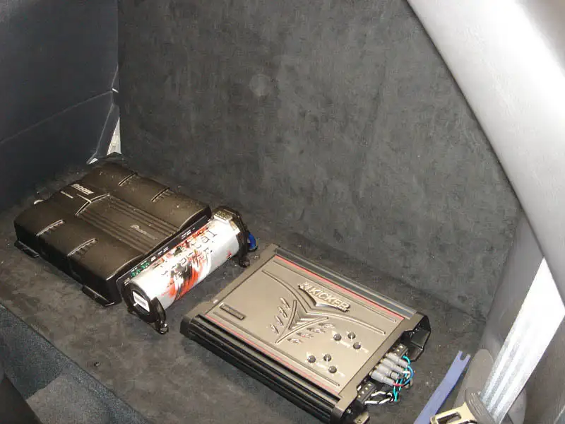

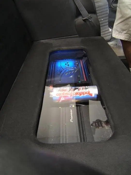

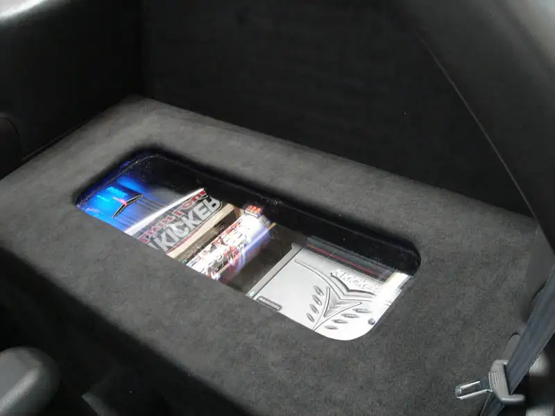

okay imma have to whore out my stereo again lol.
anyways, i just replaced the backseat with stereo equipment so no one can sit back there and lower the car even further into side skirt scraping land.
for what I did, i have a mono amp for the subwoofer, a 4 channel amp for all speakers in the car and a capacitor connected to both amps to provide extra power and decrease strain on the electrical system.
I also have a turbo-timer (not necessarily for turbo) since it can display voltages in real-time to see if my electrical system is getting strained/worn out (placed above the head unit)
suede-covered wooden boards get placed in
suede-covered wooden box around the stereo equipment
added blue lights under the box for extra bling factor

I can't see mounting the amps in the open like that. Thats just asking to get broken into. I suggest if you dont like the install kits for the Mustang, as most are really junk, get a double din. They fit perfectly with no fab work at all. I just put one in my car. An Eclispe unit with a removable TOMTOM built in, literally docks to the face of the unit, full IPOD control reads instantly and finds songs really fast, Sat radio and bluetooth hands free built in. It also has a front USB port for a thumb drive.
is that a direct swap? cause i know on my 94 it had to screw in, not snap in like my 04. i hate the dash kit with the fiery passion of a thousand burning suns! it looks cheap, it feels cheap and i dont have that sweet pocket under my deck anymore. although i only want it until i can afford a double din deck with a sweet screen
where did you get yours and how much?
pretty much a direct swap, and if you get a 99-01 the colors will match up. 94-98 the colors are a bit different but they can be easily painted
it was pretty cheap, i dont remember if i got it off ebay or corral
