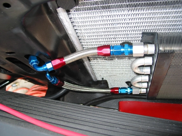

Besides all the points other people have brought up, what's screws onto those trans coolers, like a 5/16" line?
I'm sure the sizes varied over the years and the different engine/tranny combos but I have seen them even smaller than that.
EDIT: Regarding whether it is a good idea for an external cooler or not...I have heard over and over that for every 10 degrees that you can lower your ATF temperature you can double the life of the transmission. I don't know if that is true or a marketing thing, but if it is true i cannot think of why a $40 cooler would not be worth it.
