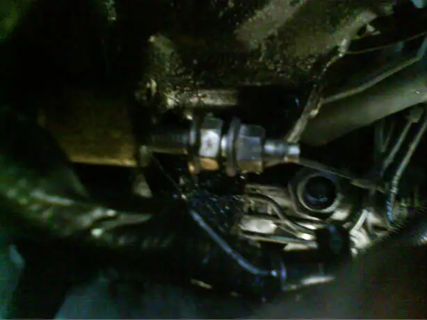

FYI, I used the "Ernan" method for the oil pressure senders today and it worked great. I did not have to remove any accesories, I just jacked the car up and worked from both underneath and from the top.
I could not find my digi cam so I snapped some cheap cell phone pics.

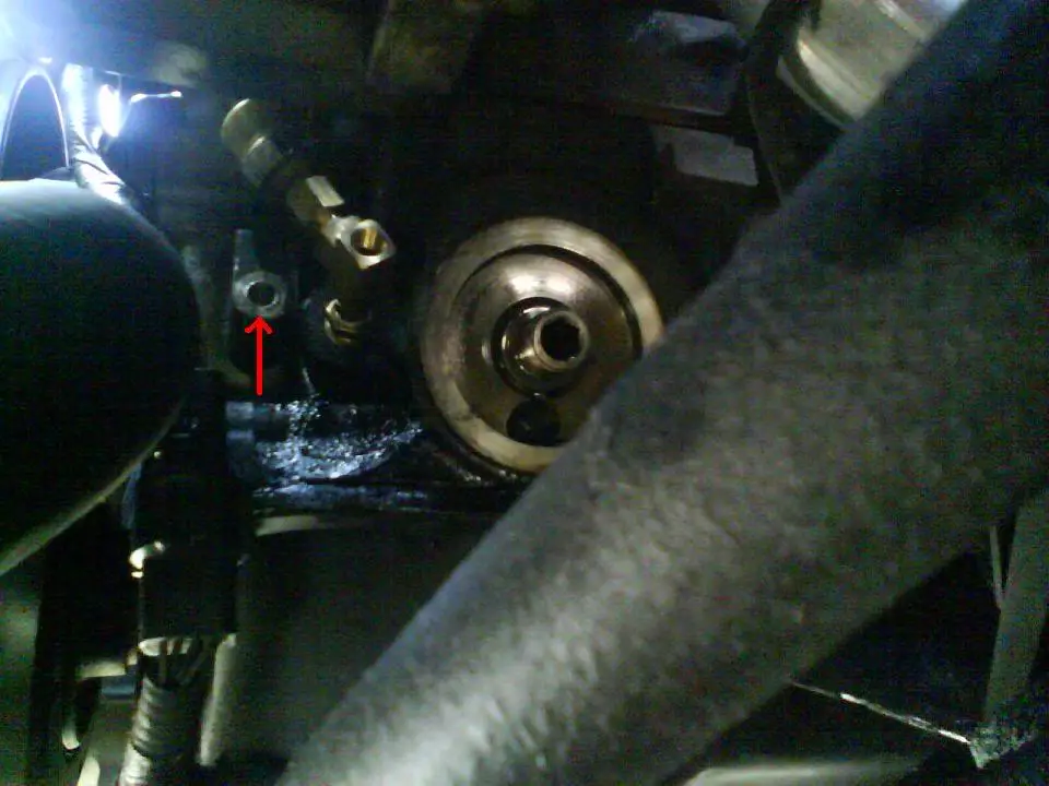

Getting this ground and stud out of the way will help with getting a wrench in from the top to remove the stock sender.
Here you can get a better look at where that stud would be (red arrow) You can also see the position of the stock sender.

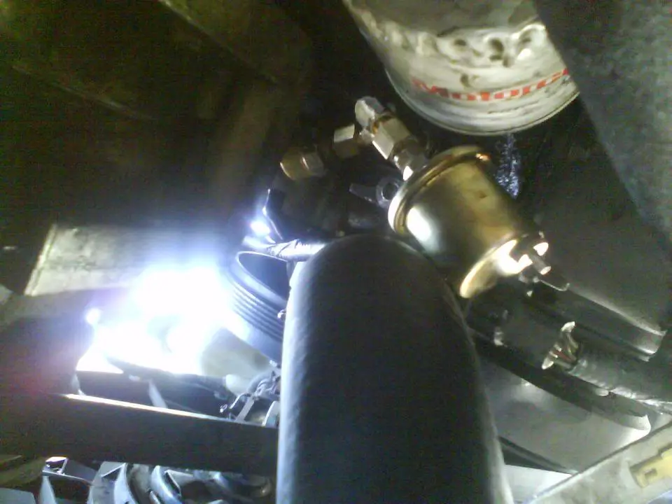

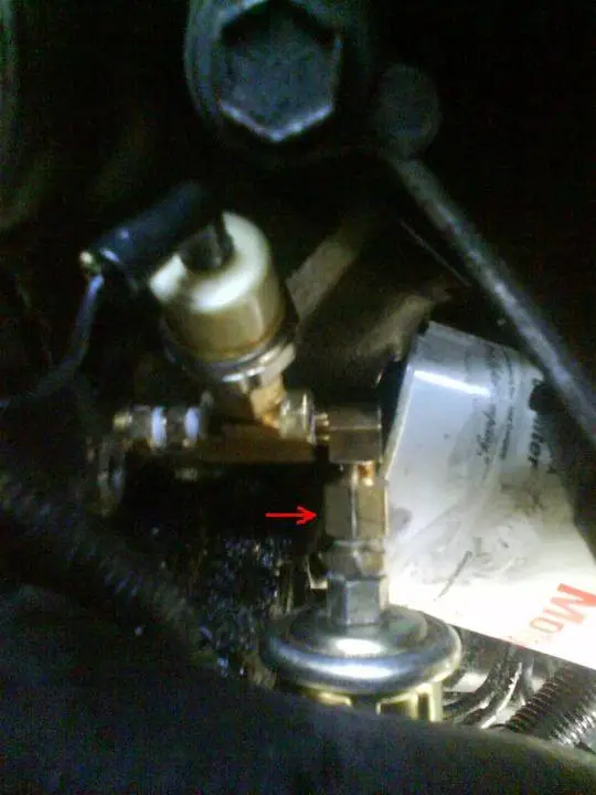

My Autometer OP sending unit had the 1/4 adapter stuck on it, so I had to used an additional 1/4female x 1/8 male coupling (red arrow). In the end, this helped it clear the oil filter.
from below
