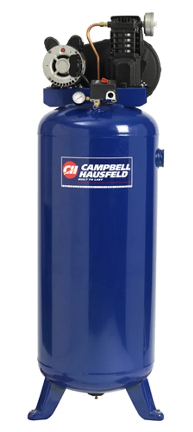

Good friend of mine does a lot of side jobs in his garage-he bought a Campbell Hausfield 60 gallon new (scratch and dent.) from a peddlers mall for $500 lol. Had no issues with it and it maintains air well.
Looks a lot like that one ^^^

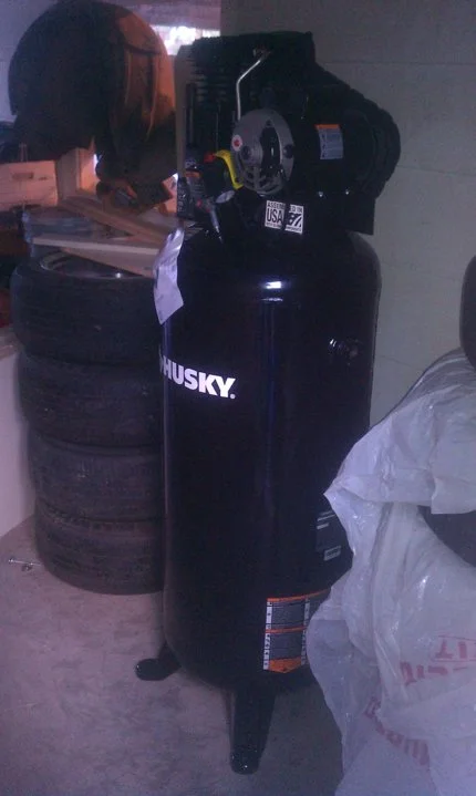

This is my Husky before I started running all the piping. Just have to clean the air filter on it and change the oil from time to time. 50% duty cycle which is not a problem because the running time to keep the tank full is very short.
Husky
Model C602H
Internet #205389936
Store SKU #911625
60 Gal. Stationary Electric Air Compressor
Price $489
