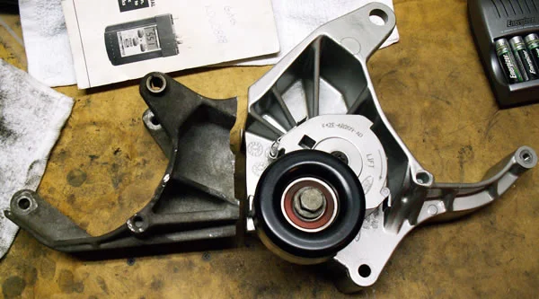

If you know for sure you'll never put a super charger on the car or need to relocate any accessories, you can also cut your smog bracket off.

what did you use to cut that??
it seems like a real thick bracket and i dont think that my tiny lil jigsaw is going thru there
any NICE looking brackets for our cars???

Cleaning them up a tad by knocking down the casting marks and getting them powdercoated works wonders.
