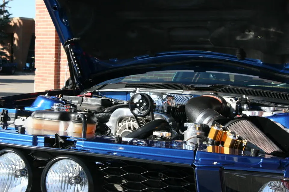

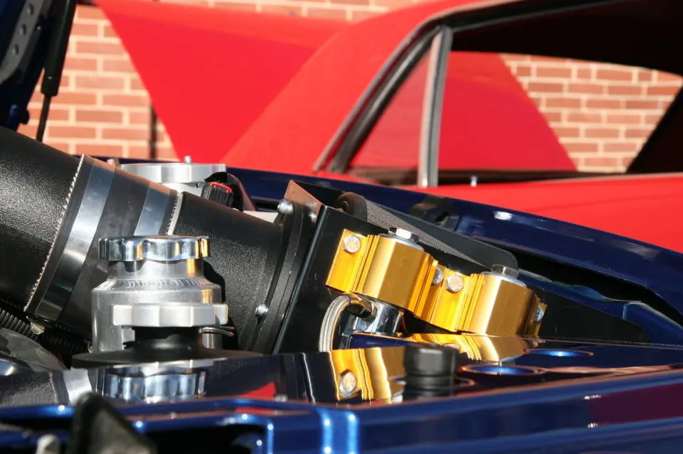

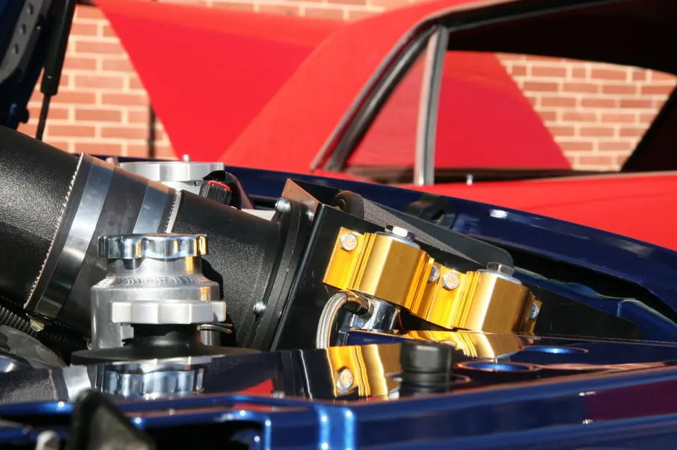

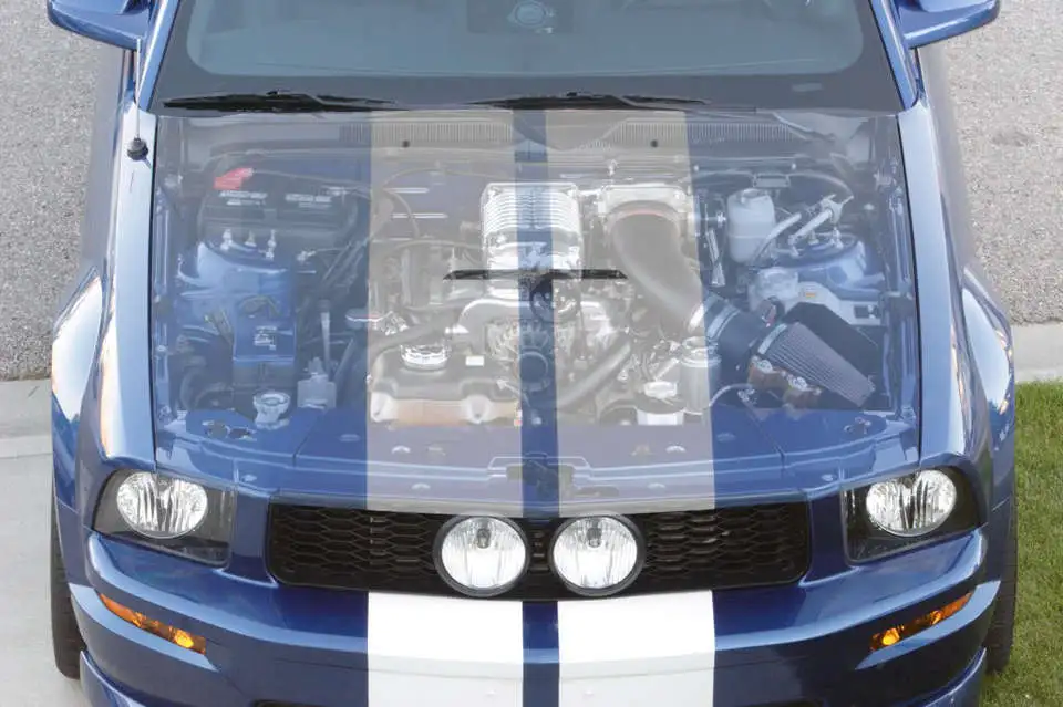

Mine's a Moroso can. I custom fab'd an aluminum Z bracket that is welded to the base of the can and then bolted through the base of the CAI housing. It's connected with SS braided lines. You can see the can in the following pics just to the left of my line lock solenoids.

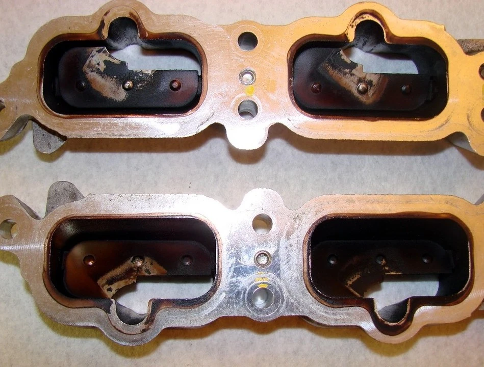

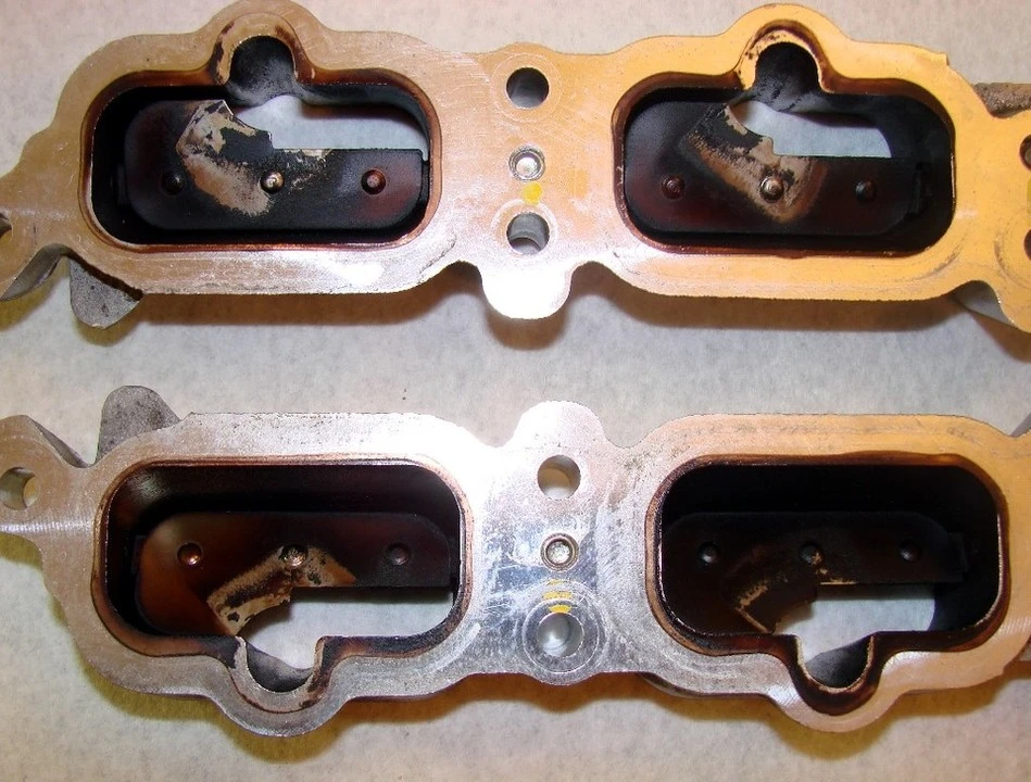

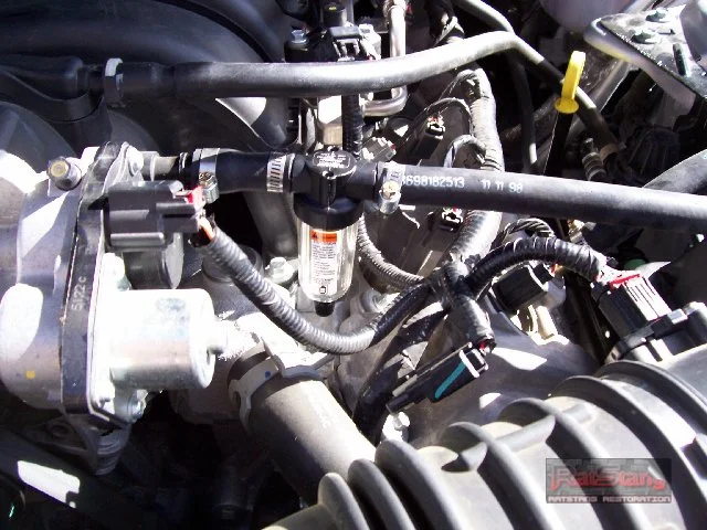

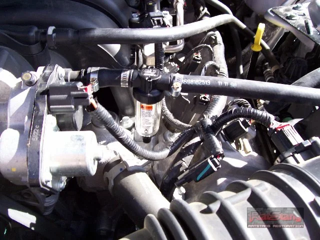

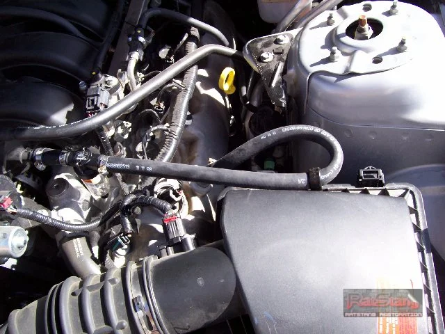

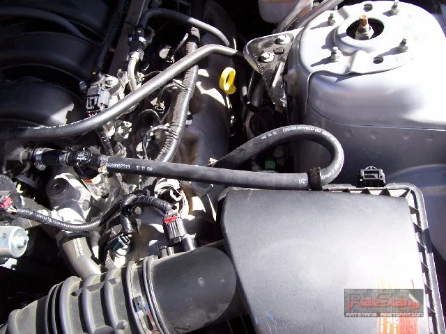

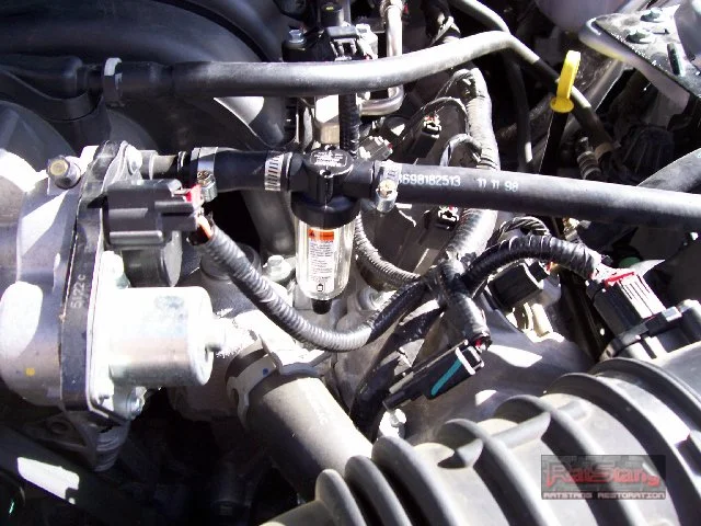

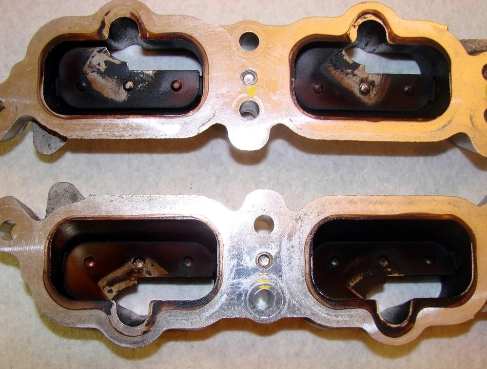

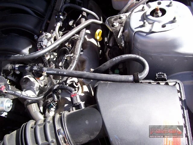

I have a N/A set up, but found alot of oil buildup in the throttle body.
So I removed the drivers side crankcase vent tube, that leads directly into the intake manifold, and plugged the manifold side, and stuck a small crome air filter on the valve cover port. Thus the drivers side vents blowby out through the air filter. The passenger side, I cut the tube between the PCV valve and the throttle body and inserted a simple water seperator in the line. It was a low cost way of keeping oil from gumming/building up the throttle body, and totally stoped oil from entering the intake manifold, thus lowering the air/fuel mix octane.:nice:
Sorry I dont have any photos, and this fix is NOT emissions legal.:nono:

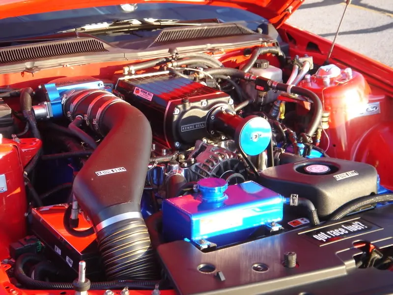

i have breathers on both sides, i used to have a catch can for the driver's side. i like the breathers better, but get some blow by on the passenger side valve cover, none on the driver side. i'm gonna add a oil cap breather to see if it helps relieve the pressure going out to the valve cover on the passenger side.
