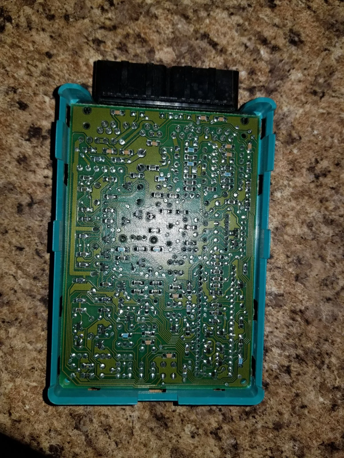

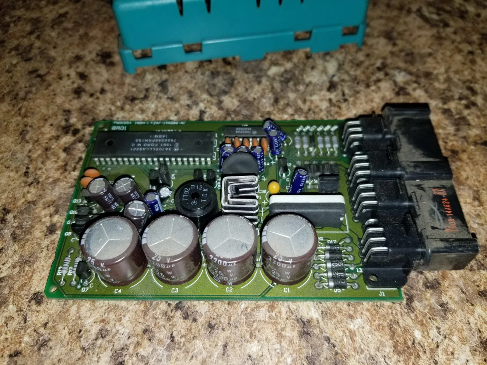

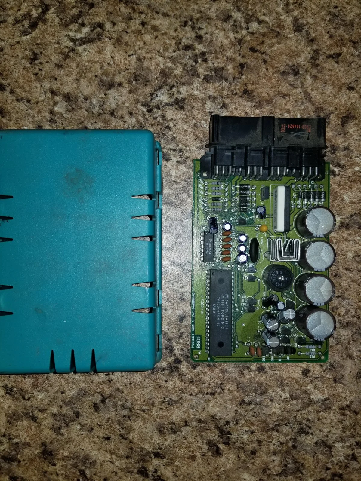

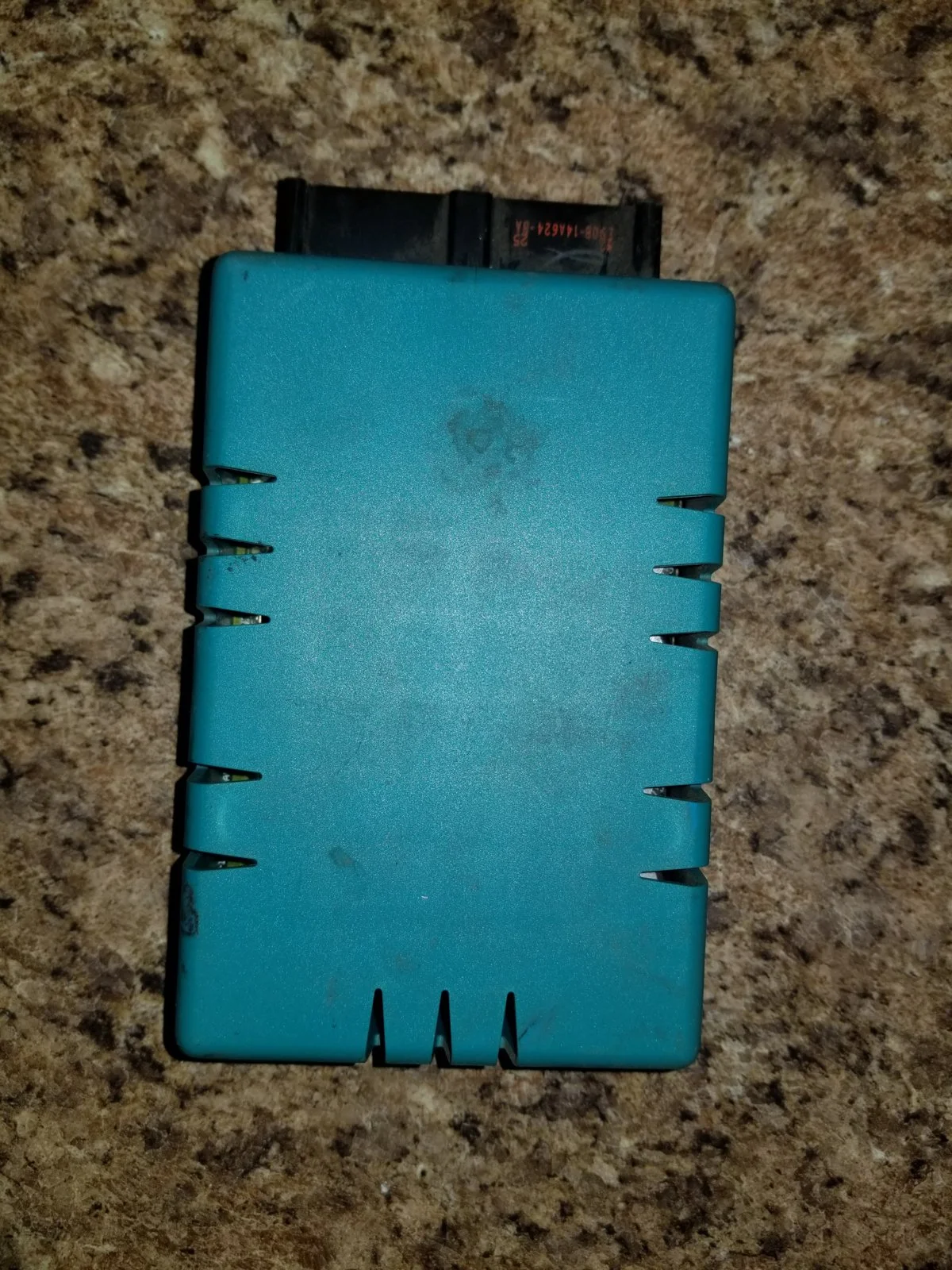

See attached photos.

I might pull the gauge cluster out and see if the airbag bulb is there or burnt out.
If you have an aftermarket cluster the air bag light is gone . It’s part of the factory cluster printed circuit board . Just unplug the blue air bag module and that’s it . Beeping will stop . System is disabled and no worries .
